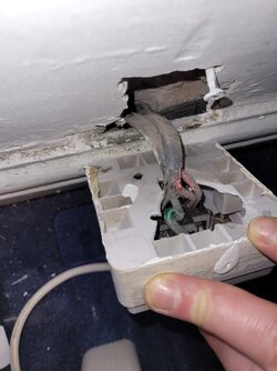

Kevin here. Hoping I can ask a question please. Home DIY'er with no official electrical training. Extent of diy electrics undertaken to date all very basic; plug changes, socket replacements, light switches replacements, bathroom extraction fan transformer replacement. Always without fail turn off all power supply at the consumer unit before doing anything, no chances taken.
I have a bedroom with only one single wall mounted socket in it and would like to add one or two double sockets to the room in the alcove opposite.
I have first checked and when I turn off the "upstairs sockets" at the consumer unit the socket becomes dead along with all other sockets on the first and (relatively newly converted) loft level.
I have had a look at the single socket in question and it has two sets of wires running to it (see pics).
In order to try and figure out where in the circuit this socket is I disconnected one set of wires. This led to all of the upstairs sockets going off except for the socket in question. I then reconnected it.
I then disconnected the other set of wires and this led to all the upstairs sockets going off including the socket in question. I then reconnected.
Finally I disconnected both sets of wires and all the upstairs sockets were off.
What I am trying to figure out is where this socket is i.e. part of the upstairs sockets ringmain and therefore whether I would be ok running a spur from it in order to add a double socket (or two with the use of an additional fuse) to the room.

From the description, it sounds like the circuit is not a ring.
What is the circuit breaker protecting the circuit (32A, 16A, etc)?
And does the circuit have RCD protection?

Assuming the circuit is the "Upstairs Sockets" on the B20 MCB (and has RCD protection), then this appears to be a radial circuit - not a ring final circuit - and can have additional sockets added as a branch (or branches), e.g. from the bedroom socket you mention.
There are other things to consider when extending the circuit, such as complying with Part P of the building regs (e.g. cables in safe zones in walls, any holes in joists in the allowed part of the span). Plus the new sockets need testing to ensure they comply with regs - and are safe (not just adding to the circuit and hoping for the best) - which a competent electrician should be able to do.
