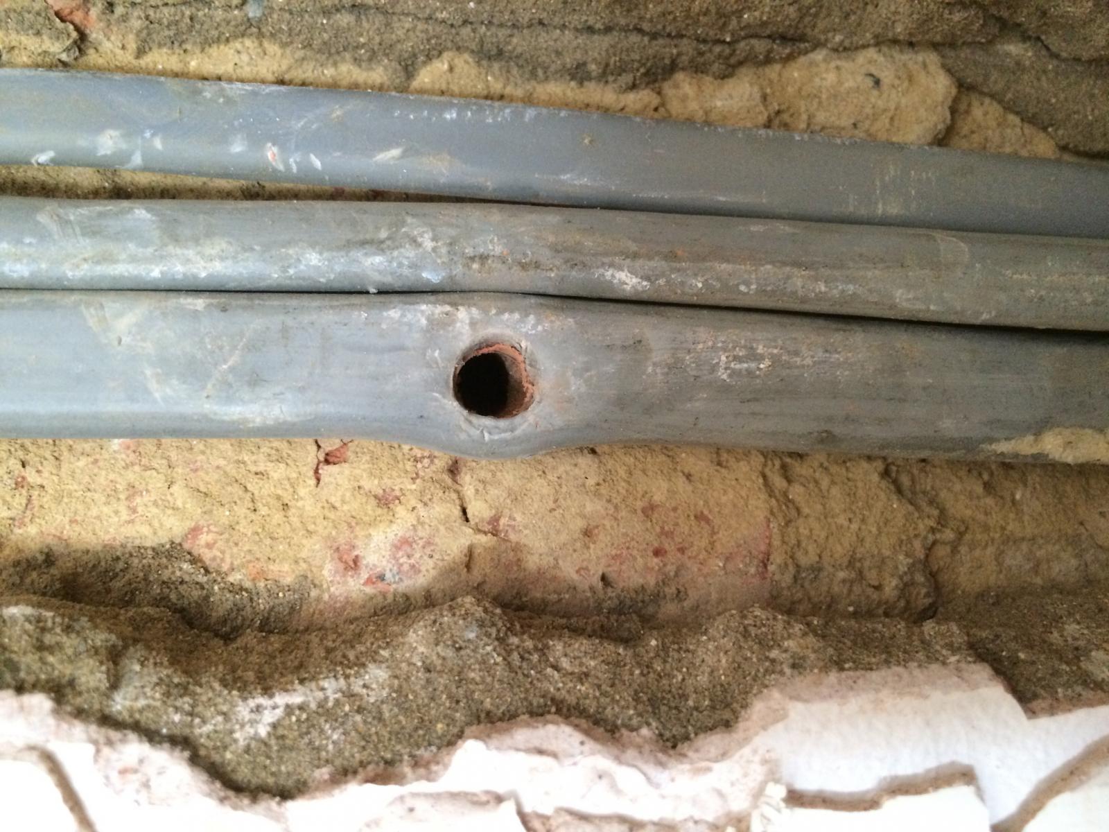

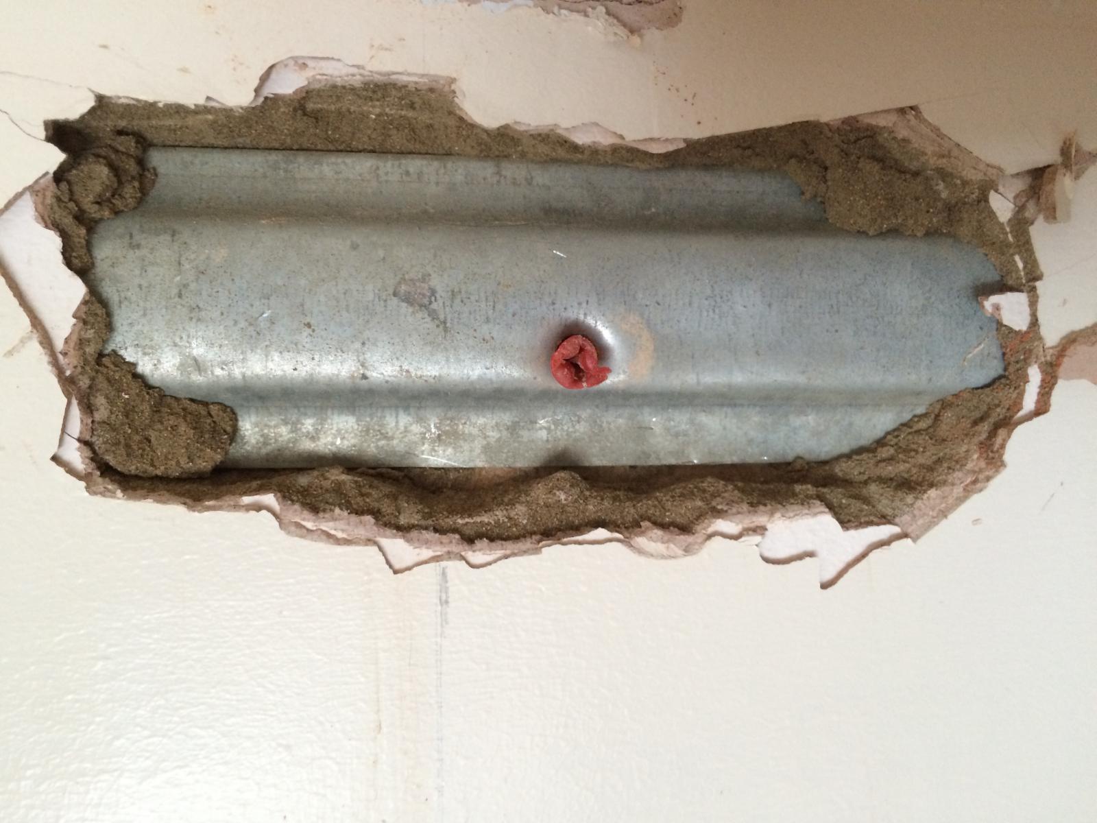

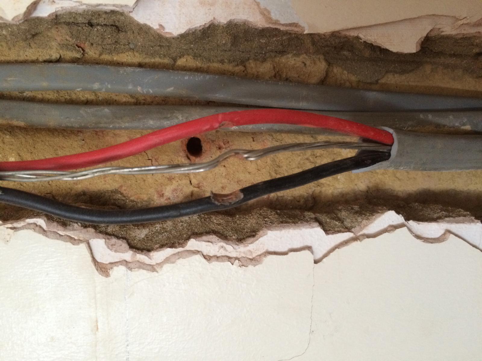

Everything seems ok, thats good then, walk round the house, switch lights on upstairs so see if they all work as expected, yep, all fine, all fine downstairs, but when it comes to the hall light (not stair light) i turn it on and it trips both RCD's? hmm thats odd. Take the bulb out and its fine.
So i put my meter on it on line neutral and earth, 230 L-N, 230 L-E, 0 N-E, ok so I would imagine the bulb would work.., put it in switch it on again and it trips both.
Anyway, I narrowed it down, it appears there is a link between the socket circuit and that light fitting.
That light fitting is definately on the light circuit.
I even then tested N-E from the socket circuit, so see if theres any reading (dead) at the light, nothing, I tried all combinations, I get zero voltage at the light fitting when the light is off and also when the light MCB is off.
So somewhere, and for some reason that particular light is connected, but cannot seem to do any tests that suggest it is.

Anyway, so resolve it until monday, I just moved the lights over to the same RCD as the sockets, then on monday will look at it as have got to pull the floor up to add more sockets in anyway.

my guess would be that someone has fitted an outside light, possibly from hall light switch, and found that there was no neutral at the switch, so pinched one from the easiest point, maybe a socket.
There are no outside lights, and only one socket in each room upstairs and minimal downstairs, none at all in the hall way.
I just cannot understand it, but the main thing that is different about that light, there is two cables in the switch, a twin and earth, one of which is cut off and only one conductor being used, and the other is a single, these are both red, and the one thats cut is red. And at the light fitting, there's only one cable, black and red...
Above the ceiling there will be a joint at a guess.
Its just chance that I even have this problem as I may not have ever known if I had put them both on the same RCD to start with, I can't really think of a way to get around avoiding this as I have tried everything I can think off.
maybe trhat dissed wire was L feed to some wall lights, since removed, but their N came from another circuit and is still connected?

It does sound very odd! If it was a borrowed neutral with that socket circuit then why does the light still work when that socket circuit is disconnected at the CU? Sorry to state the obvious Tom, but when you say disconnected, you did mean the neutral as well?
Perhaps that light is connected to both the neutral of that lighting circuit AND the socket circuit, hence the tripping, but working once the sockets are disconnected!!
You MUST update us Tom.. I cant stand it when we dont get to hear the end of the story. :smile5:
I would drop one of the legs of the ring out at the board and split the legs on a socket at roughly midway point and repeat the process on the sockets until I found what leg the borrowed neutral is connected to.
