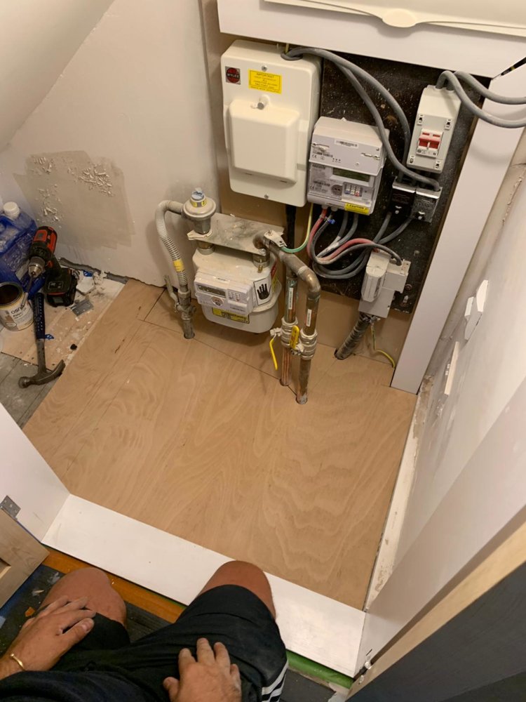

Now I would have left it and not thought anything of it, however we have two CU. One in our outhouse and one in the main house.
What gave me a strange feeling was, as I went round to set the clock on the oven, microwave, I made my way to the outhouse, where I have some computer equipment running. I thought I would have to turn them on etc.. However I was surprised that these were still running - so I checked the "uptime" and they all said 32days (which was last time I rebooted those machines). So basically the Outhouse didn't lose power.
So it couldn't have been anything external which caused the power loss.

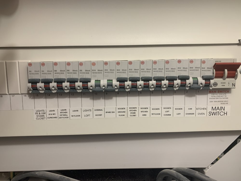

Can you post a photo or 2 of your consumer unit, showing the main switch that you switched off/on?
I’ve attached one, I’ll take another one once I am home.
[automerge]1577369826[/automerge]
Is it a switch or an RCD?
100amp isolator switch
the rest are all RCBO’s

Why does the second supply “have” to be through the first supply.
when this was being installed the guy asked me if I wanted it separate so that neither affected each other etc... as you can see it’s split from the meter properly with two extra isolators. It was all installed by a certified installer and approved by building control.
my question wasn’t why the second didn’t turn off - that makes sense if it wasn’t an external issue, my question is why did the primary go off with nothing tripping.
Some switches switch off and don't appear to be in the off position. In order to re-energised the circuit you would have to switch right off then on which would reset the switch. That seems the most likely explanation. Which switch did you switch off. I hardly need to ask as if you had switched off the main isolator then your computers would have gone off so it must have been the wylex switch. So when certain switches go off they only look as if they are not fully up rather than fully down and as said you would have to pull them right down to reset. Did you feel the switch was a bit loosed when you switched it off?
EDIT: just seen you lates post above so maybe then....
I switch off/on the main isolator inside the consumer unit, not the ones you can see in the picture. I’ll send a better picture
but what your saying does make it the most likely thing that happen, I didn’t know that main switches could trip
It doesn't.

There's a supply fault....The switch you're messing with or something else prior to the CBs.... OR at that separate isolator. Heat does strange things, especially to copper it seems.....check for any....or signs of.
when it happened I did check to see if cables were loose, nothing seemed loose and as I said it’s been working fine for a while.
If the main isolator in the CU did trip what would cause it to trip? And why didn’t the isolator before it trip.
from the main supply I have an isolator, then the tails go from there to the main CU, but even though nothing tripped I only flicked the isolator in the CU. So my question now is, what causes an isolator to trip, and why didn’t the isolator prior not trip also?
