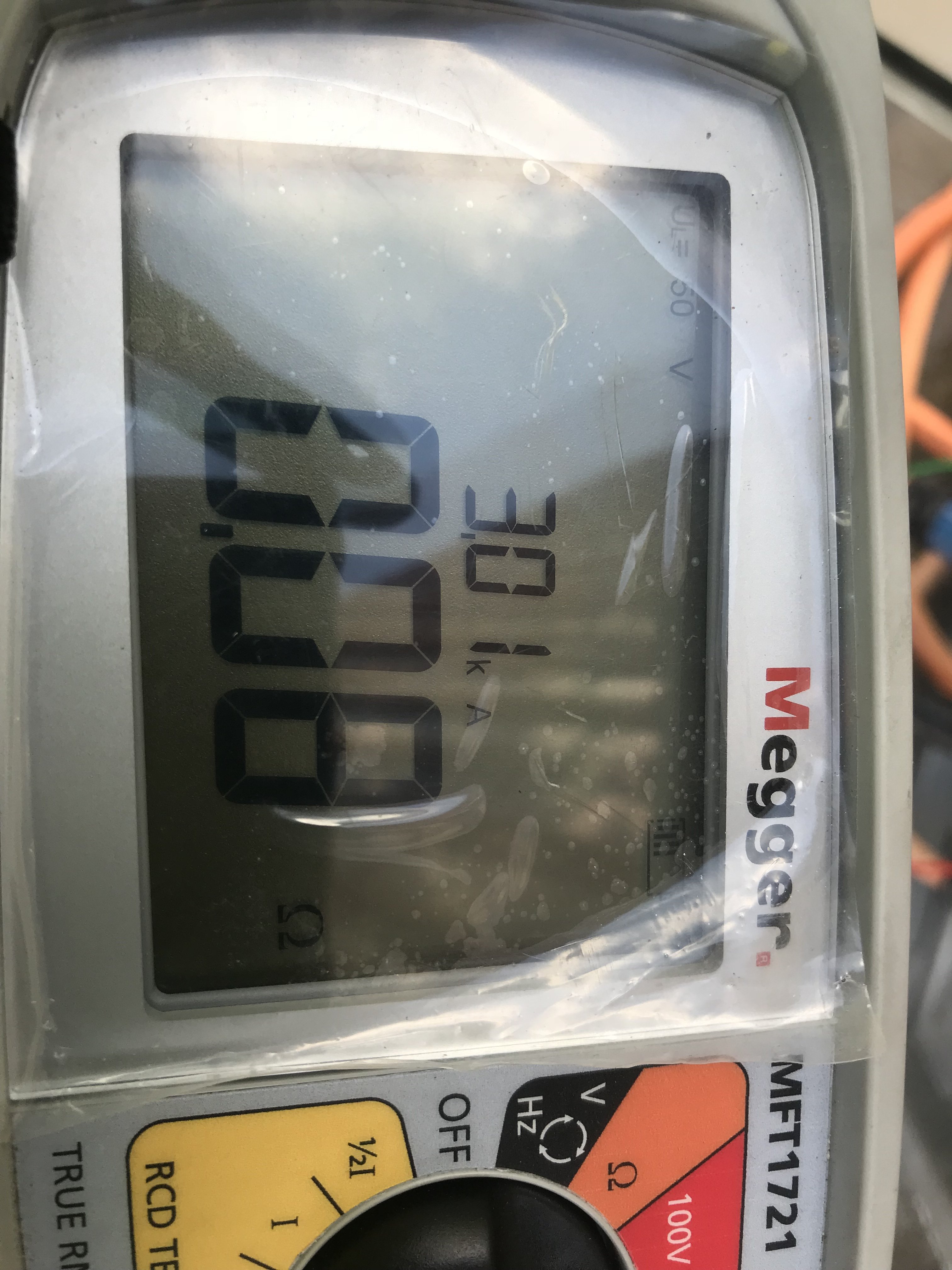

The generator when tested produced a fault current of 2.8Ka

Is that the actual measured current under fault conditions? Or is that the fault current given by a test meter after a Zs test?

That is the value given after doing a test with a meter.

On a generator that value is not much use, that meter calculates the value it doesn’t measure it. It doesn’t take in to account any of the characteristics of the alternator or the engine.
