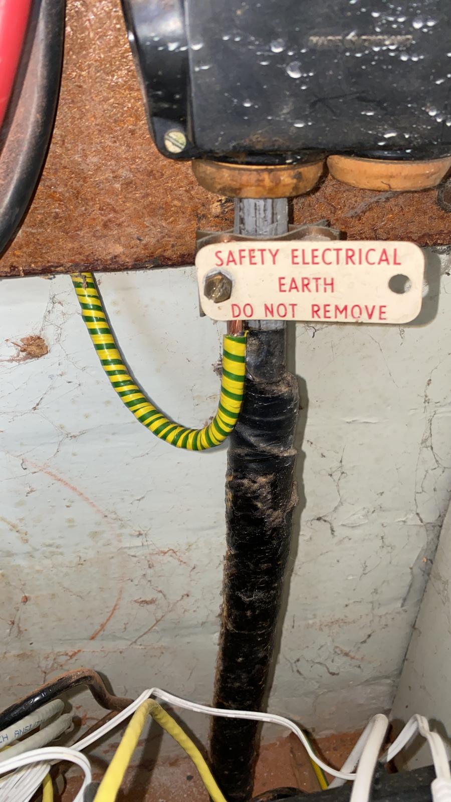

Hi, a customers earthing arrangement in TN-S. Main earthing conductor 6mm and clamped (loosely) onto outside of supply cable.
Having spoken to DNO regarding this they email me saying they will send someone to see if PME is available. The email states PME is the ONLY way they provide an earth connection to their network. If its not available it is up to the electrician to sort out.
DNO came out today. Tightened the clamp and changed to 16mm conductor. No PME label. So what am I left with? Its definitely a TN s cutout.
As an aside, the email had the interesting sentence "as the property owner, there are various types of earthing you can choose for you home"

Sorry, I wasn't doubting it was TN-S, just questioning why the DNO told me they only provide PME, but then came and changed the size of the earthing conductor on this supply.
They only provide PME.......but they repair/improve TNS.
Whichever's the easier, I suppose.

as for your original post. I agree it’s a bit strange that they said what they said considering they came out and contradicted this and actually sorted the TN-S loose clamp.
DNOs a law unto them selves.

Thanks, I was questioning my understanding thats all. And I love the idea that homeowners can choose from a variety of earthing systems!!! (I suppose in theory you could 'choose' TT)
