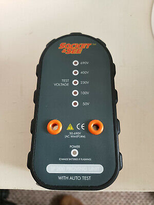

Just a decent proving unit for your voltage tester is £100+!
