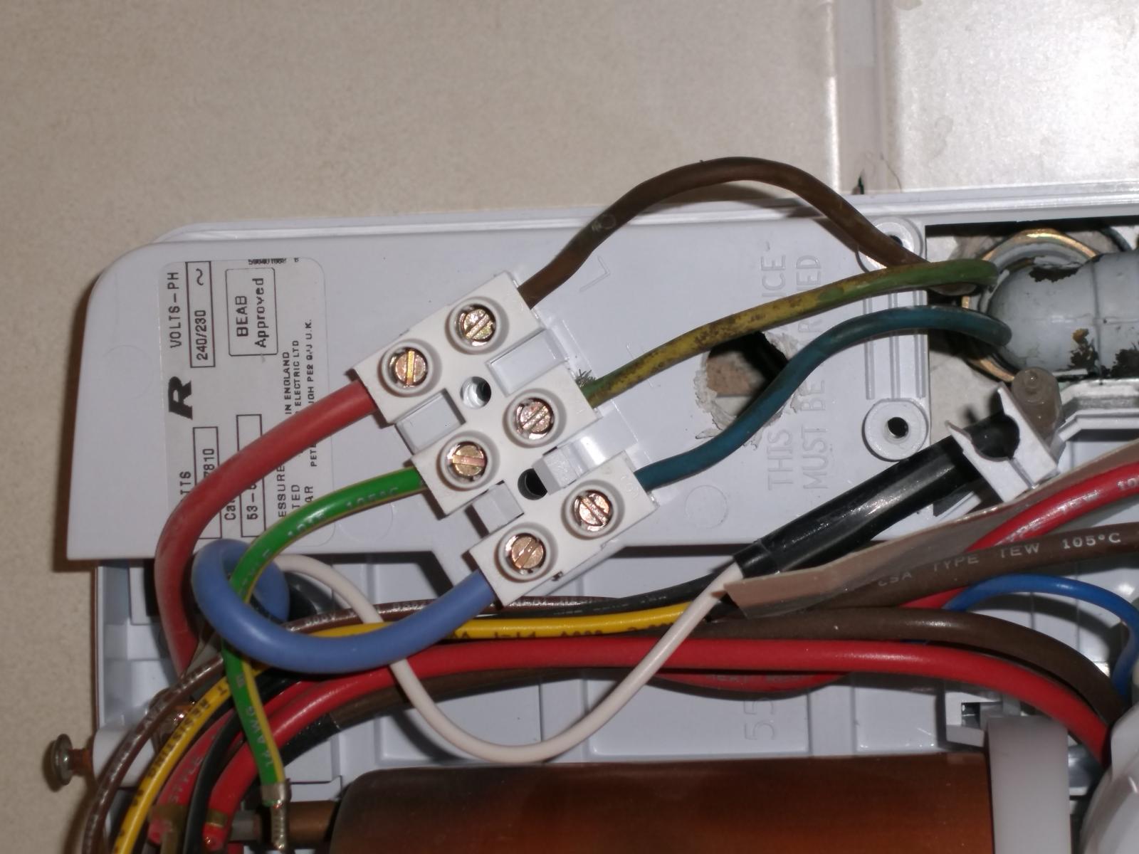

GEDC4127.jpgHere one i found im sure i put this one up not looked round the house was a friends changed the CDU and when testing i spotted the shower but no circuit in the board for it , was wired off the ring main using terminal block under the floor ,its 1.5 3 core flex and im lead to belive it was installed last january by the local handy man !!!!!!!!!!
oh dear, he's omitted to fit the cable clamp . tut tut.
