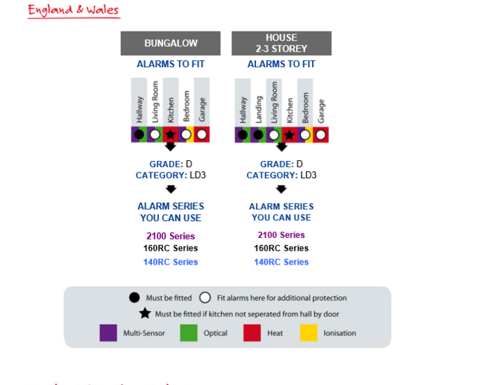

http://www.aico.co.uk/What-do-I-fit.html
You should clarify this if it is a domestic premises as not only is L3 non-domestic, but in fact all of BS 5839-1 is non-domestic.
BS 5839-6 is domestic. As stated the categories are LD rather than L in Part 6 to signify that they are for dwellings.

LD3 is perfectly compliant for standard domestic installs. I have fitted LD1 in domestic situations where the builder made a drastic mistake.
Not a very clear spec and not a lot of information on the building use and layout
I'm thinking if the building is flats with communal areas then system is intended to be to BS5839 part 1 because of number of floors or other factors. Without a proper fire risk assessment in place it would be silly to make any assumptions without seeking further clarification from the client
thanks for info everyone.
I think the schedule of works info is wrong imho as its tiny 1 bed domestic bungalows. I have a detailed electrical drawing and this shows 1 heat and 1 smoke in each.
I was just unsure of the L3 reference. I'll clarify this with client tomorrow.
many thanks
Fire alarms in dwellings - IET Electrical
I didn't say it wasn't. I said that L3 is not a domestic fire detection and alarm system. LD3 and L3 are not the same thing.
Incidentally, it is overly simplistic to state that LD3 is acceptable. In Ireland - both north and south - a minimum of LD2 is required. Scotland may also be similar.
