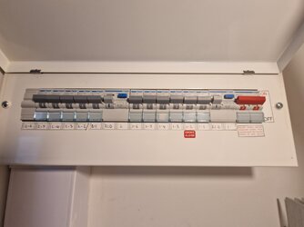

Greetings, I have a solar 5kw system installed with a hybrid inverter (no batteries yet). My electrician decided to add an extension board for the solar installation as my main CU couldn't fit all the required switch due to lack of space.
I have dual rcd consumer unit with no high integrity so both neutral bars are under RCD. I have read that is not recommended to have the inverter on a shared RCD. And I have noticed that when the inverter starts up in the morning + my roomba starts it causes the RCD to trip. Both are on the same RCD.
I would like to have my board replaced with RCBOs since I've read thats the best way these days as you can manage each circut separately. My concern/question is this. My electrician never quoted me on replacing the fuses with RCBOs and I don't know why the put it in a shared RCD if he knew it's not recommended. Am I expected to pay for the RCBOs or should it be part of the initial quote? I'm worried he's goign to want me to pay for it when he should have checked this before hand.

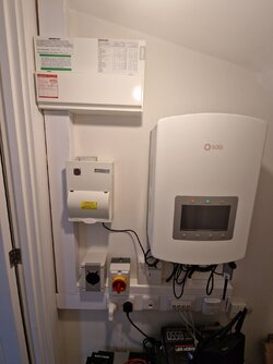

Reading this, I'm a little confused - you mention first an extra board, then later imply not an extra board? Pictures, we like pictures. Post a photo showing everything installed.

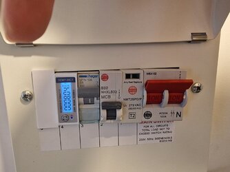

Sorry about that. Here are the pictures. So the small box at the bottom is connected to the main cu at 2-5

Nothing is labelled!
Edit: just noticed the chart on the Wylex cover, but too fuzzy to read.
I'd guess the solar is connected to the small Wylex board, which is turn is fed directly from the meter tails?
Or do you mean the small Wylex boad is fed from one of the Hager MCBs via one of the RCDs?
Also the Wylex board has - for some reason - a Hager MCB fitted - when the regs state not to mix brands like that.
It is not as if a Wylex B6 MCB is can't be picked up off the shelf at any electrical supplier.

There are few problems with your setup. As SJD mention already various brands mcb should not be mixed. No labels on new consumer unit and pv isolators and inverter. Your installer used shared rcd to feed inverter which he should not. Also your rcd is type AC and should be type A or B. Did you get all certification for the job? Did you or electrician request permission from DNO to connect you PV system?
IMHO what he should done is to remove 1x rcd and associated mcb and replace with Rcbo's. This would create additional space and additional consumer unit would not be needed.
As for the tripping you need electrician to run some test to determine weather its down to some appliances or fixed wiring

As kropsake mentions above, there are quite a few issues, and one option would have been to remove one RCD and fit RCBOs for several cricuits, with the remaining circuits on the remaining RCD. Removing the RCD would free up 2 slots.
However, the new Wylex board does include surge protection, which the Hager main board does not. While not mandatory, it would be better if there was surge protection for all the circuits - either in the Hager board or as separate external unit (Hager do such an external surge protection unit, I fitted one a few weeks ago).

The RCD is there to provide additional protection against electric shock. It does this by switching off the power to any circuit downstream of it if it detects an imbalance of current which could be due to a person receiving an electric shock (other faults also cause it to trip). The RCD should trip within 0.3 seconds in order to prevent and electric shock becoming fatal.
Having the solar connected to the downstream side of the RCD means that you have a source of power connected to the downstream side of the RCD.
So if the RCD trips the solar will continue to maintain a live supply to the downstream circuits until the inverter shuts down which can take a few seconds or more.
