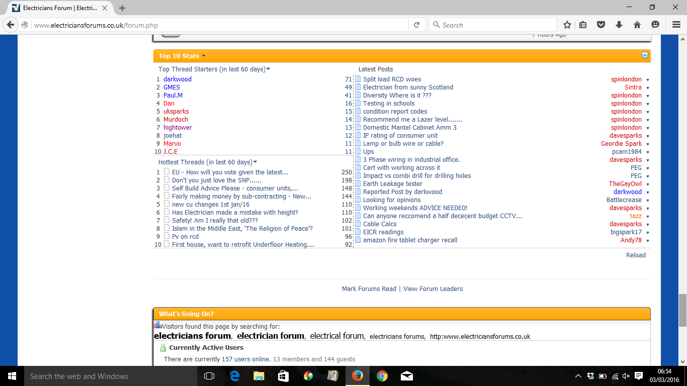

Where's the stats for top thanked poster, and how is Dave the most thanked?
It's at the bottom of the home page and if you click on it it shows all the stats like top thread starter in the last 60 days, top pster, most thanked etc.
I'm off to work now so you're on your own :wink:
