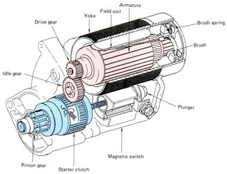

Ive got an old truck 1990 that has always had intermittent starting issues whilst ive owned it.. As far as i am aware the battery is in good working condition.

then, with the known good battery installed i had a helper hold the key in start position and i gave the starter a few light taps and it started up.
i then turned it off and started it back up again a good 20 times with no problems
When i got home i pulled the starter out, all contacts look good, nice and clean with no corrosion.
i pulled everything apart and brushes look good, still have alot of force pushing then onto the communicator.
Ive phoned local parts suppliers and none can source a new starter and have recommended either get one from a scrap yard or have my one rewound.
What is the cause of the starter motor 'sticking'? could a rewind fix this or would the issue be elsewhere?
Ive attached a photo of the kind of starter motor my vehicle has. Ive noticed the alot of starters have the electric motor directly behind the gearset with a solenoid attatched above.
Does this mean my starter doesnt have a solenoid?? i was under the impression from what ive read elsewhere that the solenoid is what 'sticks'

They refer to the solenoid in that diagram as a magnetic switch.
ok i see.
When i gave the starter a tap today and it started afterwards, the part i tapped was the motor itself because the solenoid/magnetic switch sits under it on the truck.
Is there anyway the motor itself can get stuck/ jammed?? i know people always talk about a sticky solenoid, never a sticky electric motor
or would you guess the tap sufficient to make the shock travel down to the solenoid/magnetic switch

I'm still a little confused about the starter solenoid as I don't have a 'normal' starter motor with a direct drive motor and a solenoid on the top.
After a little research it appears I have a gear drive starter with a magnetic switch. Not sure if this can still get 'stuck' like a conventional solenoid?

Sorry i think i may have confused the situation - "relay" is a general term in this context. The starter "relay" nowadays is usually located within the starter motor casing, sometimes it can be remote but the clue is the massive cables that must attach to it. The diagram you posted indicates the "relay" is within the starter motor housing. Other names for this "relay" as used for electric starter applications are: "Solenoid" - "starter switch" - "starter contactor" - the reason for all these differences is that the "relay" may be combined with other functions like operating the starter mechanism.
