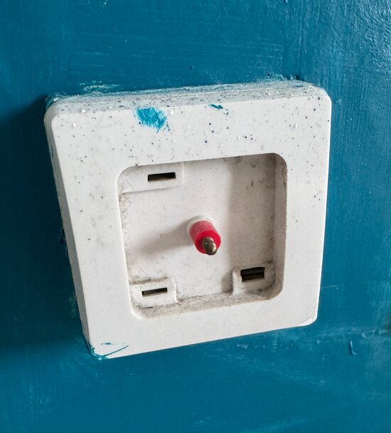

Just been directed here from someone I know for advice. Hoping you can help!
I've just moved in to a new house and there's a strange socket on the wall I can't identify and don't know what to do with!
Just wondered if anyone could tell me what it's for and if I can remove it easliy enough? Seem to be two small wires connected to it from the back. I'm VERY nervous around anything electrical...

It is one of these with the plug missing.

Ah! Thank you! Do you know how I would go around removing it? It's coming away from the wall anyway. Would I just turn the electricity off and cut the wires before taping them closed with electrical tape or is that just incredibly naive?
Don’t just tape up the wires.
Power off, safety first.
Disconnect from plate and put the wires into separate connector blocks. Cover with a one gang blank plate.
If there’s more than one cable going into the plate terminals, then keep the common connections together… ie red to red, black to black etc.
if in doubt, photograph the connections on the back of the plate and upload here for clarification.
Ideally, if the point is unused, you could disconnect the supply cable from wherever it’s fed from… but working that out where that is may be beyond DIY
Reactions: Spoon and DPG
Unfortunately, the OP's socket assembly isn't quite the same as Westward10's link. OP's is a standalone surface mounted version, while Westie's is to fit a standard single gang back box or surface box.
A blanking plate won't fit.
The two choices are to fit a single gang box with a blanking plate, or to disconnect the wiring at its source, which isn't really DIY territory.

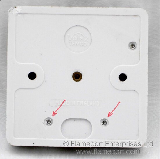

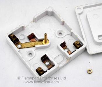

Thanks to John Ward, this is what you see when you take the cover off:
(Article on Volex Temco clock connector)
Turn the power off first!!!
Reactions: DPG and wuntyate
That's exactly what it is!
Yes. Main power is going off (as soon as I find where to do that) before I go anywhere near it...
Reactions: DPG
A very good idea, especially as John Ward points out that (when connected to power) one of the two little rivets on the back (which hold the contacts in place) will be live!
