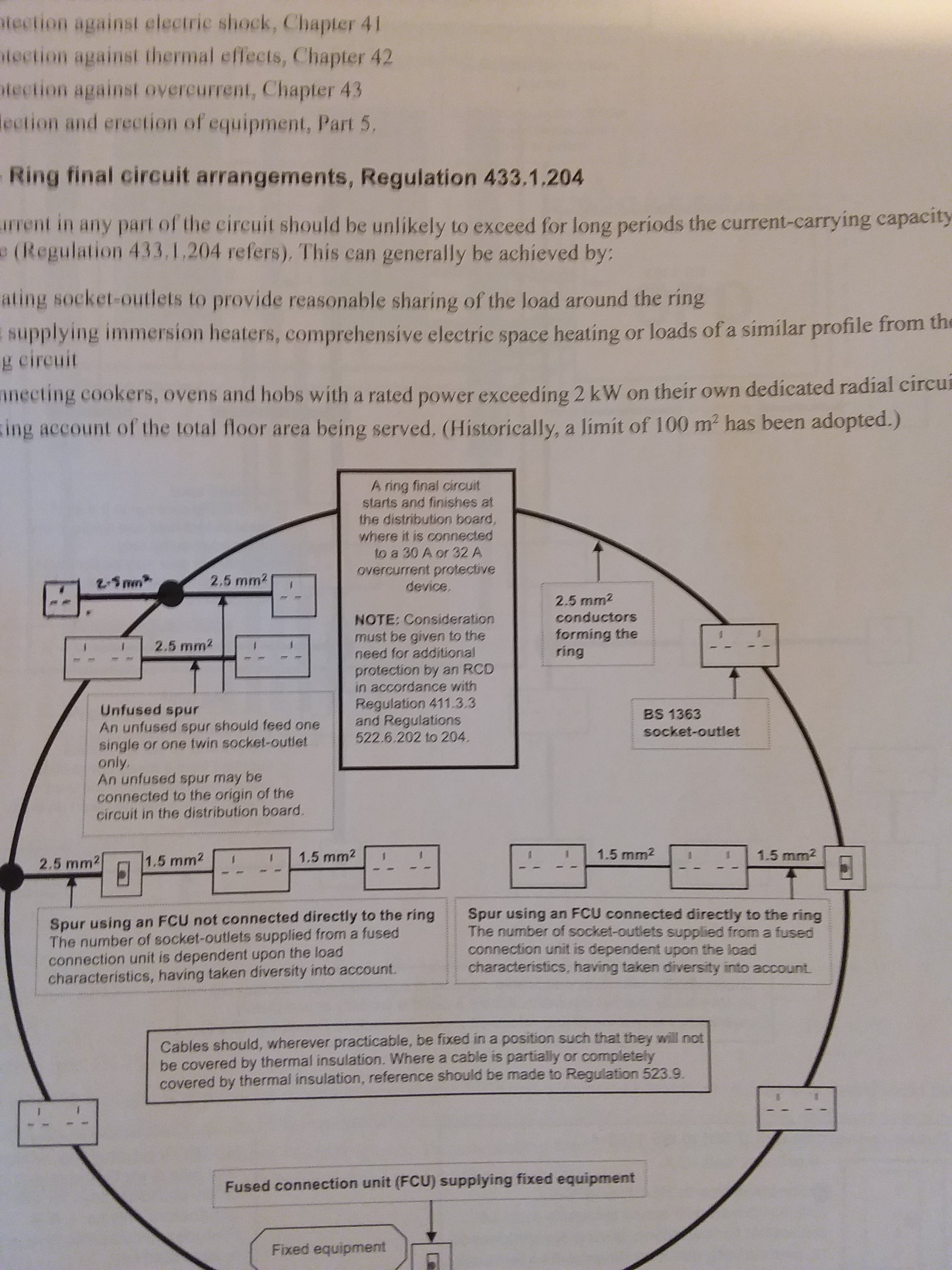

Let me ask the question in another way...
You've just been asked to inspect the OPs property for an EICR and you find this junction box, it's been changed to a maintenance free one so that's no longer an issue.
How would you code the fact there are two spurs taken from the one junction box and what regulation would you quote to substantiate that coding?
C3 not to current standards citing reg 433.1 and mention Appx 15.
I think the wording is quite clear in saying that Appx15 is showing the design options. As in the options on how to spur from a ring rather than the diagram being one of many different options.
Out of interest how would you justify not coding it?

In the course of this thread, I've read 433.1 several times and it makes no mention of junction boxes. It's focus is on cable loadings and ensuring that they are adequately protected against overload through the correct selection of cable size and appropriate OCPD.
Specifically 433.1.204 states the rules for cable sizing for ring finals.
Since these two spurs are designed correctly, i.e. the correct size cable and only one double socket outlet on the end of each, the spurs themselves comply. The ring final itself complies because it is wired in an appropriate cable and protected by an appropriate OCPD.
So the three elements here comply in their own right. Providing the junction box used can handle the expected load (whether or not this is accessible is another discussion), there is no reason that I can see how this arrangement can be deemed to be a non-compliance.
The appendix 15 argument if taken to it's logical conclusion means you can never have a single socket outlet on a ring final, or take a spur from the origin, or have more than two double socket outlets after a fused spur, or have a grid switch system... why? Because they aren't shown on the diagram. The diagram provide guidance on how to comply, it's not a definitive list of what you can do (as it states, the diagram shows options).

At the moment, I couldn't justify a code because I genuinely do not believe it contravenes any of the regulations in 433.1. Hence why I'm asking which regulation it contravenes and why.
I would possibly inspect it and look for signs of thermal damage to the junction box and the cabling that may suggest an overload situation, but the arrangement itself whilst a little unorthodox doesn't appear to breach 433.1 for the reasons I've outlined above.
id still C3 it because it could affect the safety of an installation there may even be an argument for a C2 because it could be potentially dangerous,in the event of an overload
Nooooo! Not the overload argument again!
There is no more risk of overload with what the OP has done, than with two spurs taken from different points on the ring. Subject to the junction box making a sound connection, which is a caveat we've been accepting all along.
I will state categorically that this method is just as safe as any other. The only debate is about whether it technically complies as a configuration, which I think it does.

Ok, but where in 433.1 does it preclude taking two spurs from a single point on a ring final circuit?
That's all I'm asking.
I can't find a regulation that precludes it, but I'm happy to be proved wrong because then I'll have learned something new :)
I'm thinking the same thing. As the OP passed the ring through the JB, then this is 2 separate spurs in a single junction box, not a single spur with 2 twin sockets attached to it.
Both sockets are in effect independently spurred from the RFC by nature of the fact that both are independently connected to it. You could remove either socket and the other would remain connected. So... does that not qualify as 2 spurs, one for each socket?
What is the difference between breaking into the RFC twice in one JB, or once in each of two JBs next to one another? Do the regs say two spurs can't connect back to the RFC within a single enclosure?
At very least, it's not dangerous in anyway that I can see - other than a none MF box technically in an inaccessible location, but that's very easy to remedy.
