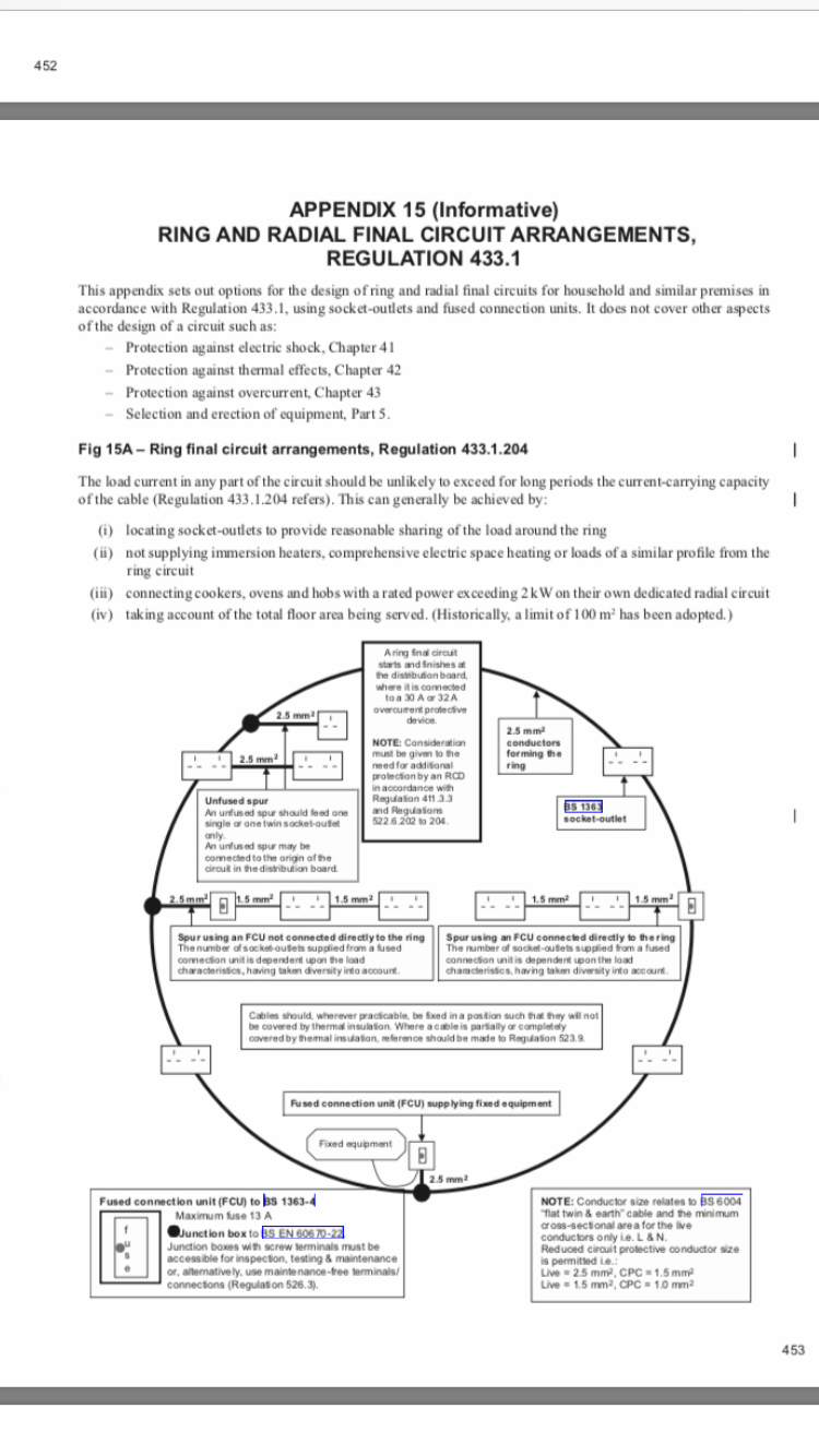

Hi folks.
I cut one of the cables on my ring circuit, attached the 2 now separate ends to a new 30a junction box, and then run 2 additional spurs from the same junction box, using 32a twin and earth, on the end of each of these new spurs is a twin plug socket with usb.
I did the work with my father in law, who’s an avid DIYer and has been doing diy for 60 years.
We did a really good job, cables cut nice, neat, secure, tested them, and all working.
Due to a rush to get the job done before decorators, I pre installed the new sockets and cabling, ready for the junction, and only then did I realise I should have extended the ring.....it was too late, I had sealed the walls up and could not get another cable in. We used a square 30a MK box, which had ample room for the cables.
These are bedside outlets, not for heavy consuming items.
Some forums and people have now put the fear of god in me that this is dangerous, however I have read mixed opinions (e.g. apparatly 1 spur from any point is the Reg, ok.....so I have 2 on mine, but is this really much different than if I added another junction 10 inches away for my second spur)
Is this really a concern to warrant me ripping it all back out?
It’s a good tidy job.
I know there’s regulations and partP......hindsight is a wonderful thing.
Views?
Many thanks.

Having read all the regulation put forth thus far, I can find no reason why two properly formed spurs cannot be fed from a single point on a ring final circuit.
So, lets take a look at what 433.1.204 actually says.
  • Accessories to BS 1363 may be supplied through a ring final circuit, with or without unfused spurs - Unless he's purchased cheap Chinese tat, there is a very good chance that the accessories comply
  • protected by a 30A or 32A protective device complying with BS 88 series, BS 3036, BS EN 60898, BS EN 60947-2 or BS EN 61009-1 (RCBO) - Since the OP doesn't state what type of consumer unit he has, it's a fairly safe assumption the device is going to be a 3036, 60898 or 61009 so is likely to comply
  • The circuit shall be wired with copper conductors having line and neutral conductors with a minimum cross-sectional area of 2.5mm sq except for two-core mineral insulated cables complying with BS EN 60702-1, for which the minimum cross-sectional area is 1.5mm sq - As far as we can tell, the OP has used the right size cable
  • Such circuits are deemed to meet the requirements of regulation 433.1.1 if the current carrying capacity (Iz) of the cable is not less than 20A - 2.5mm T+E passes that requirement, so providing the OP has used 2.5mm it will comply
  • and if under the intended conditions of use, the load current in any part of the circuit is unlikely to exceed for long periods the current-carrying capacity (Iz) of the cable - If one of his double sockets is fully loaded beyond it's maximum capacity (typically 20A for a double socket outlet), the spur cable itself should be OK and if both were fully loaded (potentially overloading the point of connection on the ring), the OCPD for the circuit should trip thus ensuring the CCC is not exceeded for long periods.
So that appears to be the actual regulation that defines a ring final circuit using BS 1363 accessories. Appendix 15 is nothing more than an informative appendix, helpfully provided for those of us unable to follow the complexities of 433.1.204.
No where in the actual regulation does it state how and where you can connect spurs, only the conditions that must be met for the ring final circuit to comply.
So as far as I can see the OPs implementation complies fully with 433.1.204.
Whether or not it is good practice is an entirely different conversation and one that is based on personal experience and views. As I said many times... would I do it, probably not unless I had no other choice. But unless someone can highlight to me how the solution fails to comply with 433.1.204, I'd say the OPs solution is a compliant solution and aside from the choice of junction box he should stop worrying.

On Site Guide page 76 7.2.2 Socket outlets:
The length represents the total cable loop length and does not include any spurs.
A rule of thumb for rings , infused spur length should no exceed 1/8th the cable length from the spur to the furthest point of the ring.
The total number of fused spurs is unlimited, but the number of non fused spurs is no to exceed the total number of socket outlets and items of stationary equipment connected directly to the circuit.
A non fused spur feeds only 1 single or 1 twin socket outlet or 1 permanently connected item of electrical equipment. Such a spur is connected to a circuit at the terminals of socket outlets or at a junction box or at the origin of the circuit in the distribution board.
A fused spur is connected to the circuit through a fused connection unit, the rating of the fuse in the FCU not exceeding that of the cable forming the spur and, in any event not exceeding 13 Amps. The number of socket outlets which may be supplied by a FCU is unlimited.
The circuit is assumed to have a load of 20Amps at the furthest point and the balance to the rating of the protective device evenly distributed (for a 32 Amp device this equates to a load of 26Amps at the furthest point.

Now someone please tell me that both, BS7671 Appendix 15 fig 15A and the OSG, both compiled incidentally by the IET are both wrong.
Yes, I read this section of the OSG last night.
He has two spurs, one double outlet each (compliant), they originate from a junction box (compliant).
It says nothing about the number of spurs that can originate from a socket outlet or junction, only that they should originate from them.
But taking the OSGs guidance it to it's logical conclusion, is it wrong to take a spur from the supply side of an FCU, a SFCU, a 20A DP switch because the OSG doesn't explicitly list them as possible sources for a spur?
The OSG is guidance only, a watered down interpretation of the regulations for quick reference on site.
