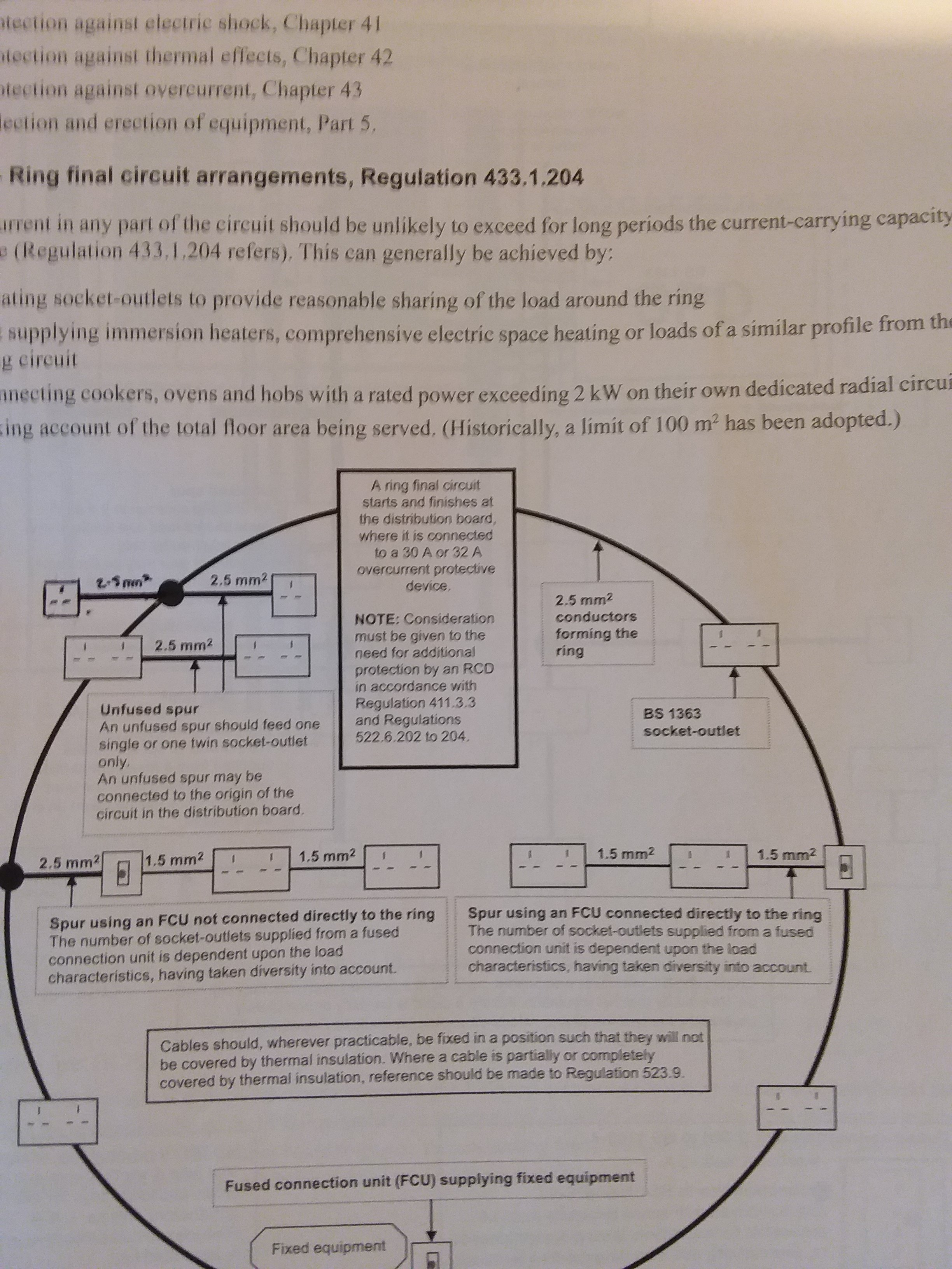

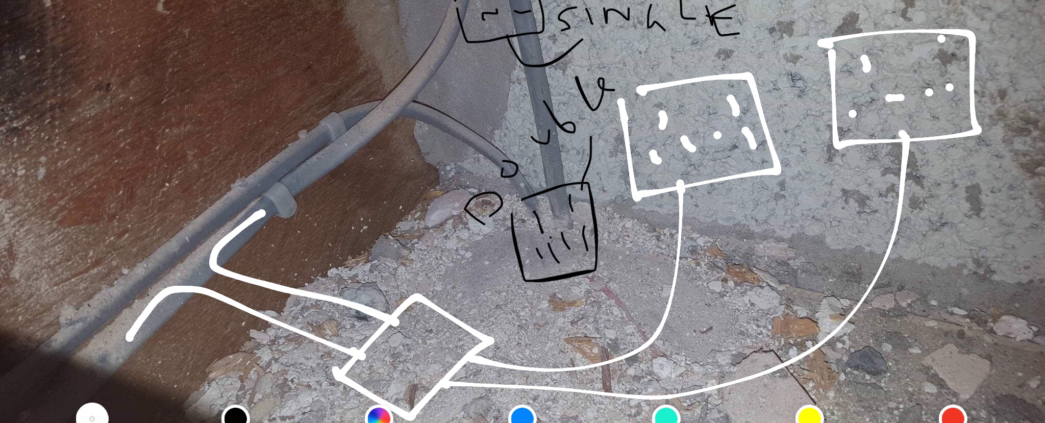

Suppose the junction box is actually a socket outlet in the RFC. You can run one unfused spur from this to feed one point., no doubt about that.
Now, instead of the socket outlet in the ring being in the physical position it is, you 'relocate' the faceplate to a different position using a piece of 2.5mm² cable, leaving the connections where they are. We already know that this type of cable is acceptable to feed one point. We already know that the loading on the RFC from the point of connection is acceptable. Electrically, nothing has changed. So, provided the junction box is adequate for the purpose, the OP's situation is electrically just as safe as a single spur to a socket outlet run from another socket outlet.
Making all new socket outlets part of a fused spur is obviously compliant, but may be materially less safe. The total load that can now be connected is limited to 13A, and if Pete's proposed 2 x 2kW heaters were connected, one to each of the new socket outlets, a prolonged low overload would occur before the fuse failed. During that time, the FCU would be operated beyond its continuous rating, whereas with the double unfused spur nothing would be overloaded in this way.
So IMHO the simple answer of making the addition a fused spur apparently improves compliance while making it less safe. Personally, I think the OP's solution is fine. I agree with SC that it is not in breach of any regs. Connecting a large number of spurs to one point would be unacceptable because too great a fraction of the circuit's total load would be likely to become concentrated at that point. But as I showed above, there is no such redistribution of load at all, when two unfused spurs each serving one point are taken from one junction that is not itself an outlet.

So.. The iet are saying the same, rfc cut on one leg, junction box with both ends of leg connected to 2 length of 2.5mm on to 1 socket on each length. Non compliant.

You know, without conceding to anyone, and the lack of any definitive proof, Regulation numbers etc, the only arguments on this subject we have, are divided between those who agree with what we have as decisive regulatory notifications, i,e, regulation 433.1.204 Appendix 15 Figure 15A, and those who don't agree.
Now I know what I believe to be a true representation of what is right, and I won't waver from that, so please don't bother to argue the point with me.
What has come about from this somewhat heated debate, is one or two members have either contacted their respective C.P.Schemes, the NICEIC in this instance, or the IET directly, both organisations have declared that the issue presented to them by members of the Forum, in their opinion is non compliant with BS7671.
It begins to make you wonder how many other inconclusive issues have been left for us Electrical operatives to debate, argue and form our own conclusions, without any definitive statements published by the IET.

Now back to earlier both the NICEIC and IET have said the issue posed by the OP is non compliant, but seem to be reluctant to provide any proof of non compliance.

Dear oh Dear, the OP has spurred two sockets off one point on the ring, whether it is a socket or a Junction box it is one point, spurring two points from one point on the ring is against the regs, No scheme will accept it because it is not permitted, you can all argue all day long and I won't reply to any replies to this because I know I am right :D
My App15 shows it as being fine:tonguewink:

On the back of this, I contacted NAPIT (my scheme) and put it to them that I had come across this situation during an EICR and had been advised by a more learned friend that it was a non-compliance, but that I was struggling to find a regulation it contravened.
The answer I received went like this "not good practice, but you won't find a regulation it contravenes".
So yes I fundamentally agree with you Pete, a classic case of ambiguity in the regulations leaving us open to the possibility of ending up in hot water (if something goes wrong for example).
It would be very simple to clarify with an additional clause in 433.1.204 that states each junction box/accessory shall be the origin of a single spur.
I think we all agree it's not good practice, but the ambiguity leaves it open.

I've given you a disagree because I was taught never to have more than 3 cables at any connection on a ring or radial
If using a screw junction box, I'd tend to agree due to limited terminal capacity, but with modern jointing methods like Wagos, it's not such a problem.
But regardless, fundamentally (as I've stated so many times I've lost count) I agree... it's not good practice :D

The op could always mark it down as a departure when he signs to say he has designed the circuit.
Then even if appendix 15 is not just guidance, it would not be coded unsatisfactory on an eicr. Not that it would anyway if it didn't affect the safety of the installation, but it's down to the designer to decide.;)

After reading this, and seeing SparkyChick taking on the forum. My opinion is: What you’ve done is bad practice and I would never ever do it like this, and I’ve always been taught that this is wrong. But - hey, it doesn’t appear to be against regs when you scratch beneath the surface.
Talk about a grey area.
OK, there clearly isn't a definitive answer here and it's been debated to the point of extinction, we'll just have to fall into two camps and agree to disagree. Beer o'clock and apologies for perhaps unfair posts regarding DIYers.
