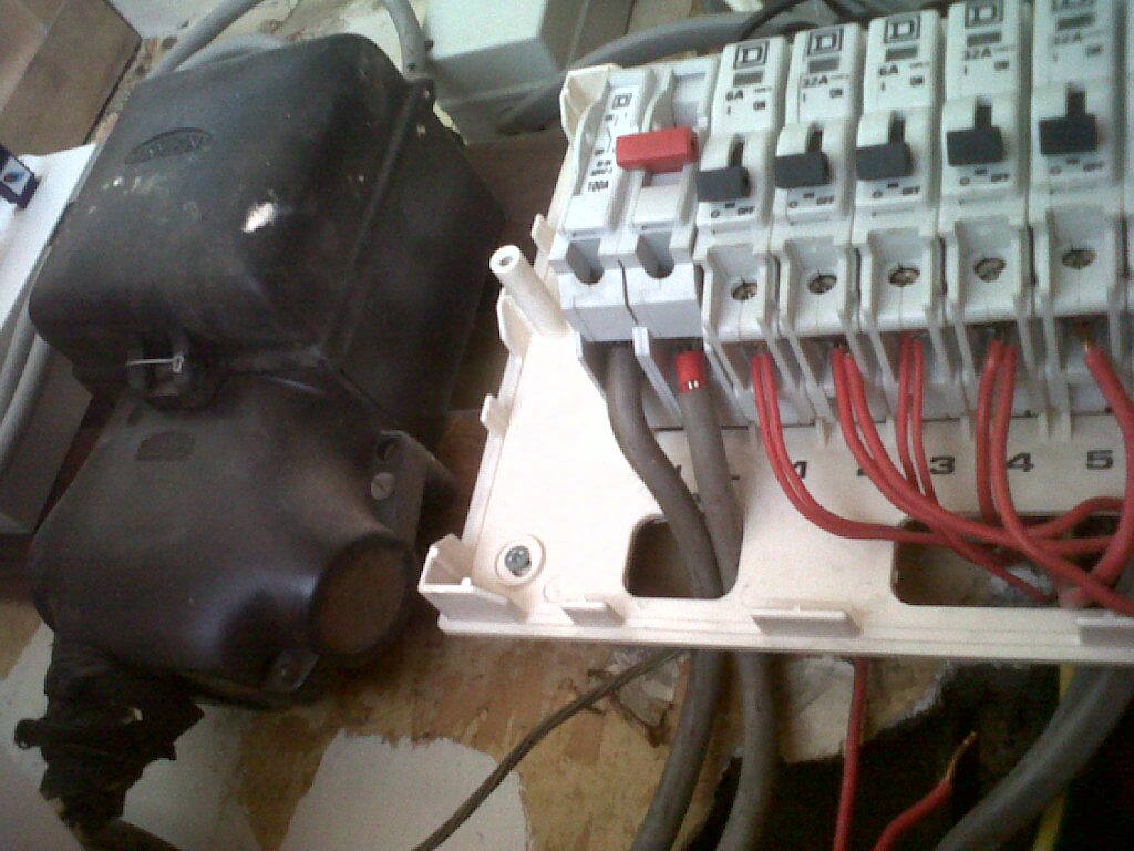

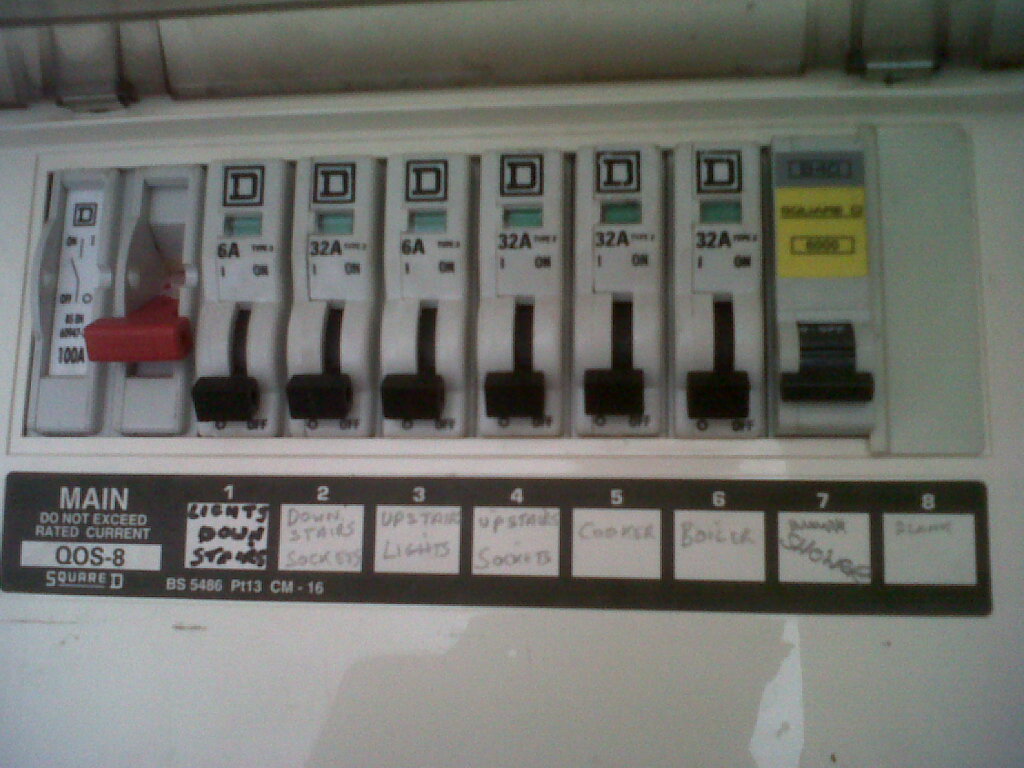

Good afternoon everyone, I'm just looking for a little friendly advice if I may.
I have been to a property to price up installing an Extractor fan (via lighting circuit in Bathroom) and a FCU for a combi boiler.

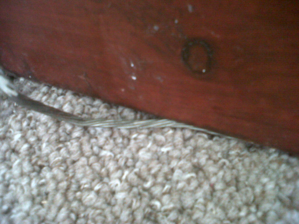

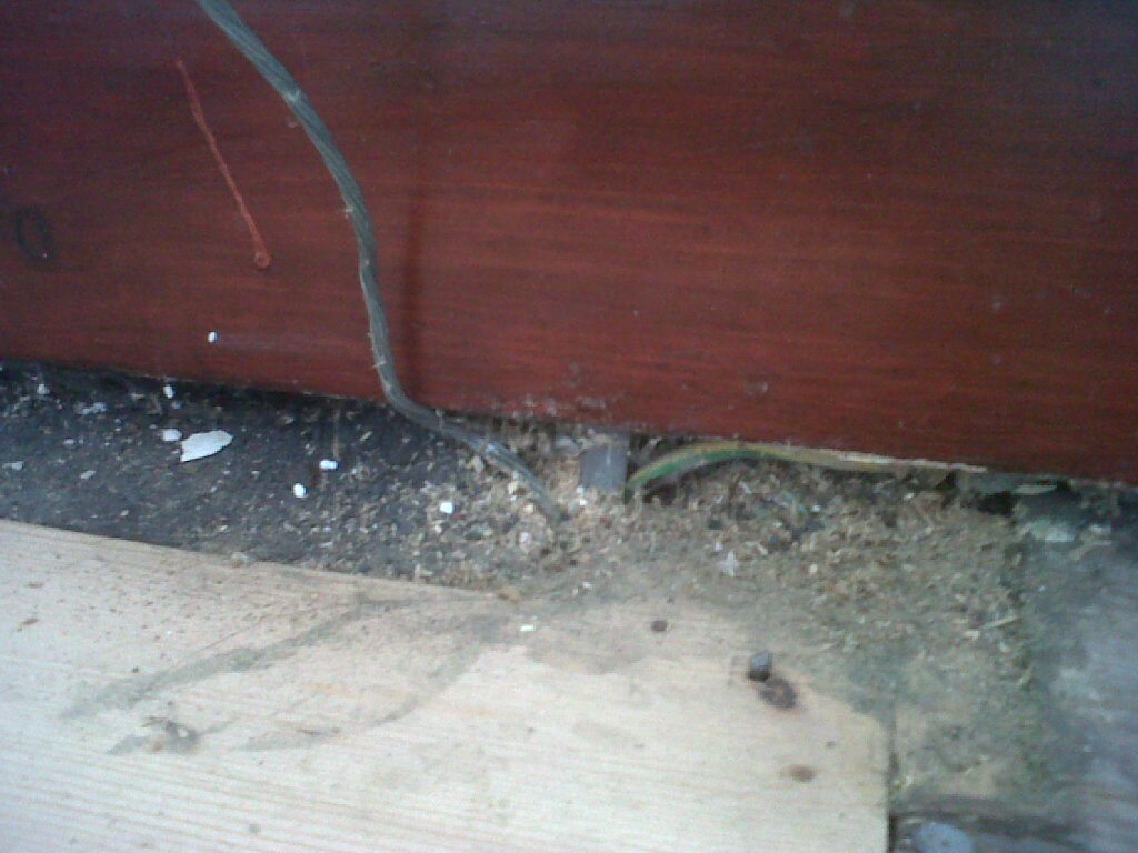

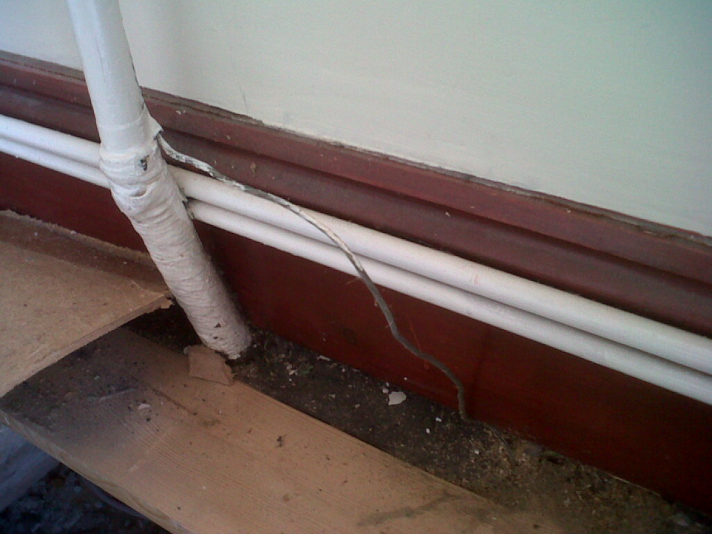

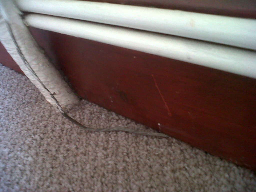

Before work was due to commence I noticed that the Main Earth was completely uninsulated, exposed to touch and running across the top of a carpet before disappearing under the floor. I advised the client that this would need to be replaced as under fault conditions this could create the risk of electric shock or even a fire.

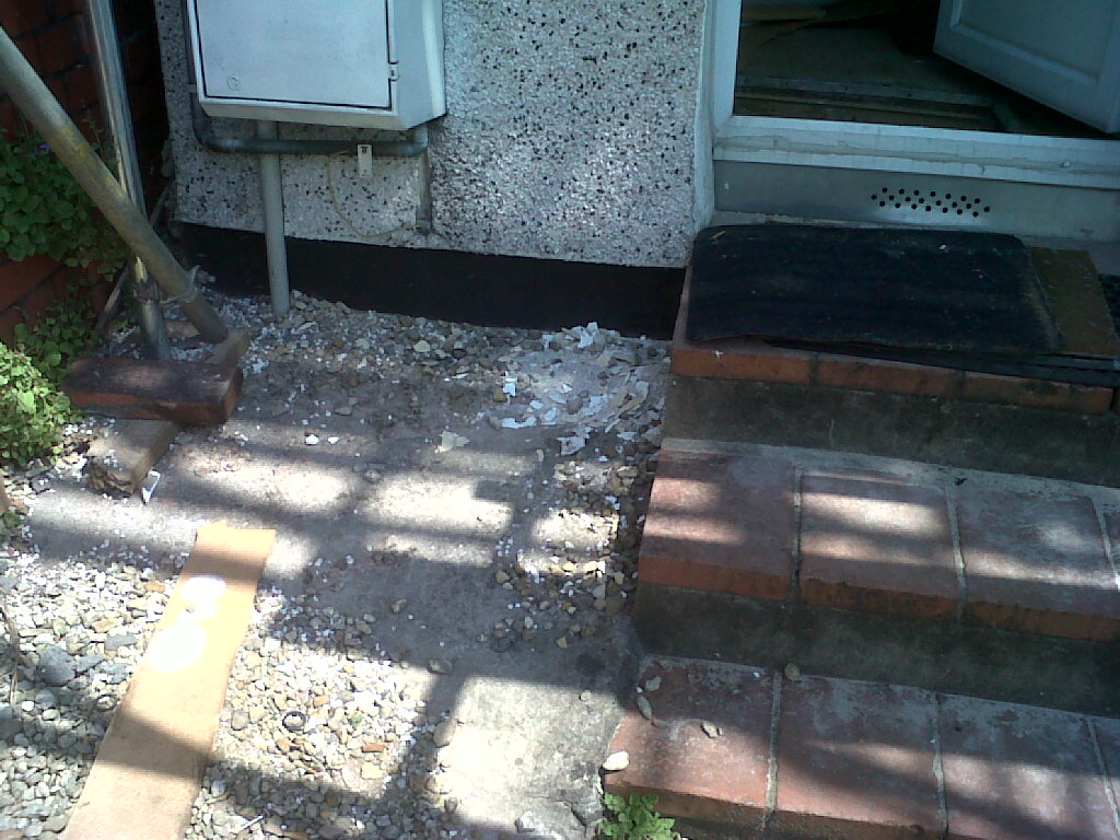

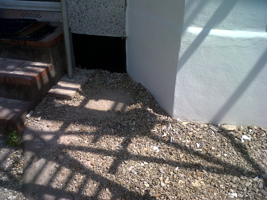

Now on further investigation I got a reading of 0.21 ohms, I was very surprised. However, I cannot locate the earth rod. Once the cable goes through the boards it disappears through the wall (beneath the lounge area) which has laminate flooring.
Now I'm going to contact Elecsa about this issue but as I do not encounter many TT Systems I would like to hear other peoples opinions.
There is NO RCD protection at all, whether it be for the circuits OR upfront.
I am of the opinion that regardless of what I do I will not better the reading by positioning a new accessible rod outside of the building.
Who else would advise that the circuits to be worked on are protected by a 30mA device and an upfront time delayed RCD? How would you protect the uninsulated main earth? trunking? Be stuffed if I'm going to try and sleeve it :lol Trunking would eliminate the touch factor but risk of fire???
Client is not wanting to spend anymore than is necessary but is about to rent the property out. What should I be advising as a MINIMUM that is not likely to be contradicted by another spark? (lol)
What are the requirements for a property being rented out with regards to the electrical installation?
Any advice will be VERY VERY much appreciated, like I said I will be contacting Elecsa for their view too.

Are you sure it goes to a rod mate? May be just connected to gas and water incomers!
I did wonder this to start with but Gas and Water enter the property in the opposite direction. Not to say that it doesn't somewhere else however but without locating the termination it will remain unknown.
Thanks Tel, There appears to be no connection to the sheath for it to be TN=S :thumbsup

It's unlikely (but certainly not unheard of) that a typical UK TT system alone will give you a Ze/Ra of 0.21 ohms. Far more likely you have extremely good parallel earth paths by way of the water and or gas pipework bonding.... Which in essence is the installations Zs value...

So would it be acceptable to just ensure that I protect my work by means of 30mA protection and leave the rest of it well alone? Bearing in mind there is no RCD protection on the system at all at the moment?

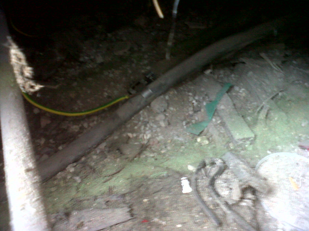

If the main earth conductor is not sheathed, it my be touching pipe work under the floor or touching structural steel works?

I'd first check if you have a TT system in place. Have you identified the bonding cable(s)?? So is this bare cable the rod cable or bonding cable?? If no TT system, then you'll need to advise your client.
Whether this bare cable is the Rod cable or a bonding cable it will need sorting. You could cut it at a suitable position and crimp a length of insulated cable, that you can run clipped around the walls of the lounge etc.

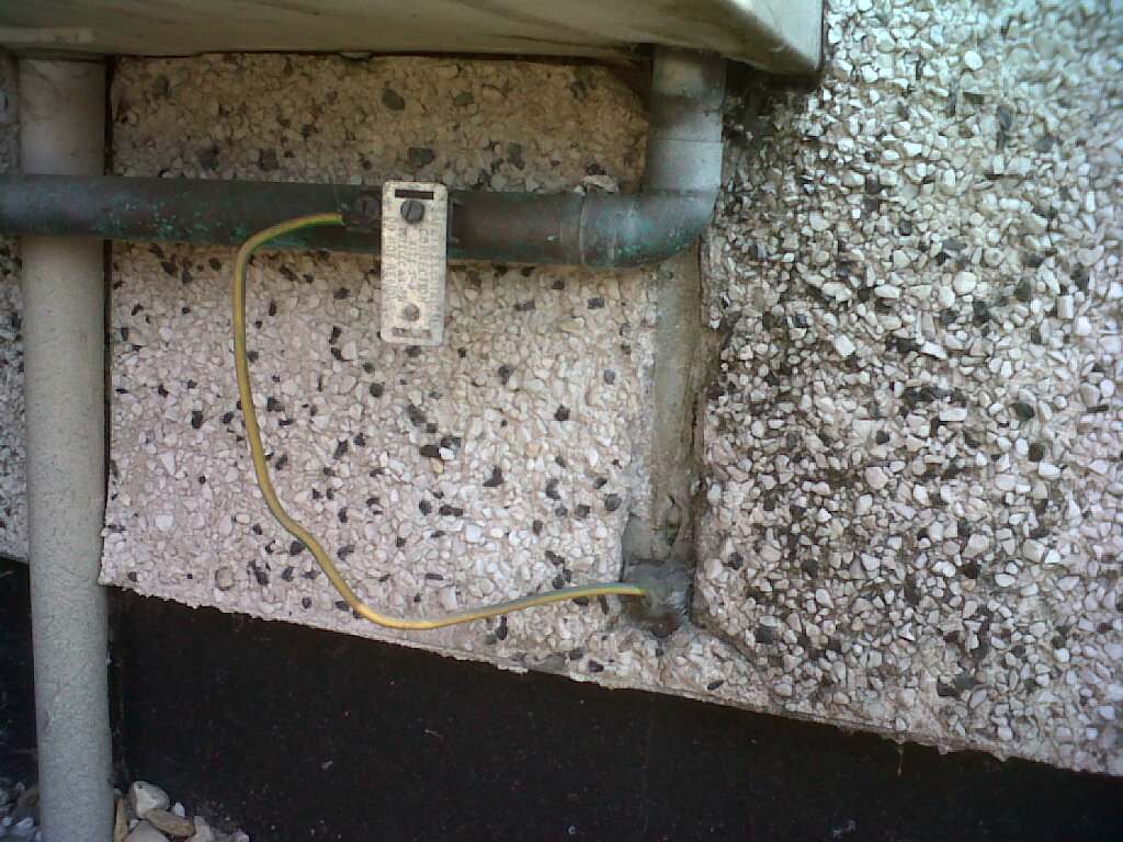

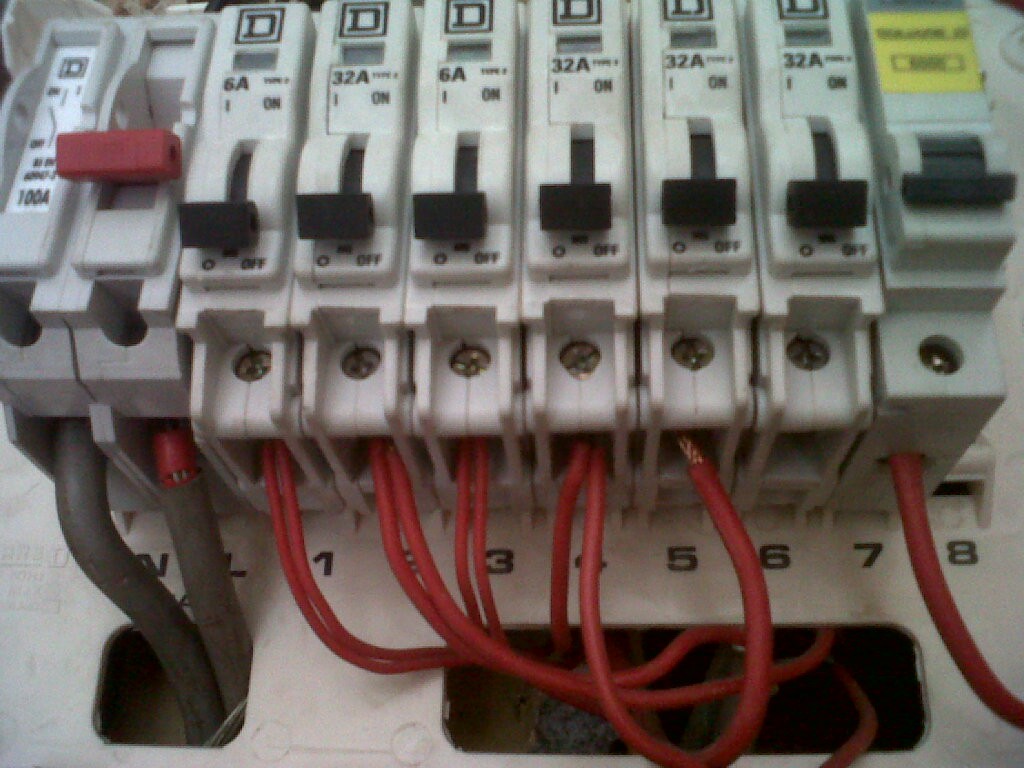

Thanks E54, I have identified a 10mm bond to the water in the kitchen and a piddly little shoe lace bond to the gas from the water pipe which I also advised be replaced especially as the Consumer Unit is not very far from the Gas meter anyway.

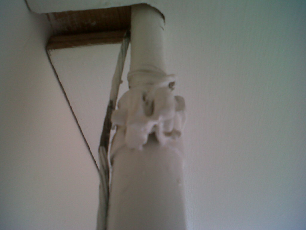

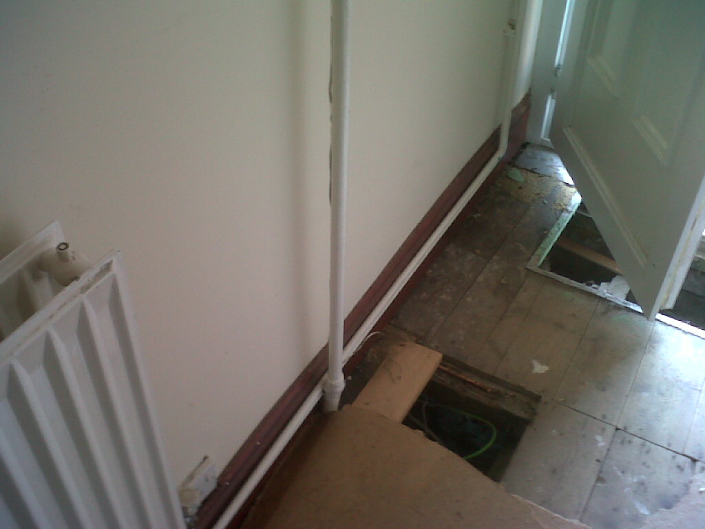

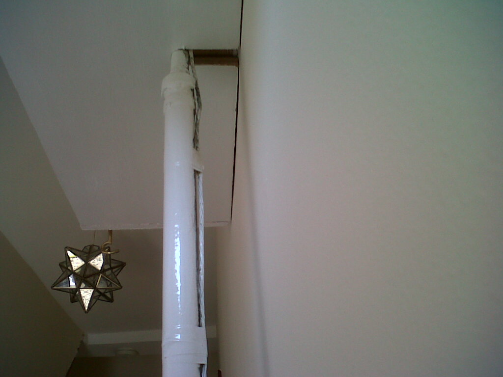

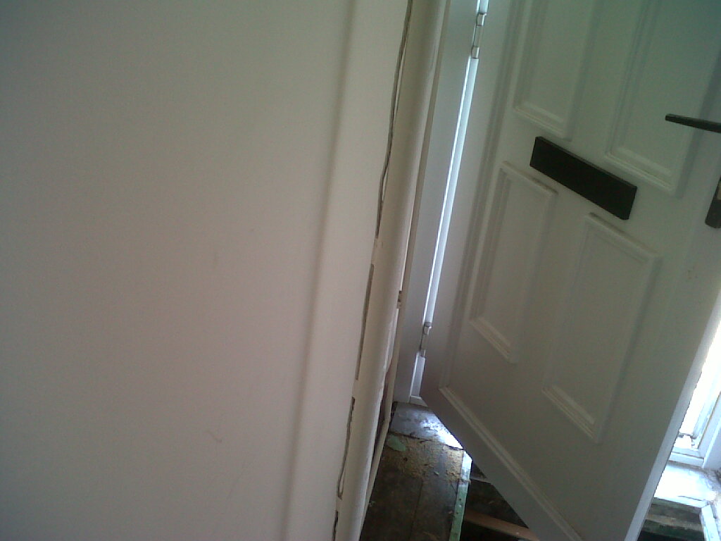

The unsheathed cable is definitely the main earth but where is runs is unknown unless the laminate floor gets lifted and there is definitely no rod visible anywhere at the front, side or rear of the property.
If I'm honest, I am quite happy to walk away from this job if the client doesn't want to do the REQUIRED work but I am just hoping to satisfy myself that what I am advising IS what is essentially necessary. 30mA protection on every circuit has already been rejected and it's been stated clearly that only the essential work will be be accepted.
My first advice was, Replace uninsulated main earth - Then discovered that the rod (?) was not accessible, bonding to gas upgraded and taken to consumer unit main earth, circuits to be worked on protected with 30mA device/s.
Once I have established exactly what is acceptable I am happy to advise client accordingly and if they are not prepared to accept this then I will walk. At least I can sleep at night knowing that my advice was sound and it was their decision not to go ahead with what is required.

I would leave the original "Main Earth" cable in and add a new ROD in a position where it can be inspected.
Then RCD the installation as above.
Have you isolated the supply and carried out an Ra reading at the main earth with the bonding disconnected? I'm not sure if you are saying that your 0.21 ohms is "as is" or from the main earth only.
At least that way you could be sure about where your earthing is coming from.
If you have a Ze of 0.21 then you would not need to provide the upfront time delay RCD as you would meet disconnection times with the OCPDs.
Obviously you would need the 30mA RCD protection for your circuits (assuming spur is subsurface cable).
Regs wise the earth rod connection should be accessible, so i would try a bit more searching to find it, might be worth asking if an extension has been built and covered the rod!!. Have a wander in the garden in line with where the cable enters the lounge.
Insulating the main earth or replacing (part of) the cable would be good.

My first advice was, Replace uninsulated main earth - Then discovered that the rod (?) was not accessible, bonding to gas upgraded and taken to consumer unit main earth, circuits to be worked on protected with 30mA device/s."

If it's a TT system and you can't find the rod then you don't know where the 0.21ohm reading is coming from and you don't know if it's a reliable setup. I would definitely install a new rod and leave the existing earth wire connected as well after sleeving it.
That .21 reading isa bit too good to be true so I would be suspicious. I might consider putting 40A through it with a loop impedance tester and see if it's got any integrity as long as it's not connected to a gas pipe :)
If there's another room which is not covered by laminate flooring could you not lift a few boards there and get into the crawl space underneath as there is often a way through the brickwork supporting floors which might give you access to the rod. At the very least you might be able to trace the cable a bit more.
