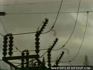

The job was within the cage, right next to these things
