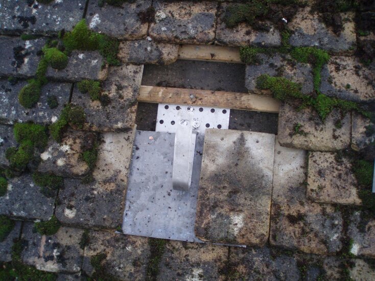

Here goes.. If your timbers are 35mm, it sounds like you have pre formed trusses, in which case by design it should be fine for the loading of the extra weight, however being only 35mm you can not get 3 fixings per bracket into the rafter, it should have an extra timber fixed to the rafter to allow for the 3 fixings, unless, of course, the company used a system called klik-fit, which, although portrayed to be MCS compliant, is generally frowned upon within the Industry.

Fixings !! we only put 2 fixings in each bracket! but i can assure u the roof will blow off before my brackets come loose! its all about builing knowledge!! ie what your fixing into? size of fixing ? Too few - too many will have same effect (crap install) panels laying on your lawn in the morning!! if we had to up the timbers then yes we would fix 3 times but on the installs we have done we havnt had to!! ps earthstore has !!LOADS!! of knowledge :)
Never heard of 3 fixings before! why not 4? :smoking:
I always pilot the holes and pop them in with a decent impact driver (without coming out the side!) Never had any issues and we've had some testing conditions lately! I personally think the priority is getting enough brackets in, equally spaced and we always put an extra one in on the ends of the array, plus making sure the panels don't have excessive overhang and the last bracket is no more than 250mm from the end of the array. I think the problem would arise if there was sufficient movement to allow the fixings to work loose overtime.

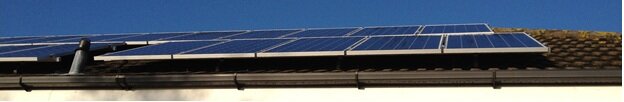

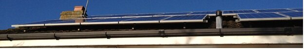

For what its worth, here are pictures of the install. I appreciate it may not show much, but does anything look untoward?
To much overhang from last bracket to end of panel on right hand side in my opinion, awkward to see due to picture but looks like about 500mm to me!
i think ???? max is ment to be 450mm if i remember corectly!!but im sure i will be corrected:0
We've always gone by 250mm, sometimes pushed it too 300mm if i'm honest because its a mare getting a noggin in (right down in the eaves for example) but even 300mm allows a lot of play up and down, normally try and keep them as close as possible to the edge. Over time that movement will definitely have an effect on the fixings becoming loose in my opinion quite a bit of leverage there putting strain on the end roof hook.
i think u need to contact firm who fitted it if ur not happy! everybody has his own methords/standards/opions i think your job is fine just look at the meter and :) if it stops clocking up have a look in the field next to u :))
Reactions: 4 people
Thanks again for the comments.
The comments on the most right hand bracket being too far in - this makes sense. Visually to me this is the one thing I have noticed, sometimes the end panel is flush with the remaining panels, other times I can see that the corner has raised by a few mm, so there is definately some movement there at the moment.
I assume this movement over a number of years would cause issues?
If it was to be fixed, how could this be done since there would be no more roof batons under the right most panel?
batons are not used on your roof! loads of ways ie if no truss then timber added in roof for this purpose but as ive said before CALL THEM!! not that it needs doing from what i can see!! i think ur paranoid !! the more u look the worse it gets !! also u could get whiplash if you go on like this!!
