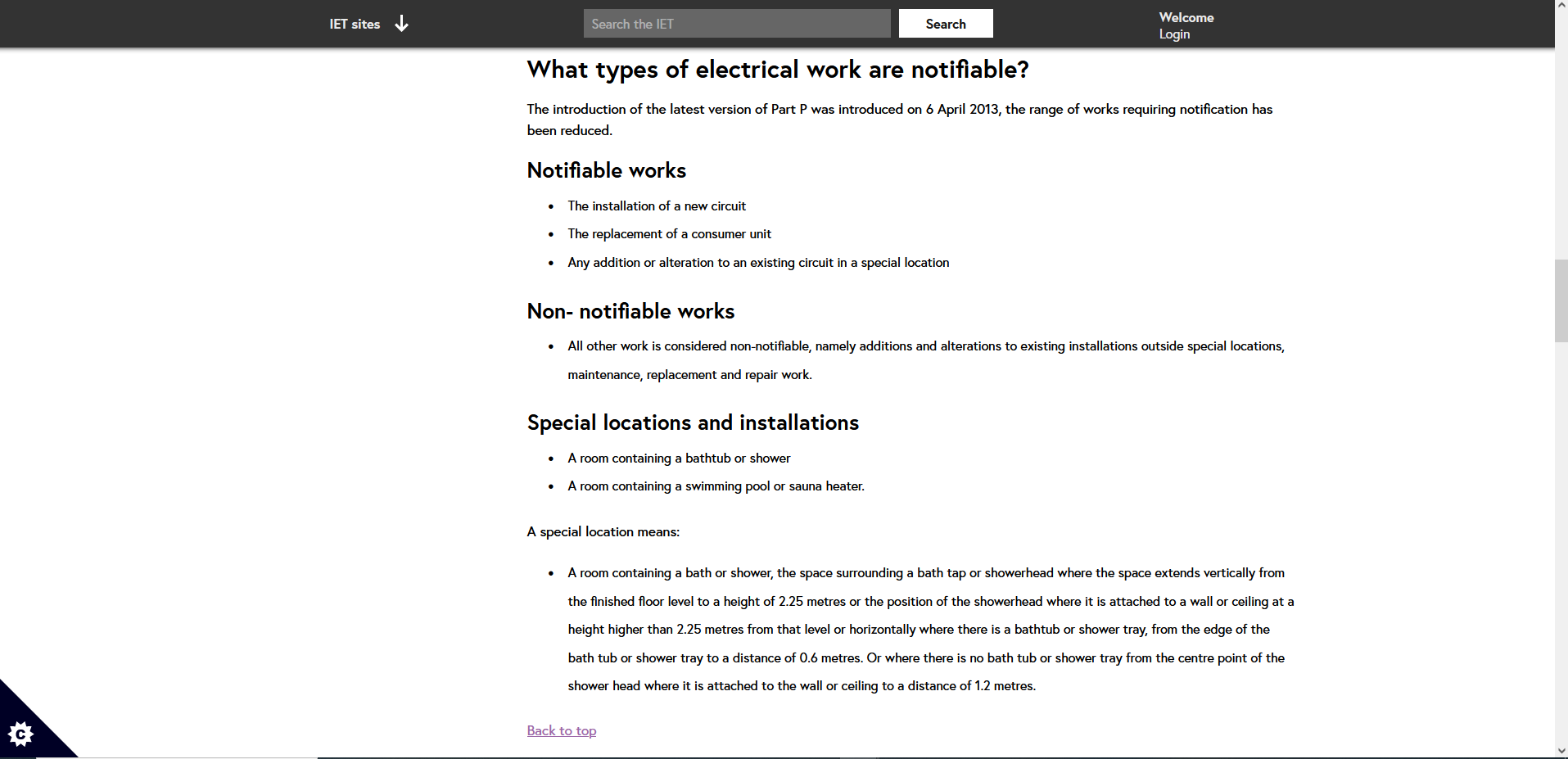

FIY DIYers are not allowed to go near the CU by the way. Building Regs Part P. I think you will find it describes any work on the CU as notifiable and requiring the services of a registered electrician.
That is a lot of misinformation.
Which part?
In the meantime...
https://electrical.----------/bs-76...england-and-wales/frequently-asked-questions/
It's implied. The work needs to be covered by an EIC. A DIYer can't self certificate.
Read your 'notifiable works' and see it applies to the OP ignoring the fact he/she is based in the US.
