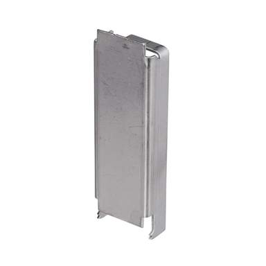

Wylex do 3 blanks I know of, the plastic "twist fit" ones like this:
The equivalent metal ones like this (similar to Axiom ones from Toolstation, actual part has 'EMB1' on it as same for Crabtree):
And the blank MCB replacement like this:
I would say all of the meet the manufacturer's instructions and the usual metal CU door automatically shuts for fire containment anyway. Having said all of that, my observations are:
  • The dummy MCB helps keep spacing other MCB/RCBO in the right place when fitting stuff, torquing up, etc, but is not terribly strongly held in place itself with the cover off. It also shrouds the busbar if you are doing any live testing with cover off.
  • The plastic "twist fit" cover is loose and never stays where you want it when putting the cover back on.
  • The metal one seems to deal with that problem as it clips in place with sharp points (presumably for good connection through paint), also usefully it can be done after fitting the cover so useful for retro-fitting on practically any metal CU as the DIN slot size is pretty standard.
However, for the alarm then they do have an important point as @littlespark points out for rented accommodation it has to be fixed batteries (basically morons "borrow" the PP3 for kids toys, etc, but the council/landlord are liable for failure of the alarms).
