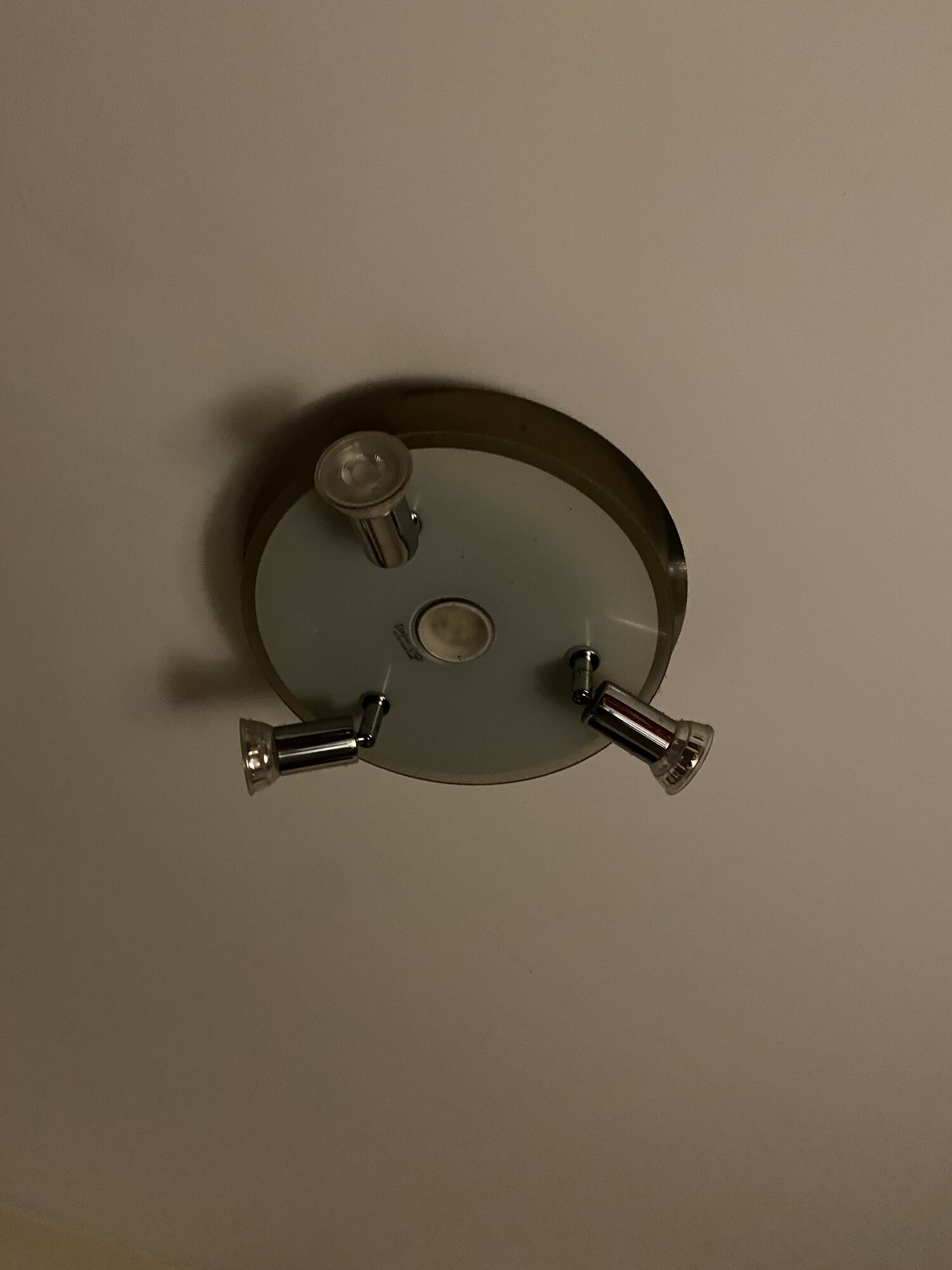

I’ve attached some more photos without the grey protective covering and the light that this powers 👍 thanks guys! I can take the light fixture off to show the wiring directly to the light if needed

Don’t know if it’s worth mentioning that there are actually two light switches to the light fixture (no idea why)
I only use one of them, and I have drilled through the one that I do not use
It is very much worth mentioning. We are close to the limit of what the forum rules allow regarding step by step instructions, for safety reasons.
Take the cover off both light switches. One of them will have two cables in. One of them will have one.
Hopefully the one you do not use has just one.
Post clear photos of the back of both.

You did. Turn power off.
At the switch with lots of wires:
disconnect, remove and set aside the wires from the red, yellow, blue cable (that is damaged further along). Cut the very ends off and tape up well.
The leaves you two red wires belonging to the same cable. Connect them to Common and 1, either way around.
Leave all the yellow/green sleeved stuff alone.
Put that switch back together.
Your lights should now not trip.

Cannot thank you enough, you’re an absolute star. Worked like a charm!!! Saved me a hell of a lot of hassle and money, all lighting back on! 😊👍
