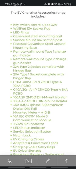

I've seen the RCDin them back itself and burn-up but not seen owt with that charge controller. Contact Rolec and see if it's a replaceable part, may work out cheaper than a whole unit.
Mikey (of Residual Current/Load-out) dropped a Rolec vid where he replaced a socket assembly that had burnt out so it would appear that parts can potentially be sourced singularly. Reach out to Rolec and ask the question. Try them; +44 (0) 1205 724 754
The RCBO failures seem to be of the early ones with a blue button and switch. The ones with a green button and switch (like both of mine) are reputed to be reliable.
It's definitely a replaceable part, but, according to Google, new ones aren't available from Rolec at the moment, allegedly because of a shortage of the required 'chips', and consequently this has had a knock on effect on used ones. I found two EV parts suppliers who list second hand ones, but both show 'out of stock'.
