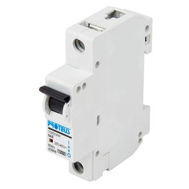

that sounds like the right solution to me. The 3p DB is a proteus and looking at there product range they do a only seem to do a C curve breaker unto 63amp... but come to think back to looking at the job today im sure the 50amp breaker is only a 6ka capacity... im also considering fitting the new tenants DB as a RCB board to minimise any chance of loosing multiple circuits, although there seem to be only 3 lighting and two radials
If it is a 3-phase board it should be the "commercial" range and they are 10kA and offer 63A D curve:
But I have no idea of the board you are dealing with, that was just a quick search on CEF.
(To be fair to CEF/Proteus, they actually do decent data sheets for their products)
Going RCBO is best if you can, and for a handful of circuits the cost is not that much compared to the time you have to charge for in order to fit and test it in any case.
Yes its a commercial BX type so a 10KA will be spot on... (ps i think they are the ALDI of the db world !)
