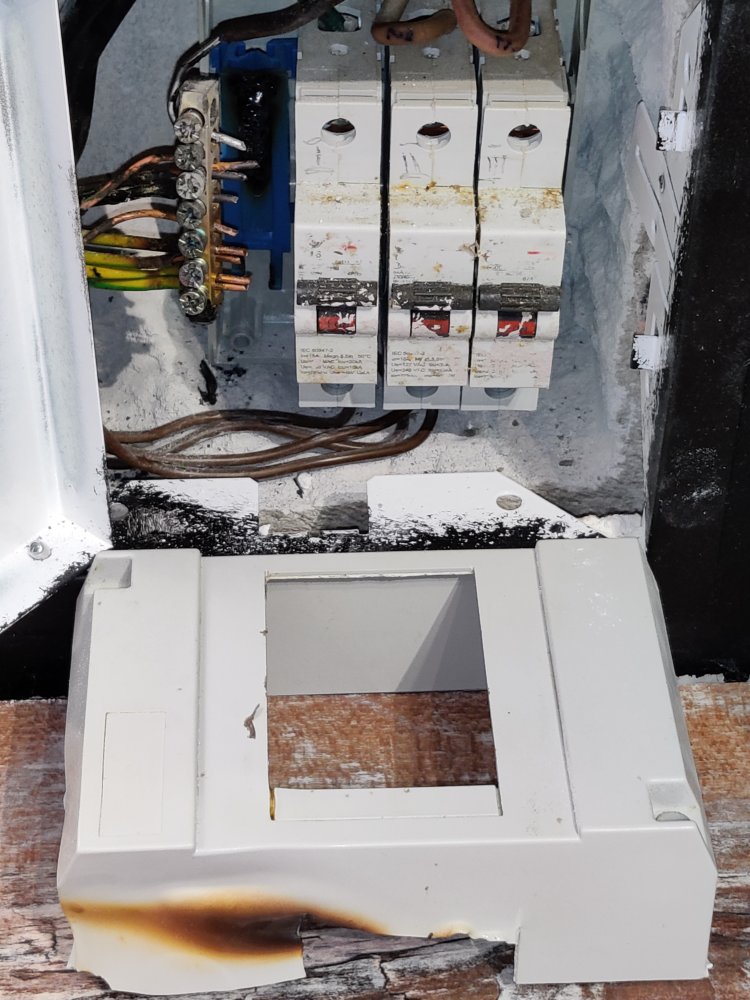

Hi guys, hope you can try to shed some light on what might be the problem. Basically nothing is new, all been the same for 3 years since we moved in but over the past few days when the dishwasher was on (or anything plugged into a socket in the kitchen) I noticed a burning plastic smell. Couldn't figure out what it was until a fuse tripped the other day (popped actually - I thought a lamp bulb had blown), I opened up the fuse box panel in the gypsum wall and saw the melted plastic fuse box cover, took that off and saw melted plastic on the wires. The fuse on the right is what tripped but it only has the kitchen sockets on it, nothing big on here only a fridge and the dishwasher, from time to time the toaster and kettle. The one in the middle serves the bathroom lights and on the power to the corridor. There aren't any big loads here at all. I can't figure out why the plastic would melt like this. I tested it again and when I plug anything for long term (like the dishwasher) the fuse gets warm and then eventually hot and I'm guessing will trip again.
I will call an electrician obviously, but when the 'Corona virus' is over, not now - I'm staying home and not inviting strangers to my home either. I have kept the fuse off for now and using an extension lead for the appliances from another socket in the next room.

It is a very serious issue, as they use TN-C so this bad connection on the supply PEN would make the appliances live.
Really the supply to that board should be switched off until it is fixed.

That's a pretty extreme example of a bad connection!
EDIT: That appears to be the submain CNE, i.e. combined neutral / earth incoming from the other panel. If it is, this is a dangerous situation that could give you electric shocks from your appliances or at the very least damage them.
As advised by PC1966, please switch off the power and get an electrician on to this immediately. I can't recommend any other approach.
Don't you all think we ought to tell him that in the interim he should turn off at the incoming main and tighten the terminal?
That was our recommendation first time around. For whatever reason, the neutral bar has burnt out again. If it were a line or neutral then yes, but as it is a CNE then the risks arising from a high-resistance connection are that much greater and I don't feel it's appropriate to recommend DIY repair of a burnt-out CNE where the cable is damaged.

From that video the whole lot looks like a disaster area, the conductors and bar are badly damaged, a real risk of fire and electric shock.
Hi guys, I replaced everything this time around instead of just cleaning up the wires and terminals etc, I have put in a new wago terminal block, new fuses and new wires from the terminal block back to the wago fittings back to the wago fittings buried in the left hand side of the wall. Having stripped back a bit of the incoming cable the wire that goes in the terminal block actually does appear to be aluminium and is much thinner than the three cables going in the top of the fuses. Picture attached - hope it looks okay to you pros, I will monitor it and see if the same thing happens again then I'll get the electrician in to change that cable out.

That looks better, but the incoming cables still look suspect, have it done sooner rather than later I would suggest.

That looks good! I would definitely use aluminium jointing paste on the incoming cable though, Wagos are suitable for aluminium provided you do so. Their product is called 'Alu-plus', it prevents corrosion and electrolysis and will reduce the chances of it going high-resistance and overheating. It comes in a syringe that you use to fill the entry hole of the connector. After cleaning the end of the cable, insert it into the connector immediately, before the oxide layer builds up. You'll only use 1% of the tube of paste but I think it's worth it and the joint should then last the remaining life of the cable.
One other subtlety to do with the neutral bar, you might choose to rework or ignore...
I think the bar is made up of three 5-way connectors linked togther. At the moment, because of the layout of the outgoing neutrals and earths, the top link adds two joints and therefore points of failure to the CNE. I appreciate it's probably the most reliable connection in the box, but if it were to fail (perhaps due to heating from the aluminium connection) two of the earths might remain connected to the earthed incoming cable while the other two are connected to floating neutrals which will become live, creating a significant shock risk between different appliances in the home.
What I would do is put all four earths in the top block, all four neutrals in the bottom, and the incoming cable in the middle. That way the two joints formed by each link only carry neutral or earth, not both. If heating from the aluminium cable joint caused a failure of the middle contact block, even if the earths become disconnected from earth, at least they remain connected together. Another advantage of placing the aluminium incoming cable in one of the three middle entry points of a Wago is that there is twice the cross-sectional area of metal inside to conduct heat away from it, helping to reduce the rate of deterioration if it runs warm.
