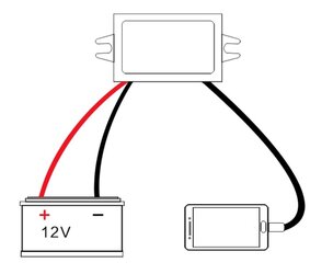

My project is to install another car accessory, but I don't want to use the cigarette lighter as I am fed up with wires spewing from the console. As with hardwiring kits, I want to piggyback into the fuse board, thus hiding my 'wiring in'. Given just about everything has a USB-A plug at this end, I am surprised there isn't an off the shelf 5V 'female USB-A to piggyback fuse' product.
There are a few hard wire USB sockets, but they all appear to have two wires, instructed to connect to the positive and negative terminals of a battery.
Most are styled like 'cigarette lighter barrel', but I like the simple version, picture included (my only hesitation being that I can't find a reputable manufacturer).

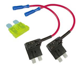

So, how do I wire in a positive and negative wire into a generic piggyback fuse? Not wishing to insult you guys, but I have included some pictures for clarity (perhaps more so for any others viewing this question).
Can I simply twist the positive and negative together, then crimp directly onto the single wire coming from the generic piggyback fuse?
Bearing in mind my total lack of understanding of electricity, and therefore not knowing if it is a really stupid question, I will attempt to explain my reasoning ...
TBH I haven't given much thought to circuits when using hard wiring before, but it has occurred to me that the fuse has two spades, which I am guessing are inserted into positive and negative 'sides' of the fuse board. My question comes from the fact that the piggyback fuse has a single wire, used to connect the accessory that it is powering. As the externally powered accessory must have a positive and negative side, it makes me think that the accessory (in this case the USB socket) doesn't actually need two wires, and perhaps the electrons flow to the right terminal ... being the reason I am posting here, to ask you clever people 'how it works' (as well as 'how to do it').

No, don't connect the positive and negative wires together. The negative 'ground' connection would normally be taken from a chassis connection somewhere - possibly a ring terminal from a bolt.
Only the positive comes from the fusebox. In your case it is from the additional fuse in your piggyback adaptor.
And just to confirm firm, your USB socket does indeed need a positive and negative connection.

Hi, sorry ...additional question(s) if you don't mind.
The wires connecting this step down are not only incredibly thin (is that referred as a high gauge, or low?), but also short.
I will need to extend the negative/earth.
I have now entered into the world of AWG, which I understand to be complicated by length, ampage, and if the devices are in-line ...
My straight forward question (?) is, would 14AWG be sufficient for an extension of ~1m (tops)?

14AWG has a cross section of about 2 sq mm, good for 20Amps+, so rather overkill for the approx. 1Amp that the USB converter will take (from your battery when the USB fully loaded)
I would suggest wire (flex) that is somewhat thinner, say 1.00 sq mm or 0.75 sq mm
In the latter part of your post, you mention a 5A device. I presume you are not talking about this USB adapter, because that won't take much more than 1A (15W apparently)
If you need to take 5A, you need at least a 5A fuse, and preferably one that is not already feeding a device requiring up to 5A!
