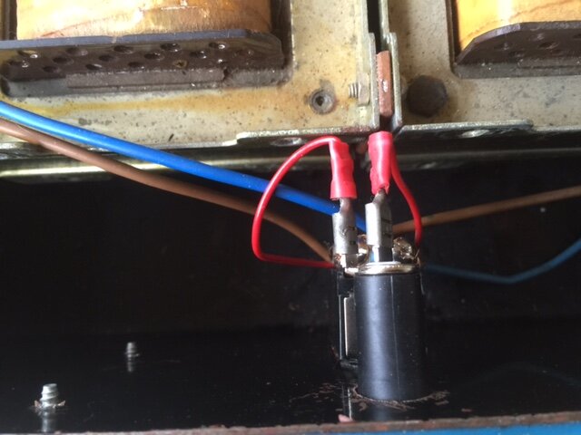

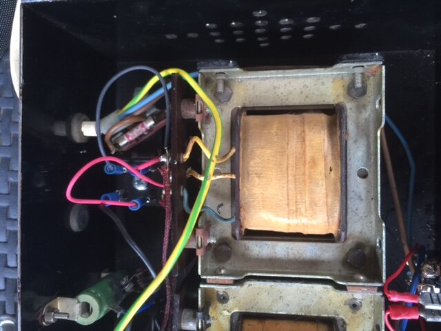

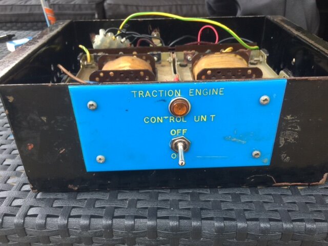

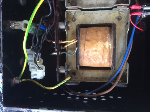

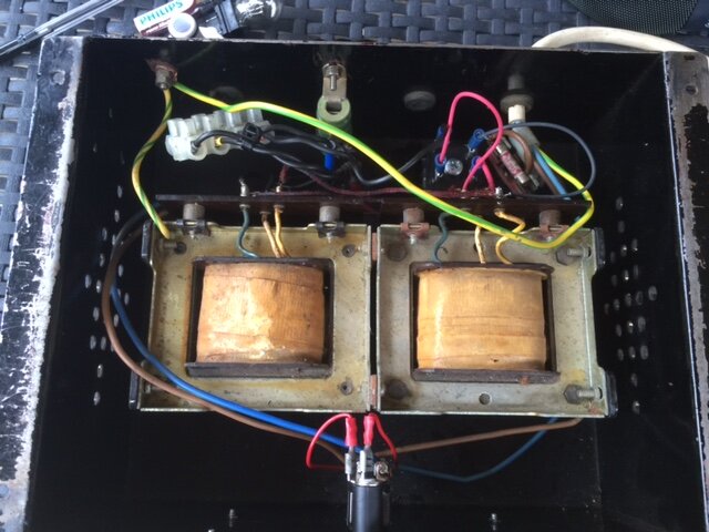

Please find photos of the transformer.... it was working fine until I moved the engine than it stopped. There was no burning or smell. I have changed the fuse and the switch. The light will not light up. I am able to get a reading of around 5.5v when it is plugged in and turned on. However, when attached to the motor I get no reading at all. Not much help...

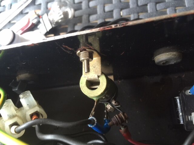

OK, not the best or safest piece of electrical construction. As fas as I can tell, the mains feeds two transformers of which the secondaries are paralleled. Two feeds are taken off to the terminal block rear left which I assume lead to the model. One is AC (for lighting?) from one end and what I take to be the centre-tap, and one unsmoothed DC from the other end and CT via a bridge rectifier (4-lead device on bottom) and variable wirewound resistor (green device on back).
As I say the construction is not the safest but the fault is quite likely the resistor or its connections having gone high-resistance e.g. at the connection to the movable strap which looks corroded, or the winding at the point the strap is in contact with it, and potientially fixable in minutes. The failure of the neon to light sounds like a separate thing (just a dead neon) otherwise there would likely be no output at all even when open-circuit. The rectifier might have failed but they usually short-circuit which would probably blow the fuse. How handy are you with a multimeter? How about disconnecting the lead from the rectifier to resistor and measuring the resistance from that lead to the output terminal associated with the other resistor lead?
Regarding replacement, apart from constructional quality, the speed variation obtainable from that resistor might not be very great, plus the speed will vary more with torque than it needs to. A variable voltage supply would be better than this fixed voltage supply with series resistance, however we need to confirm what the load current is and the necessary voltage range before one can be chosen. Is it genuinely a normal car wiper motor of nominal 12V? Can you read anything on the resistor?

thank you for your detailed reply. I will take a look at some of your suggestions, but sadly I am not all handy with a multimeter... As far as I know, I am told the wiper motor was a 1960s car a ford Anglia I think. This was overhauled about 3 years ago. I put my car battery on it in situ and once the belt was fitted over the flywheel the engine turned over very fast. It was a little too fast for my liking and of course it has only one speed. I am thinking this is not very helpful!

You could well be right about the resistor tapping band - I hadn't seen the images when I posted.
From luciens description of the AC output and DC controlled output it sounds similar in function to the basic model train controllers with a 16V AC output and variable 12C DC output.
Which is what I have for a couple of model fairground rides.

A better way forward would be a 12V PWM controller for the speed, fed from a safe 12V powersupply, just need to know how much current the motor takes when running. At a rough guess I would suggest giving this a try with the car battery as a power source https://www.amazon.co.uk/Motor-Control-Controller-Professional-Regulator/dp/B00H8JRXKG as a quick test. Please power the unit via some fuses and proper clips, short out a car battery and it will start a fire.
Agreed, a PWM speed controller is the way forward. The many options on that Amazon page and many more that you get from googling '12V PWM controller' might all be OK but they are mostly unknowns.
The motor probably only consumes a couple of amps, maybe 5, I doubt very much it reaches 10A (does it get warm / hot?) If we say hypothetically that a 10A supply and speed controller will be ample (there's no harm in having them a bit over rated, they will run cooler and last longer) then as an example of units from a reputable source you could try this power supply:

Mount the two in your chassis, connect mains in, 12V to controller and controller to motor and you're sorted. The motor may run slightly smoother and quieter too as there will no longer be the 100Hz ripple from the unsmoothed DC.

I had the most extraordinary turn of events yesterday. I work for Whipsnade Zoo steam railway and I went to London Zoo to assess the clearing of an old workshop they have. Amongst the lathes, milling machines and various machinery was a load of old electrical equipment, clearly not been used for many years, destined for the tip. There it sat. A dual tracking regulated power supply, made by maplin. This has solved my problem - I am able to fine adjust the running of the wiper motor so my engine can turn from very very slowly to fast speed. Quite an amazing find. I have downloaded a pic Thank you all very much for your replies, it was appreciated.

Looks like the output is running at max current in your pics. That's usually OK for a bench supply with variable current limiting, but if this model permits its outputs to be paralleled (some do, many don't) then that might be preferable to reduce stress. Give it lots of ventilation though, as its linear regulator dissipates heat that wasn't there in the old supply unit.

Filp the switch on the front to trackiing and use a pair of these http://www.maplin.co.uk/p/p600j-6a-silicon-rectifier-uk61r to common up the output of the power supply, thus the heat gets dumped in both sides. The side away from the band goes to the red side of the power supplies, the side with the band gets commoned up and then connect to your motor. Connect both negative supply terminals together and to your motor.
