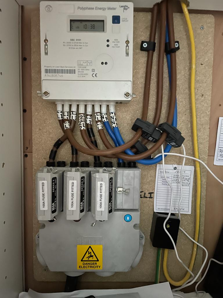

My electricity bills are 1.5-2.5k per month for a 5 bedroom house. My heating was running off ? electric so while this figure is extremely high it (kind of) made sense, as the house is large. I had an electrician calculate the space and electric consumption. As it was so high, I decided to go down the route of Air Source, and have had 4 Mitsubishi air source heat pumps installed to make my electric more affordable... having been told this would take them to half or a third. But my first bill have come in and it is £2300, for ONE month!!. I wonder if I am paying for the electricity for the farm shop next door or something like this. My provider, utility warehouse will only check that my meter is working and the wires inside my house.
Does anyone know how or who can I ask to check that the wires going into my house are only providing electricity for my property. Utility warehouse refuse to do this. is there ANY service I can pay for to prove what is going on. Even if just for me! I am in a lot of financial difficulty now! Thanks

Turn off power at your consumer unit for an hour, at that level of usage you should see it go up quite a bit, then you'll know.

you need to isolate your Consumer Unit ( turn off main switch ), note meter reading. give it a couple of hours and see if the meter reading has changed. if it has, then something else is drawing from your meter. any weird horticultural smells from next door? weeeeed?

You've either got a problem with someone tapping off you, a problem with the meter (which i would demand be changed) or you use way too much electricity.
Turning off you supply for an hour or so would show if the meter stops incrementing, which probably rules out a hidden feed from before your CU (consumer unit = fuse box).
However, you might have some circuit fed from after your CU you don't know about that is draining a lot of power. If you get any of those sort of power monitors meters, for example (just random search, not a specific recommendation):
It shows you the current demand in more or less real-time, then what you can do is switch back on each of your breakers and see if any one circuit causes a big and unexplained increase. For example, if it is your heater firing up then you expect a big load, so turn off appliances as well and see if anything does not add up.
Such a monitor is not as accurate as a utility meter is supposed to be, but you are not really looking at a few percent error here!

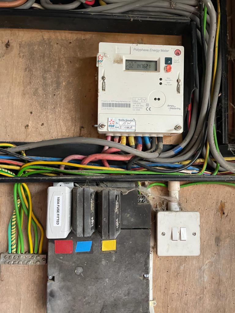

Final question, do you have a 3-phase supply or single phase? If that means nothing the post a photo of your incoming supply & meter & CU here (just make sure no obvious personal identification is visible).
As above, that shows no change in meter reading then I would restore power and switch all the lights and equipment off and unplug all appliances. Note the meter reading, go away for a couple hours and check it again. If it has gone up there is something still connected or some other issue.

Can you post a picture of your consumer unit, meter and DNO supply cables?
