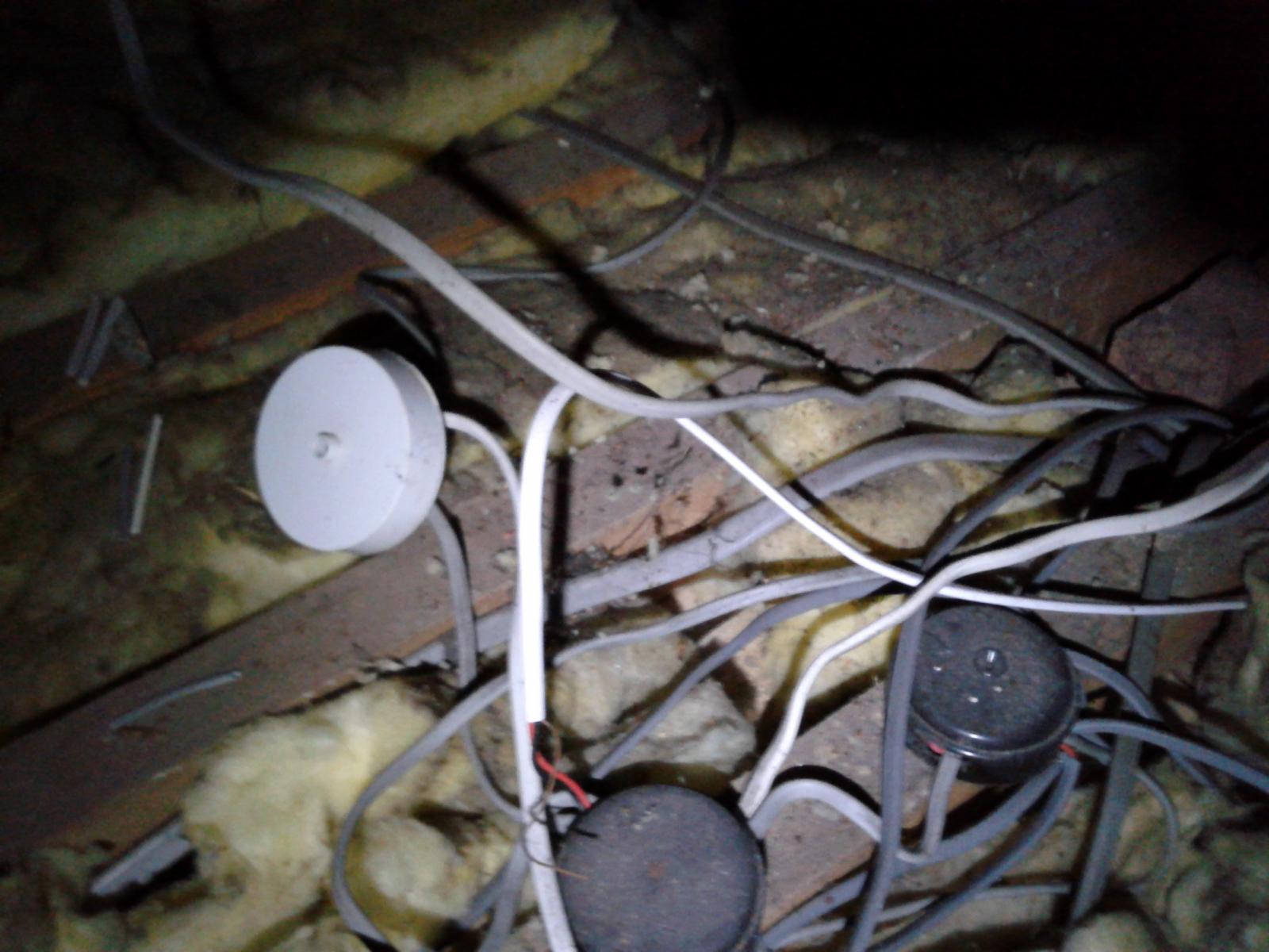

The rewire I am carrying out at the moment has been an eye-opener for me. I have seen many cases of DIY electrics over the years, but the sheer scale of what the previous owner did is unbelievable...
Spurs off spurs off spurs...cables changing size several times supplying many different types of equipment....literally dozens of JB's, none of which have the sheath entering them...cpc's cut off outside the JB's...the list goes on.
That sounds like my old house :)
after I rewired it ;)
Here's a little sample :)
