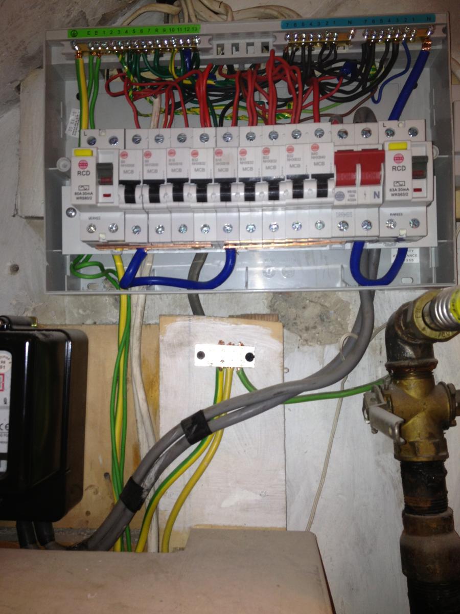

We had this sent to us by the gaffer today asking us how many faults we could count, what do you reckon?

Im off with 6 at first look anyway...any advances? If im miles out, feel free to gun me down...i looked briefly.
Certificate? Date of install? Did anything actually work? Was it installed by a 5 year old?
There's no cover on it for one thing.
Seriously though - was there a mixed colour sticker on the cover?
Never seen RCDs used as stop ends before.
I don't think that there are two versions of colours being used ther.
The one brown conductor is apparently being used to connect the earth bar to one of the neutral bars.
wheres that blue going to coming out of the bottom of the OPD on the left?
i see it now....using it to bridge the busbar
and the bottom of the RCD on the left has both busbar forks in both L& N...and is closed...
Its chaos, apparently a Portugese 'handyman' did this for them, they called him back because everything was tripping, and he 'sorted it'. I literally have no idea what the hell he thought he was doing. No certs of course, obviously no testing.
I think I got up to 8. And thats just whats inside the board, let alone if he did anything else around the gaff
aye....and we all know how he did that...dont we....lol...
