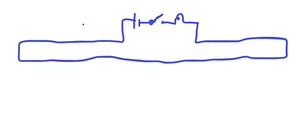

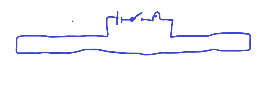

I go and watch something like this...

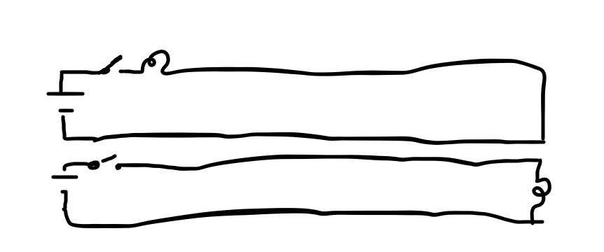

OnlQQker and readers: One might like to consider whether the experiment in the film, which was only described, but if done in reality is identical to the supply of electrical energy from say a battery with a lamp next to it through a loop of parallel conductors 1 m apart 300km long and shorted at their end, and a battery connected to the same loop with a lamp at its very end 300km away. The conductors assumed to be resistance free.
Then consider whether the experiment in the film (second attachment) is physically representative of the end to end power supply system our man mentions.
The usual 'thought experiment' I used to give students was a battery, switch, and an infinitely long pair of wires.
The questions were "What happens when the switch is closed? Will any current flow, and if so, how much? Would it matter what is at the end of the line given it is infinite distance?"
That was the introduction to the (no doubt tedious!) subject of transmission lines and the various aspects such as characteristic impedance, reflection coefficients, cable attenuation and the Neper/decibel, etc, etc.
