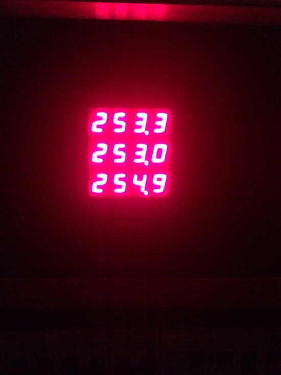

What else is fed from the same circuit as the lighting? Double check connections and things like a wire or busbar on the wrong side of the clamp termination at the MCB/RCD etc. As already stated check the actual lamp holder where the lamp makes contact for any signs of arcing etc. If the DB is 3-phase try swapping the light circuit to a different phase.
I wouldn't overthink this from a technical point of view, 99% of lamp premature failures are because of something fairly obvious like poor power quality (overvoltage surges and spikes), environmental factors like moisture or vibration and poor terminations or connections etc.
This was our distro the other night just before shutdown

If all seems OK with the install I would be tempted to put a couple of LEDs in and see if they last better. If they do you can point this out to the client. The UK voltage and European market prob don't help matters either!
