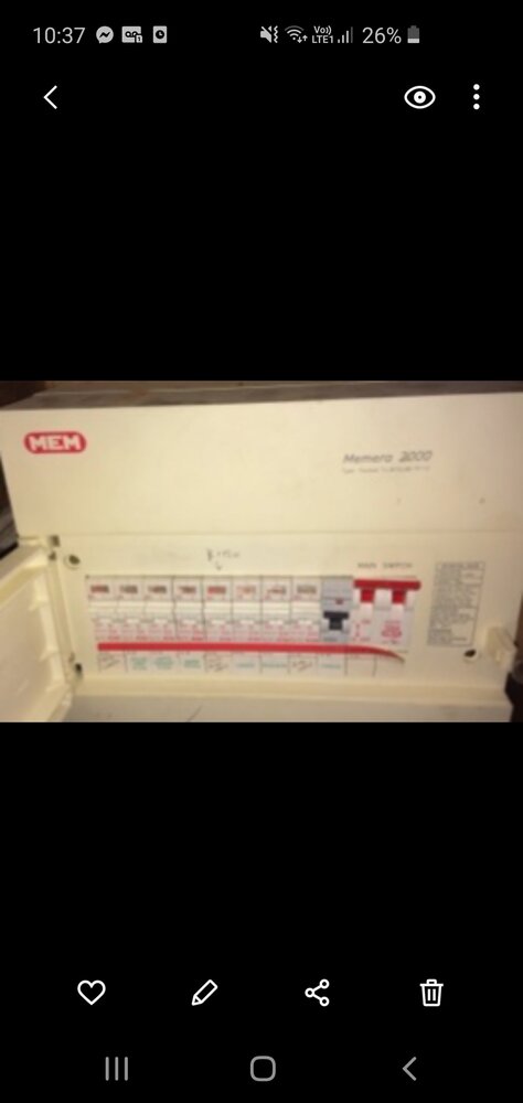

Hey has anyone got any idea if and what rcbo will fit into this board?
This might provide an answer:
You can fit the MEM RCBO pods onto the MEM Shield 2 MCBs.
however if I remember rightly if the MCB is labelled up Memera the RCBO pod will not fit and it doesn’t have the clippy bits on it.
[automerge]1590836545[/automerge]
If you have to add RCD protection to more than 2 circuits though, it’s probably cheaper to change the board. There £70+ per pod
Eaton manufacturer compatible mcb, and a ‘rcd field kit‘ for the Memora 2000. Fitted a couple myself, but the field Kit is about £115.
They are also quite bulky and can be a tight fit, if the CU is packed with cables.
