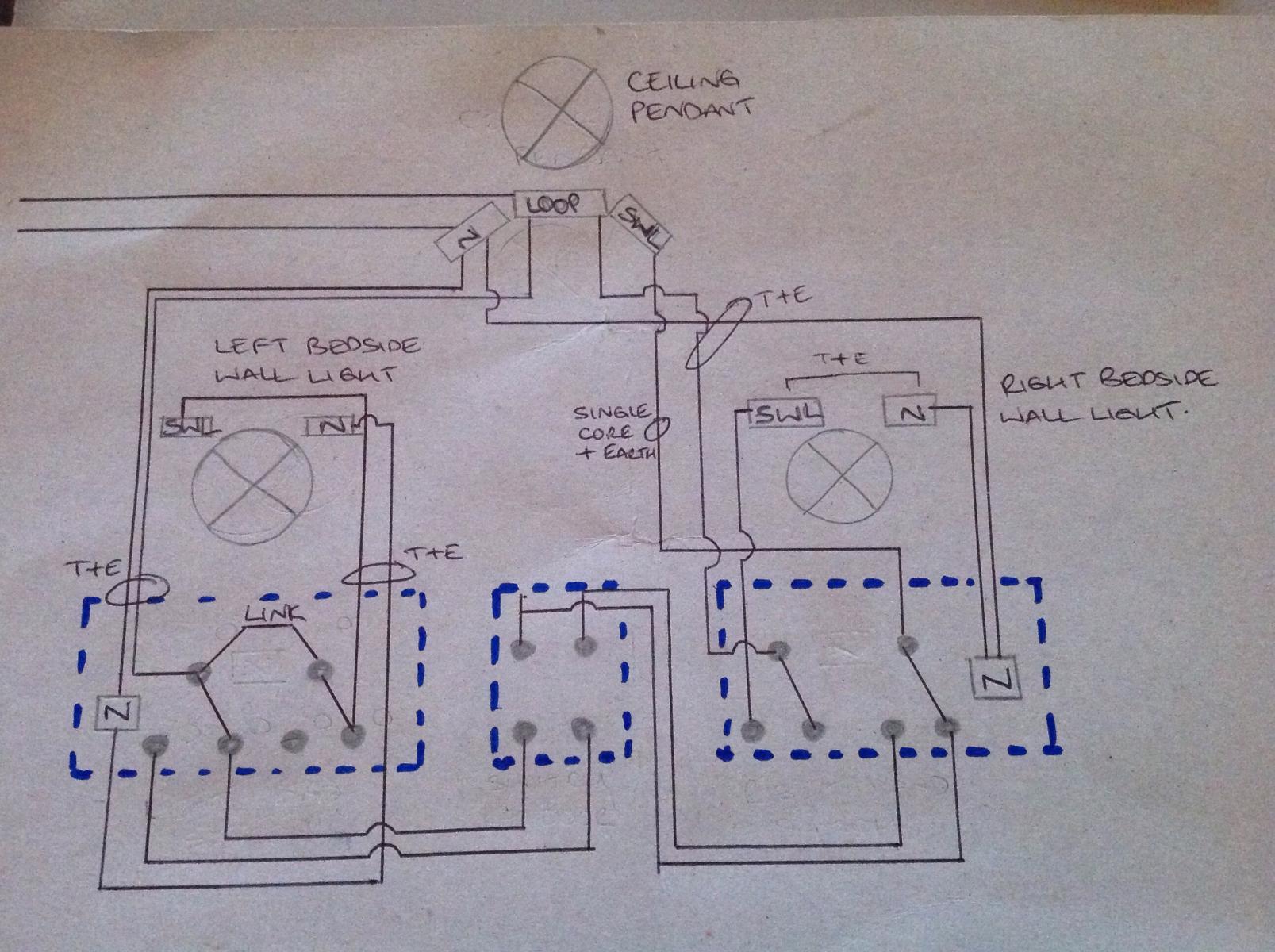

In our bedroom, I have installed a central pendant and two bedside lights. Switches either side of bed control their individual bedside light and central pendant. After boarding out, plaster, second fix, wife suggested that couldn't we switch each others bedside lights off too? Grrr, overlook on my behalf. Without too much disruption I pulled in two three core cables; switch to switch.
I've drawn a wiring diagram of what I've done minus the 2x 3 core cables. Will it be possible to switch each other's lights off? Hands up, it's beaten me, hopefully something simple I've overlooked, too embarrassed to ring my old lecturer, better to be faceless on here:rolleyes4::rolleyes4::rolleyes4:

Only need one 3c!
Switch 1:
common - brown
L1 - black and feed
L2 - grey and switch wire
Switch 2
Common - brown
L1 - black
L2 - grey and other switch wire
If you draw it out you'll get it
Forgot to state that I'd changed the 2 gang for 3 gang switches. Without drawing it out, I think I can see what I've done. :6:
