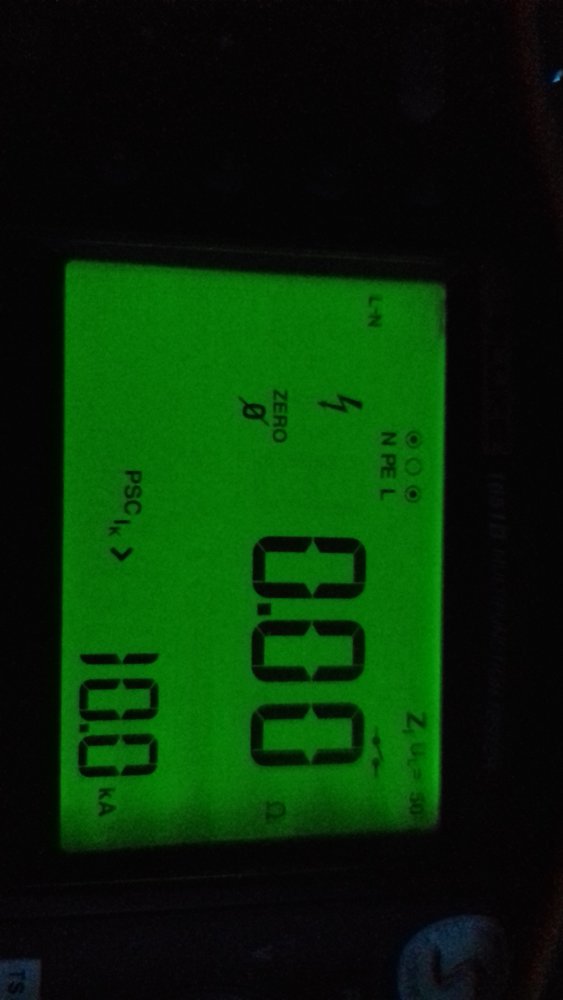

Hi all
i just sent my fluke tester off for calibration, and came back as a fault so needs sending off for fixing, now sods law i have my NICEIC assessment Thursday, so had to purchase the testers within my local wholesalers (as will take 10 days to get to get old ones back)
so i got the Di-LOG DL9118 MFT, seems ok but, having an issue with nulling the leads for live loop testing??
i can only find the option to null leads on continuity test
am i meant to calculate the lead resistance or dose it do it automatically
does anyone know?
thank you in advance, as i this i have warn google and tube out trying to answer this question

Hi Multimick, am i wrong in thinking that any additional resistance of my leads will effect the result of the ZS live test?
with the fluke tester always nulled the leads for both live and dead testing
however yesterday when i unpacked the tester i tested a very simple installation of a 2 way garage DB that feed 2 x DSO wired in 4mm T+E that was about 6inches away from the DB (via surface 20mm conduit)
at the DB i measured 0.75ohms , i then changed the leads to the plug lead and at the socket i got 0.66ohms
unless the metal clad sockets was picking up an earth from the wall ( which i guess could be possible, but guess the db fixed to the same wall would also pick the same )
so i put the results down to the leads giving different amount of resistance
am i wrong?
nothing to wory about in my opinion and if you explain this to your assesor he wil be impressed, any discrepancy of around 0.05 is due to leads ,meters probes ,slight oxidisation on copper etc etc . assesors are only human and your enthusiasum will show through , no need to null leads for live tests ,also remember live tests will vary constantly also rember it's Zdb at the consumer unit not Zs

If you're wrong, I am too. On my Fluke, I null my leads on EFLI setting with all probes touching the earth bar, and this takes about 0.11 ohms from the Ze result. The plug attachment needs nulling separately with the supplied thingy, if you still have it.
This gives the Zero symbol on the screen, separately to the Zerod continuity symbol.
As above, Fluke has this where you null leads for loop testing.
Megger does not.
However the newer Meggers (e.g. 1700 series) have an option in the settings to adust lead resistance. I think the default's something like 0.07 Ohms for a standard lead set, but this may need to be altered for fused leads etc.)
