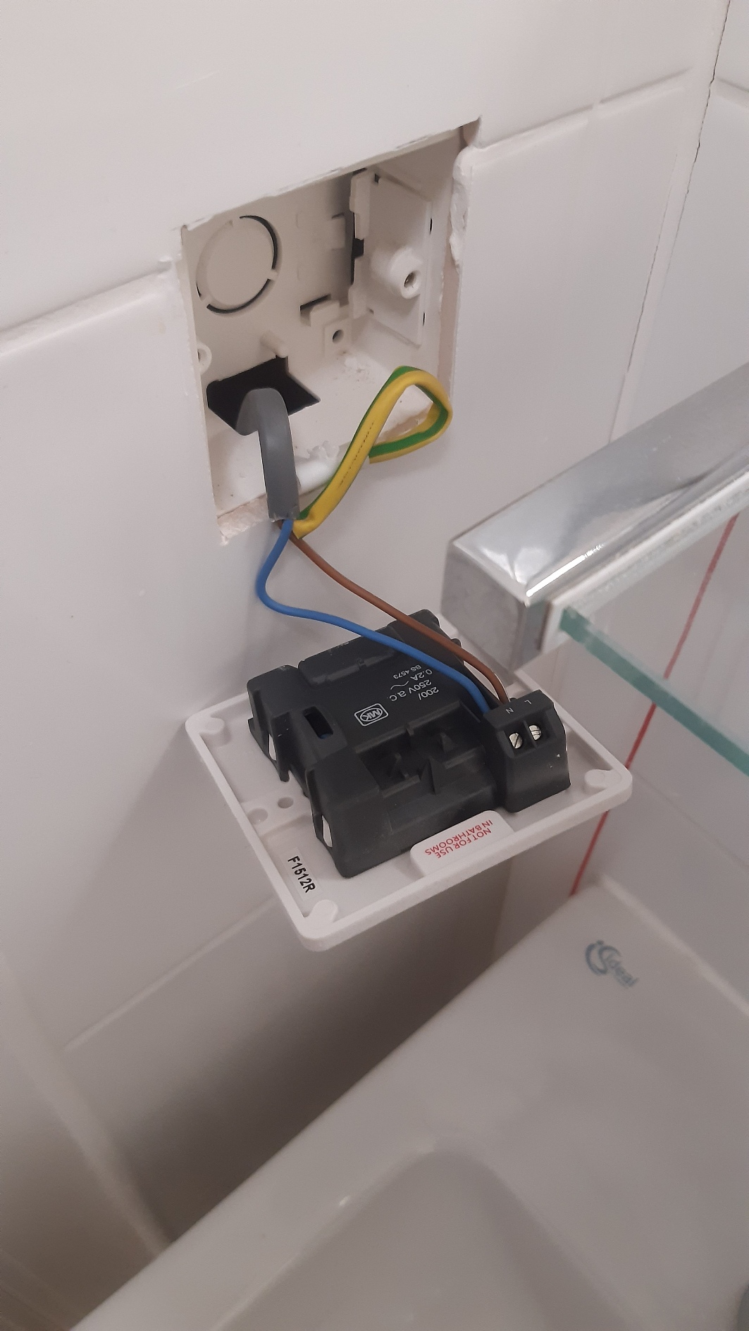

No cpc continuity to metal box with plastic switch by the sounds of it. Only a C3 according to most though! I always like to fit nylon screws if the customer can’t or wont rewire I must admit.
Best guess is the metal back box came live ( possible pinched live ) nothing earthed so , inturn making the fixing screws 240v
240v zap in the morning will wake you up ready for anything

That's what I was thinking. I generally avoid poking screws of electrical accessories while wet and butt naked just out of the bath though.
I had an iffy light switch in my office where the screws were live through earth leakage from led lighting. A cheepo multimeter measured about 0.008mA but it still lit a volt test screw driver and sparked when earthed. It might have been a similar occurrence.

The picture on the article shows a shaver socket... so was that where the fault was?
It wouldn't have been me, this is more my style, I use these. They are a lot cheaper than that bigger version with that big square metal thing in the back.

Which doesn't specify what counts as qualified though - would be interested to see if a Part P notification has been done..
Does also suggest that some of the issue was the existing installation - so maybe no RCD on that circuit, or cpc was used but not properly tested to see if it was connected.
However, if it really was the fixing screws, SparkyNinja, who's opinion I value, thinks that fixing screws aren't 'extraneous conductive parts' because of the small area exposed to touch, so that metal back boxes don't need to be earthed separately (though still good practise)
If it was a plastic back box, maybe the live ended up touching the screws because of the gap between tiles and the back box, since usually the screws are fully enclosed in plastic....
Which raises an interesting question - are tiles considered part of the 'enclosure' when they are thick and there is maybe 10mm gap between the front of the tiles accessory against the tiles and the front of the back box.

Despite this, when a second electrician came to fix the problem, he flagged multiple harmful issues - including the fact that live conductors were not made safe, and some were still live
Which could mean almost anything - but perhaps a circuit from the original room was just cut off and left in the wall, touching a back box? Or maybe that was just additional issues found when the installation was checked....
