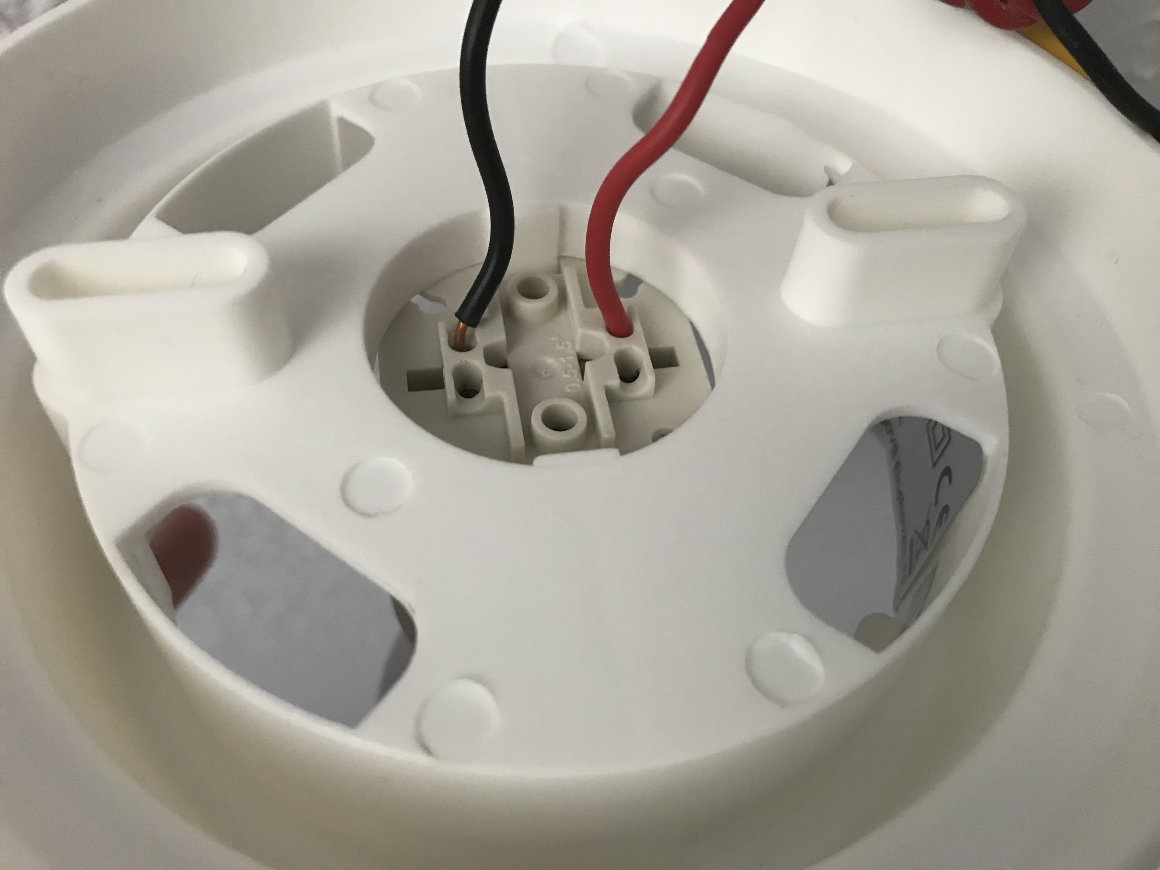

Hi to anyone who could help please,
In the below light fitting I have connected a single (red) wire to one side and a single neutral(black) wire on opposite side. There’s a spare black wire and three earth wires which I’ve connected to wago connectors. There are three spare reds which are isolated with tape that are not touched. When I turn the mains on the light comes on but cannot switch off. When I took the previous light fitting off the live, neutral and earth were connected correctly to respective terminals and could switch off fine. Why am I unable to turn off the light does anyone have an idea please
Thanks
Chris

Did you take a photograph of the old fitting, before disconnecting anything?
Hi,
Thanks for your reply yes I’ve attached below, there’s two black neutrals and a single red. With the new fitting I’ve used the same red and one of the blacks used a wago connector on the other. To be honest I’ve tried both blacks on their own and together in the new fitting and I have the same problem?

Probably the red in the fitting at the moment is a permanent live
The wiring connections seems to have been messed up by yourself
It would probably be a very simple job for a spark, so hopefully it may be not be too costly

What you have done here is create a very dangerous situation by disconnecting the outgoing neutral wire, this will lead to it becoming live and a number of light fittings in the property not working but having both connections live.
It would be best to get an electrician to fix this for you and I would advise switching off the lighting circuit until it is fixed.
