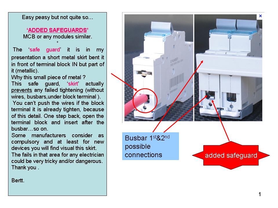

Hi all, scenario is , Fitted new dual rcd MK Cu today. Testing rcd one ( next to main sw) all fine. Rcd two doesn't trip on x1 at all ( mft says 310ms)it trips on x5 but high reading approx 30 ms. Have tested with no loads connected. Changed rcd same results! Swapped rcd 1 & 2 round , works fine next to main sw but same problem on other end ! Have triple checked all connections on everything but to no avail????? Any ideas lads ?? Help

At the second RCD because you tighten the screws but without wires or busbar inside you got this problem. The Cu busbar at IN of RCD remained behind of terminal block. Check properly the connections. Good luck.

Thanks burrt have tried that but cheers for reply

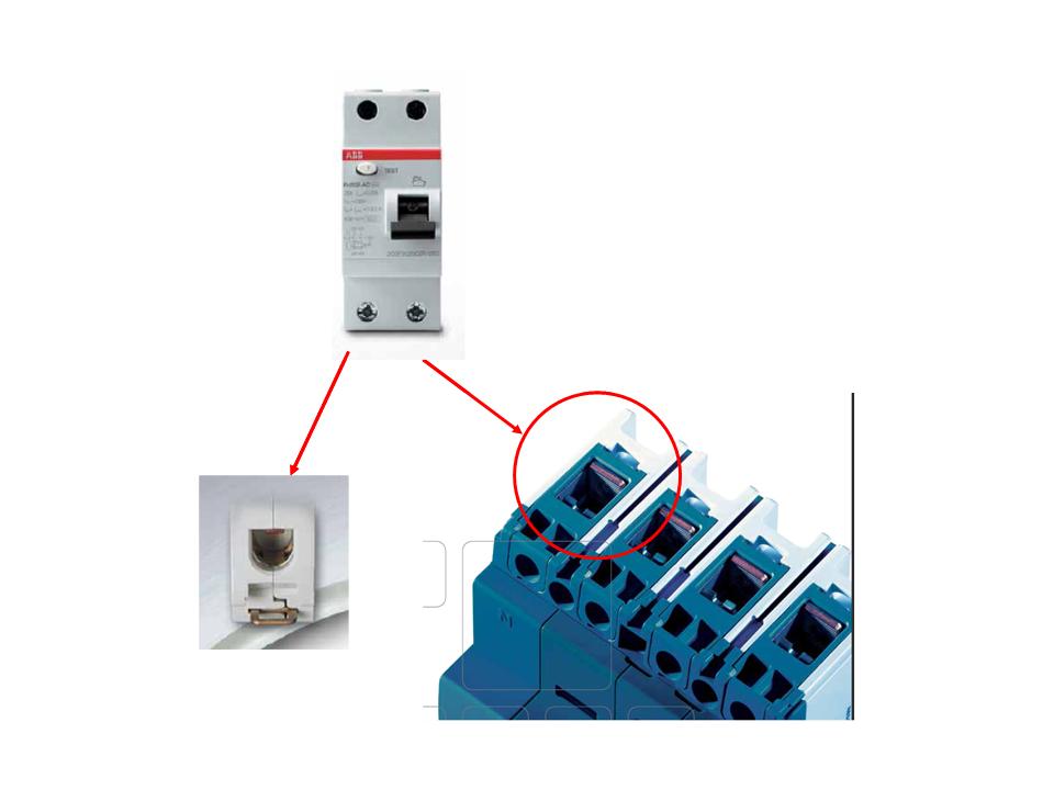

View attachment 17690Hi,
May be you already solved the problem.
Whatever, even if you triple checked all connections.

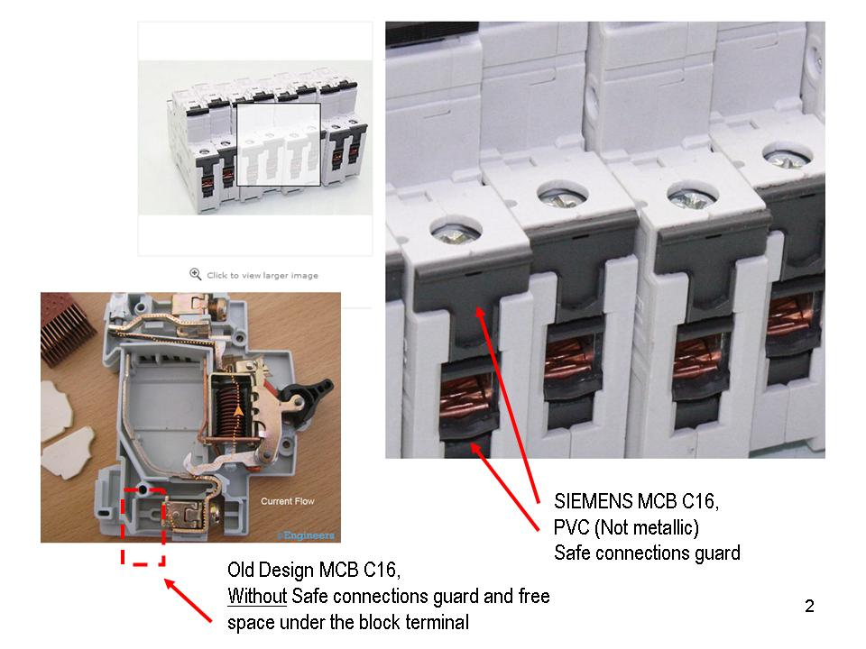

Hi,
Please see for update for MCB safe guard connections - new pics.
There are relatively often into electricians practice this mistake.
Thank you and sorry if I was too persistent.
