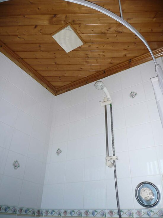

Hi All,
Please be gentle. It's my first post.
I want to replace a nearly 20 year old, but now noisy, Greenwood Airvac R90 bathroom extractor fan that is ceiling mounted almost directly above an over-bath shower (see attached photo). I am getting somewhat bogged down by all the regulations/restrictions so would greatly appreciate some advice on this.
The bathroom measures (w x l x h) 2.38m x 2.1m x 2.49m. This is, roughly, 12.45 cu. metres. The floor of the bath to the ceiling, where the fan is mounted, measures 2.31metres. The fan exhausts via around 2 metres of flexible 100mm ducting in the loft to a vertical through-the-roof vent.
As the ceiling height is above 2.25m, am I correct to say that the fan is outside zones 0 and 1 in the regulations? If so, are there any restrictions I need to be aware of when replacing the fan?
The Greenwood Airvac RF90 (rated IP44, 31 l/s) looks to be almost a like for like replacement. Would this, therefore, be a non-notifiable change?
Would it be a suitable fan in this position?
Even if it is a non-notifiable change would I still need some certification from a ‘suitably qualified electrician’?
The present R90 fan just operates via the humidistat. If I wanted to add a pull-chord switch so that the new RF90 fan could also be manually turned on, when desired, would this extra change then make it ‘notifiable’?

a like for like replacement just needs to be similar fan. does not have to be the same make/model. as such, no paperwork is required. adding a pull cord would be modifying the circuit and a minor works certificate completed by a competent person. strictly speaking this would be notifiable and a RCD fitted if not already in situ for the circuit.

Can you confirm that, as far as the regulations are concerned, that the fan is outside zones 0 and 1, as this will affect the fans that I can select?
As the shower head is not fixed does this have any relevance to the regulations and zones?
Could you also clarify what 'similar fan' would actually mean, in this context? Are all the alternative fans I suggested 'similar'. This sounds like it could be a little subjective, where some could argue they are similar but others don't agree.

any 4" fan that's suitable for the location will do. if it's above 2.25m from floor level, it's outside of zones. IP44 rating is what you should look for on the box. have a look at manrose and acel ( elec. center own brand ) for budget fans. make sure any fan you buy is suitable for ceiling mount. some are wall mount only.
You seem overly concerned with what is notifiable and what isn't. If, as you say, you are getting a spark in to do the job, then he or she will be able to take care of that side of things for you. Just choose wisely, don't get Bob from the pub to do it! ;)

So, (almost got my head around all this) if I went with the Greenwood Airvac RF90, just using the inbuilt humidistat (as is now), the fan could just be swapped over and job done. No notification required. No paperwork required. Not even an
Electrical Installation Certificate?
If I added a pull cord, for manual control as desired, then notification and certification required. Also an RCD would need to be fitted.
As the fan looks like it is presently fed via a fused link into the lighting circuit in the loft, will a new feed down to the fuse box be needed for this?
Looking at the suggested in-line fan up in the loft option….this would either need control from the bathroom light switch or from another pull cord, or even a separate humidistat unit. As all these options would be ‘modifying the circuit’ I presume they would require notification/certification?
yes on most points. to get round running cable from fuse board, a RCD FCU could be fitted to the bathroom lighting and fan.
