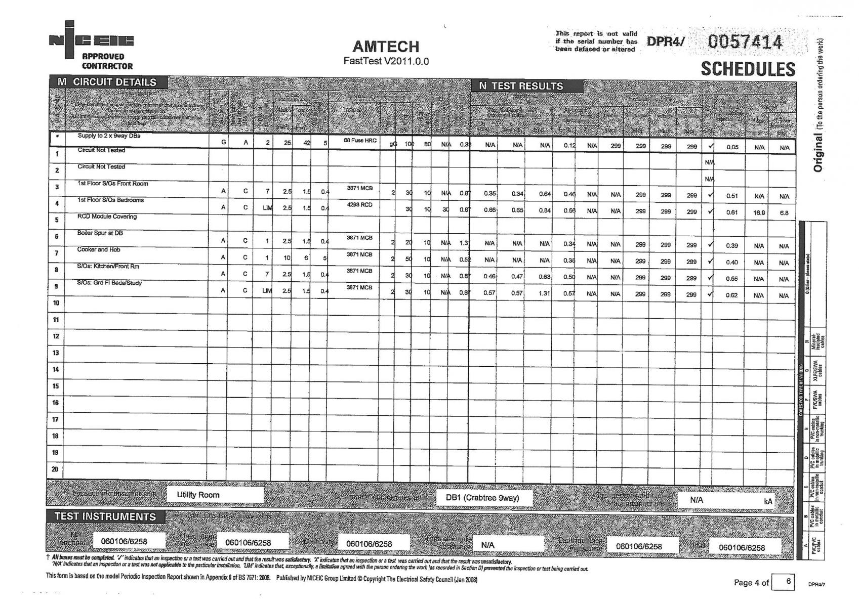

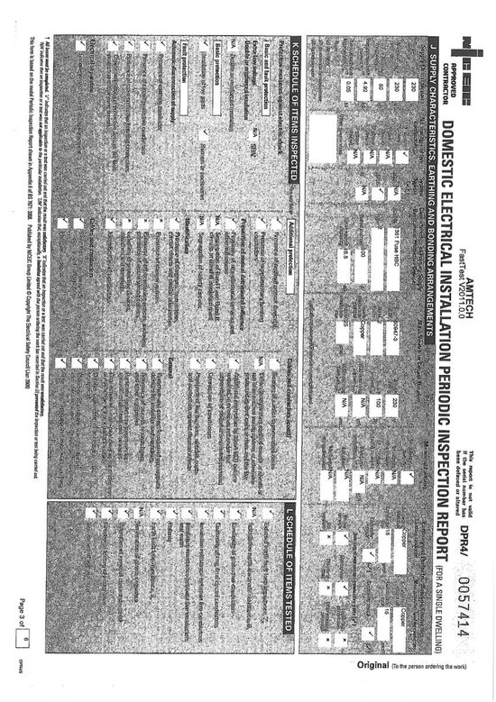

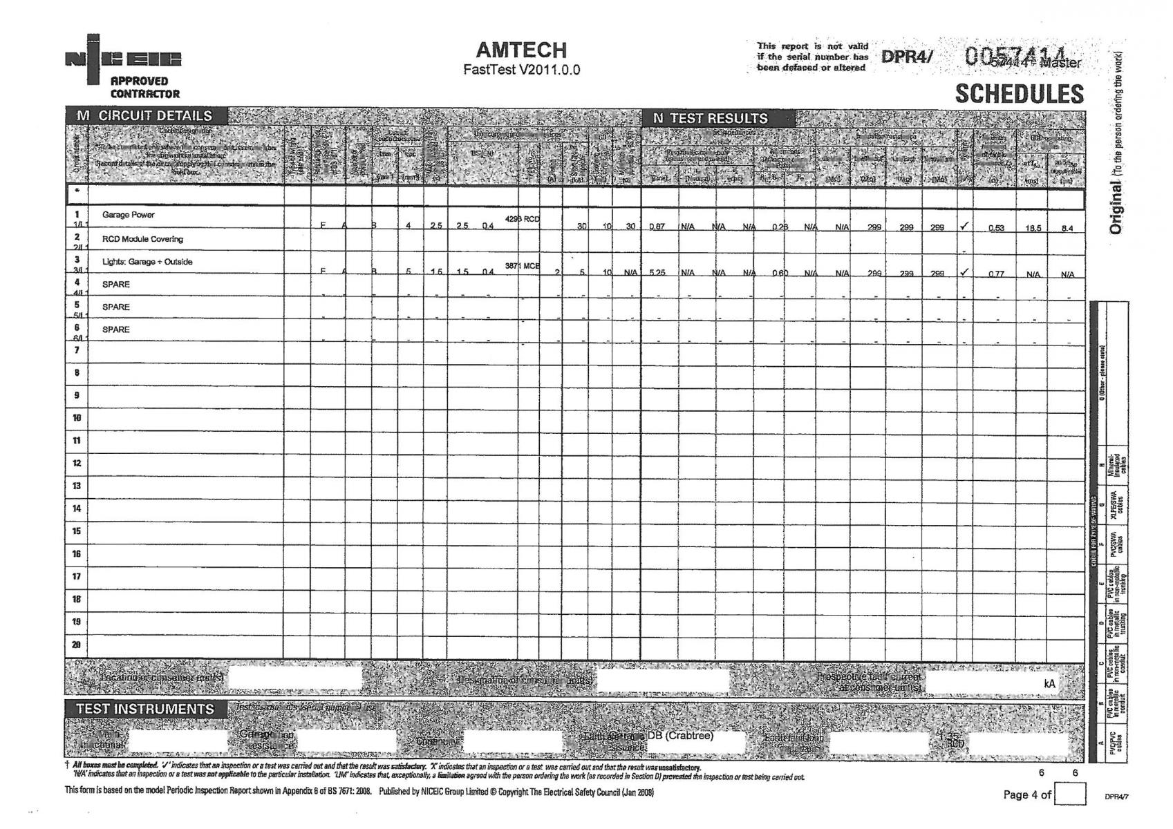

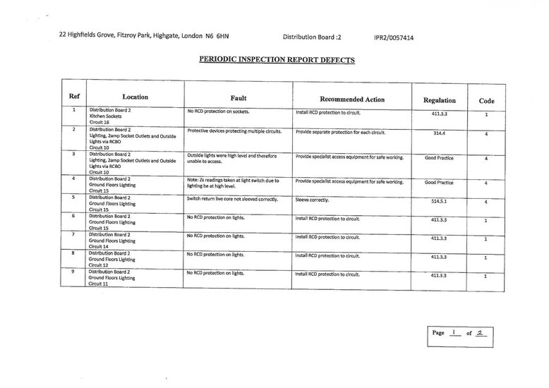

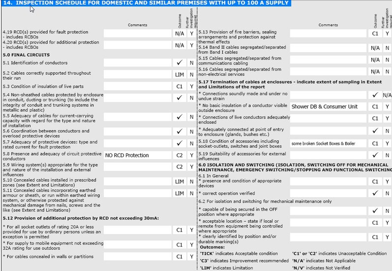

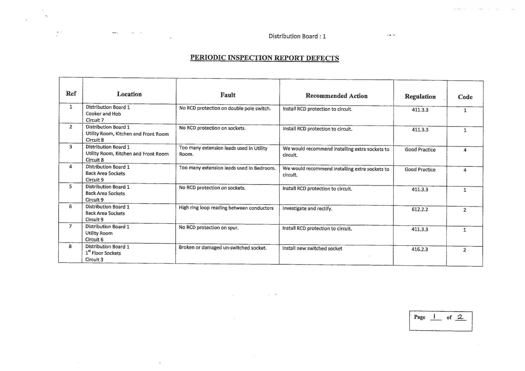

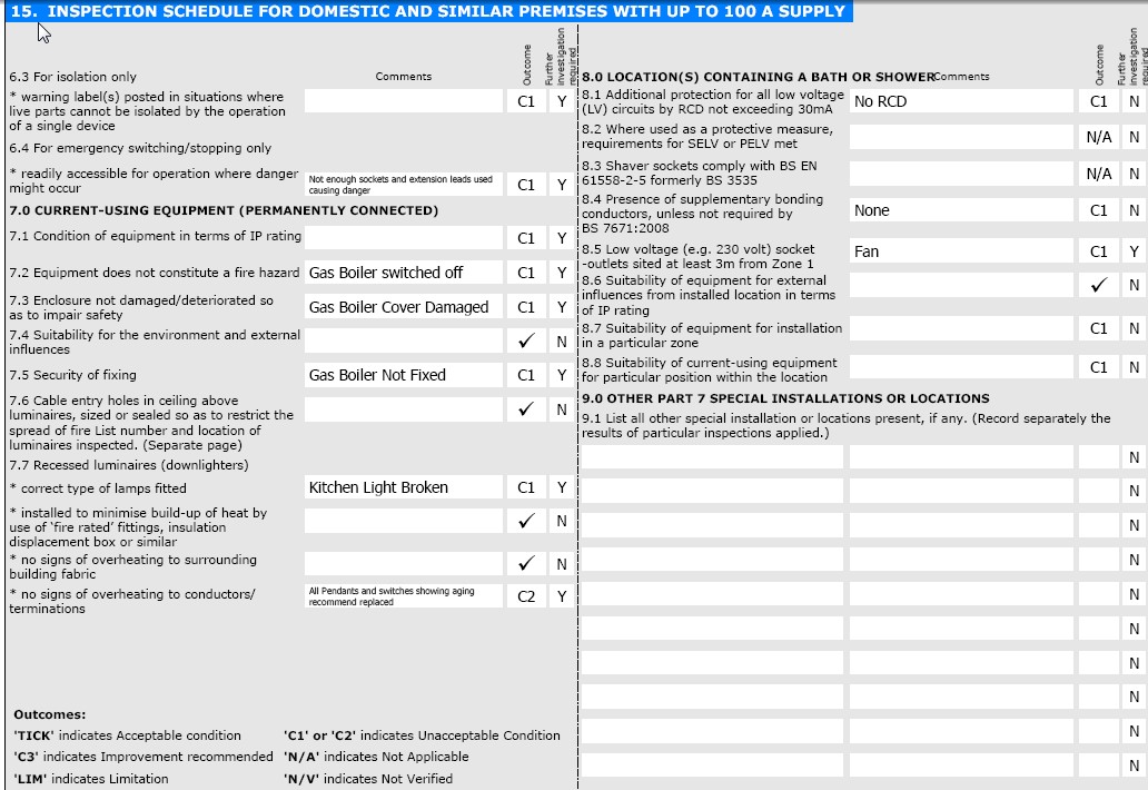

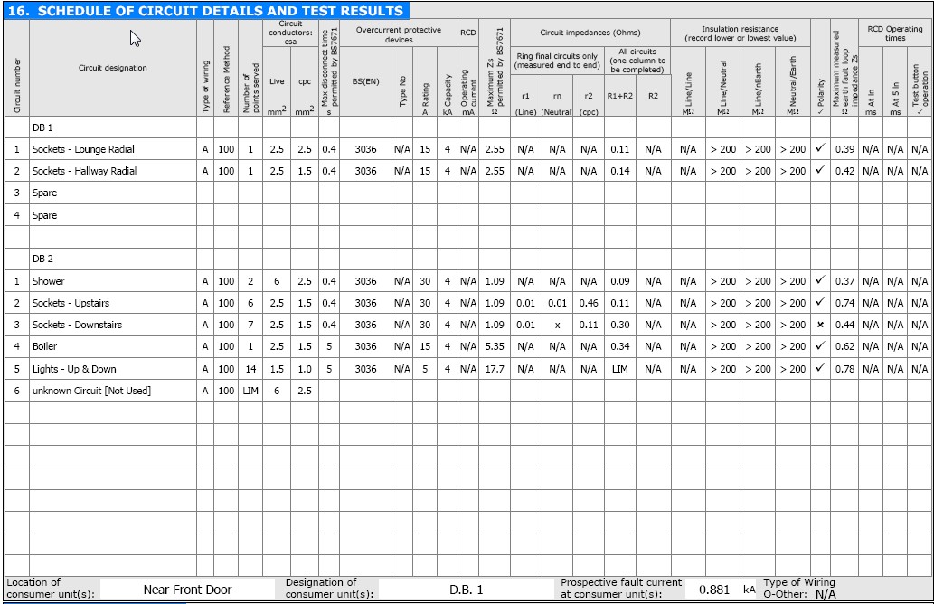

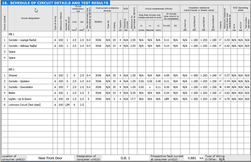

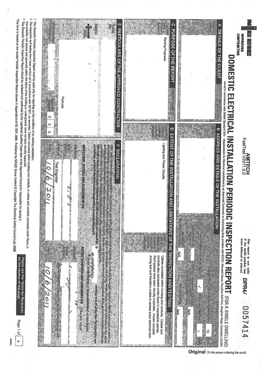

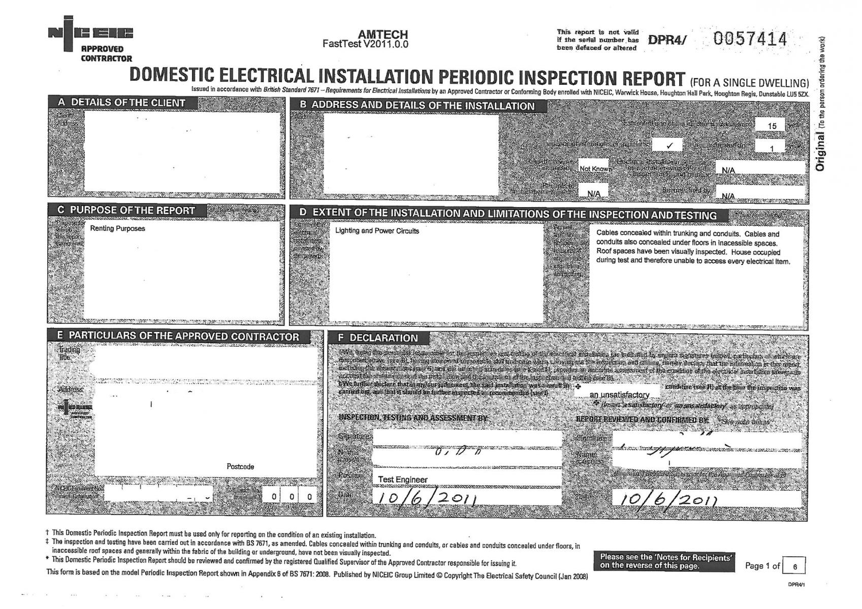

I've been asked to go and price a job based on an EICR that the client has had done. Some strange coding in my opinion but just wondering what you guys think?:thumbsup

Does not meet Redulations! a new Regulation of some sort? lol.
I suppose I better look over it properly.
Unidentified circuits put as Code 3 on observations but as Code 1 on Inspection, I could be here all day picking holes in this, blimey that is a badly filled report.
Reactions: 1 person

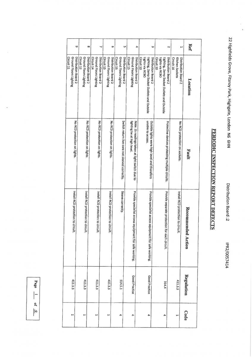

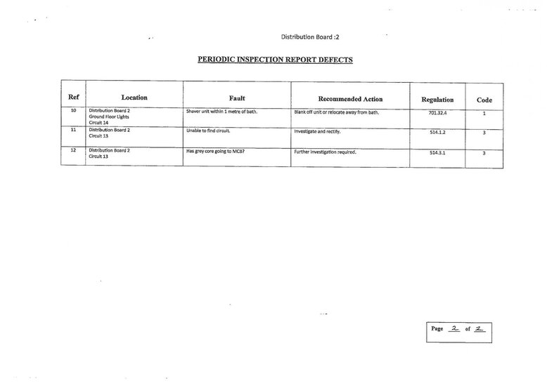

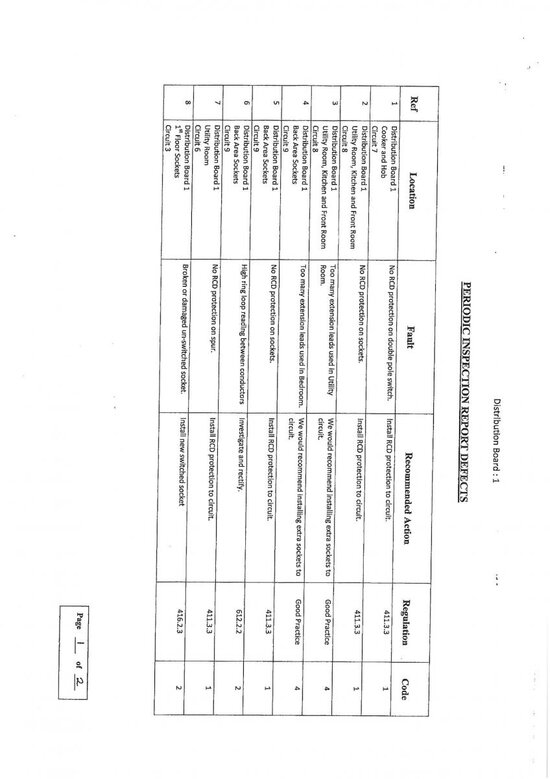

Hi all, just to jump on the bandwagon, have a look at this certificate and let me know your thoughts, was a customer of ours who had this report done as part of their rental agreement on a posh estate in Highgate, Same firm prob does about 50 houses on the same estate.

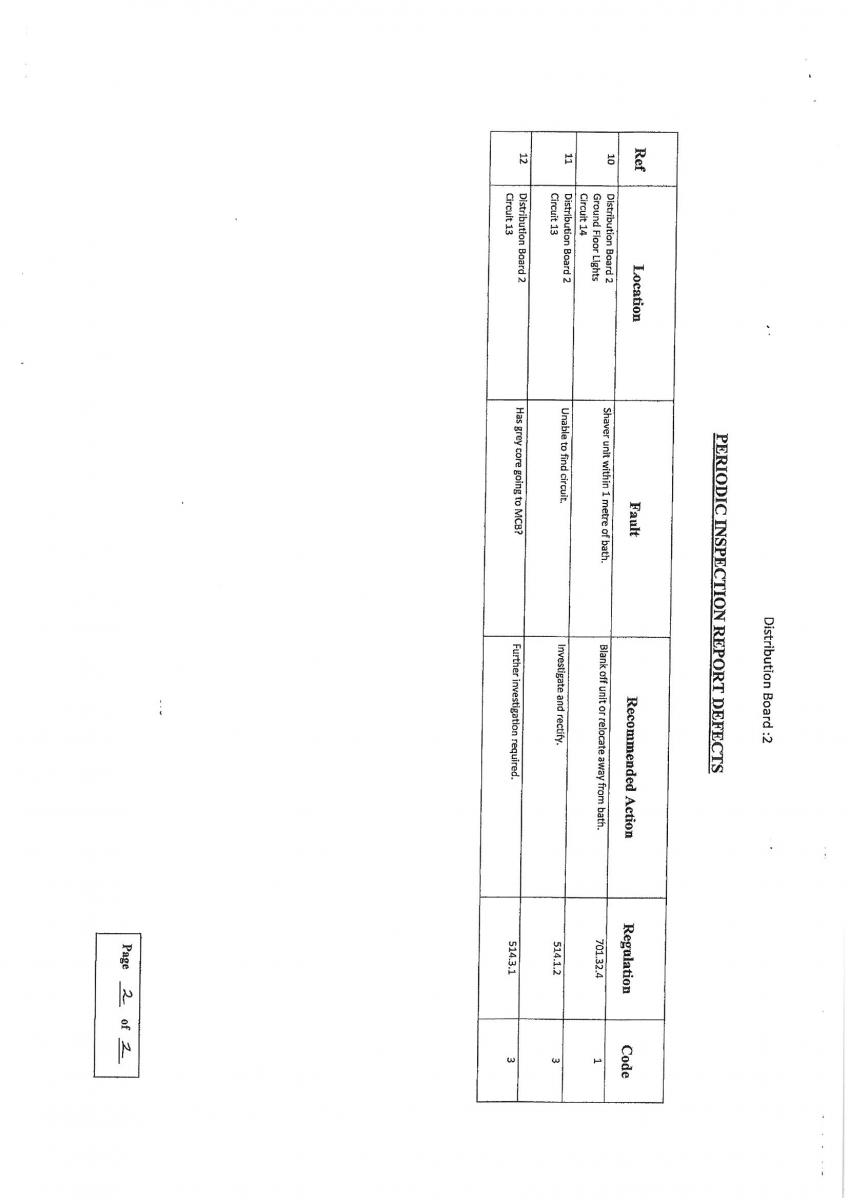

Totally agree.

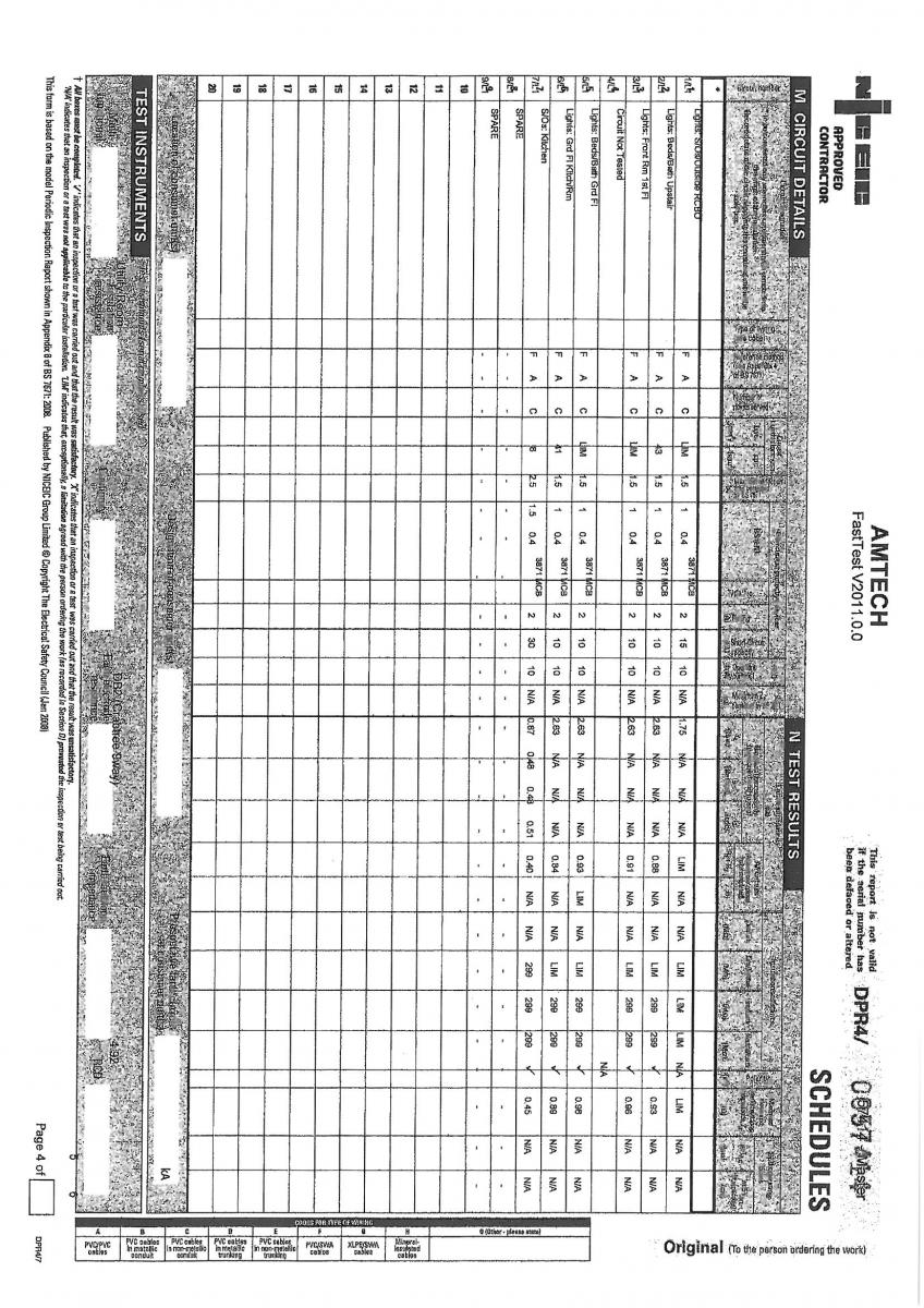

I only looked at the first page, it seems that whoever filled that report out needs to have a good read through the guidance notes for the codes. For example the "No RCD throughout installation" is down as a C1, or the C1 for the bathroom fan being 230v, the bit about needing a hammer and screwdriver (butcher!) to access the fuse board is a C3. To put it mildly the report is a load of nonsense, but probably contains some genuine (if incorrectly coded) issues.
The customer's not going to be happy about paying for another report though. I guess someone's going to get the ear bent, and hopefully reported to their scheme for being a muppet.

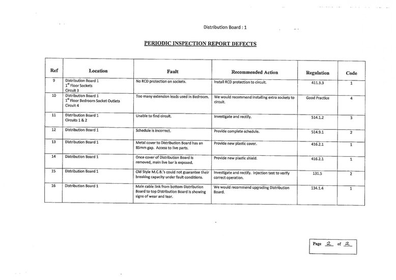

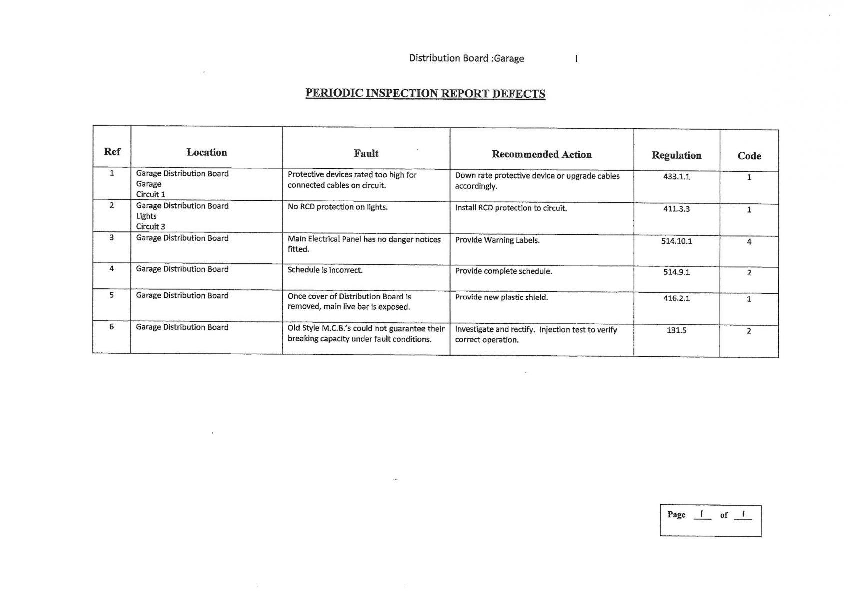

ADS on an old install ? Code 1's on a boiler cover, Code 1 for no rcd ? Identification of circuits Code 1 lol, Code 1 for cables concealed in walls ? Gas boiler not fixed Code 1 (must be a Gas Safe check too) Clip missing from a light Code 1, There's loads of crap on there. By the looks of it no one should be in the property with all that danger around. Someones looking for a nice wager by the looks of things

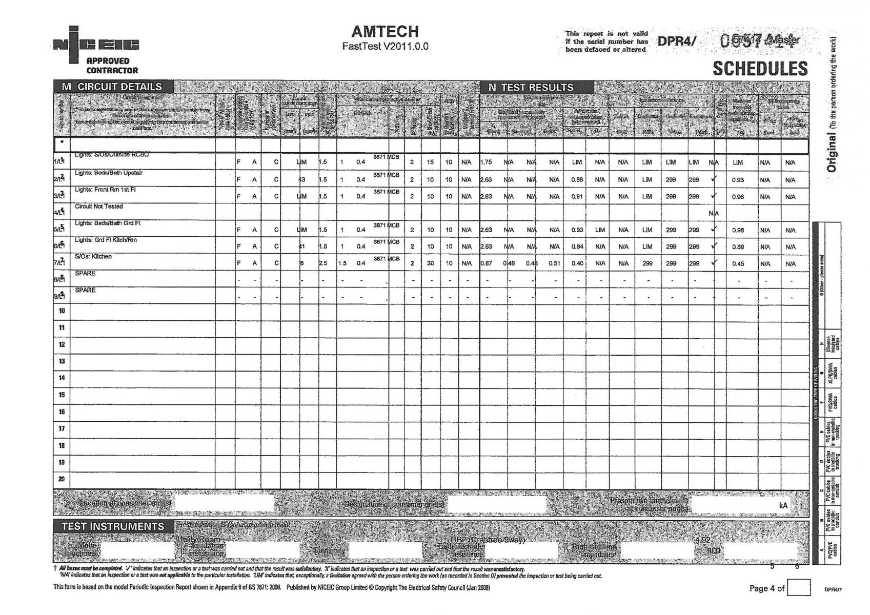

5s disonnection time for a 5/15 fuse ?
0.01 on end to ends ?
Throw that report in the bin
Whoever filled that in is clearly an idiot that needs to go back to school, learn english, then go and learn to be an electrician again!

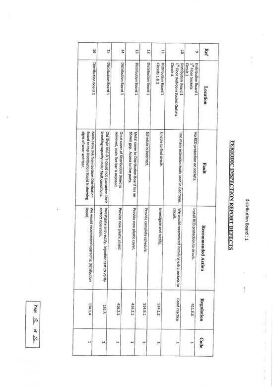

1short fairly poorly coded, written and explained EICR, looks like they may have done the testing at least but observations and tick boxes do not match up and codes are generally incorrect in my opinion.
A1G

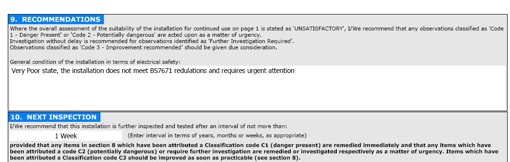

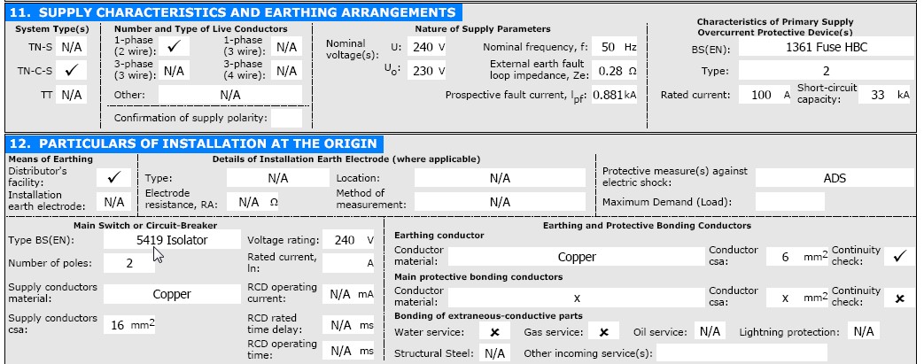

can't read a lot of the report because of the background but what I can read does seem OK at first glance, slightly surprised there is 16mm bonding but could be someone being keen. The defect sheet is not part of the report and should not be included as part of the report. recommendations should be in a cover letter, not in the report.
The statement old MCBs may not work and suggesting an injection test must be pure conjecture, surely.
Codes are a bit odd and recommendations are also sometimes strange.
Reactions: 1 person
Whilst I am sure there are some very valid observations I do not believe that I'm going to be rubber suited to walk in there which is almost the impression I get when reading the report.
I think the person who conducted the test needs to remind themselves why a code 1 would be issued and what needs to be done when reporting a code 1.

Yeah, but from what the report says, the EEB bit is missing from this install :willy_nilly:
On a serious note, I thought that the terminology had changed and that putting ADS was acceptable these days??
As far as I was aware EEBADS is still used in older systems as thats what they are

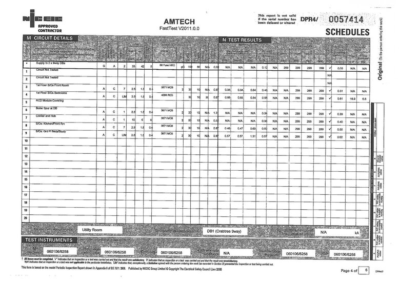

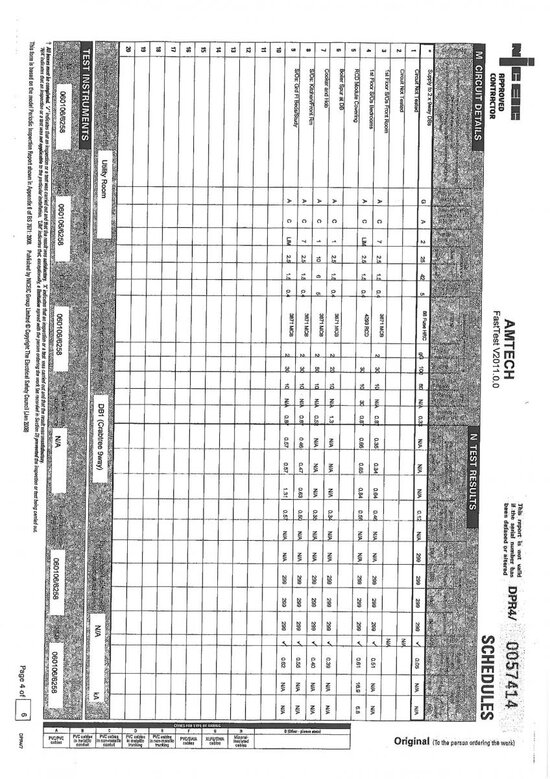

All I can say is that the socket ring ring circuits must be VERY short based on those readings!!
Also looks like the IR test was performed using only a 250v test???
If a 100% inspection & test is required and the 250v test indicates that there are no faults then why no quickly test at 500v?

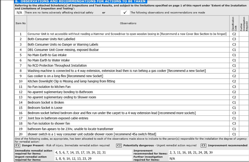

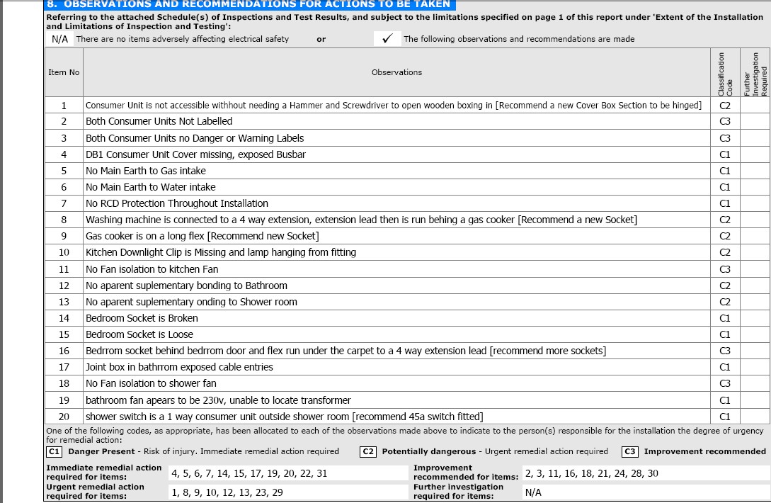

Since visiting the property I have added some of my own codes as a learning exercise.

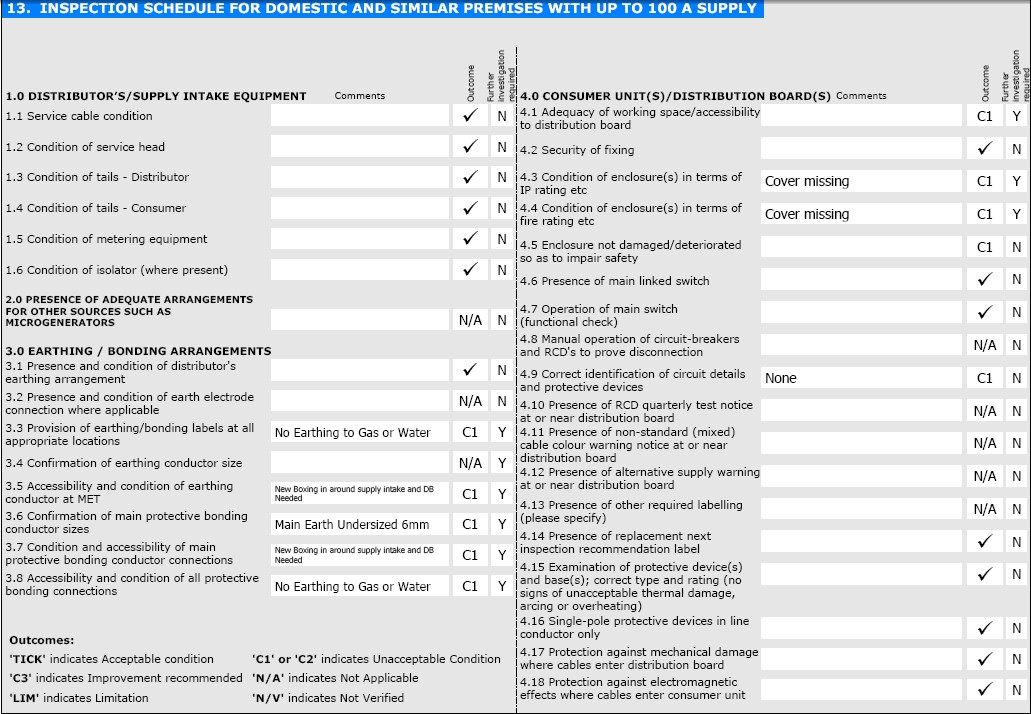

1SC
Consumer Unit is not accessible without needing a hammer and screwdriver to open wooden boxing in C2
C3
Both consumer units no danger or warning labels C3
C3
DB1 consumer unit cover missing, exposed busbar C1
I disagree. C1 = Immediate Danger I would use a C2 as the cu is contained within the boxing and only become dangerous if opening the door and sticking hand inside. Definitely unacceptable but not a C1 in my opinion.
No main Earth to Gas intake C1
No main Earth to water C1
C2 in my opinion
Washing machine is connected to a 4 way extension, extension lead then is run behind a gas cooker C2
C3
Gas cooker is on long flex C2
C3 - flex is under 2 metres in length. I would be more concerned that the flex travels up the side of the cooker and over the work top to the first available socket
Kitchen downlight clip is missing and lamp hanging from fitting C2
C3 - Lamp retaining clip not present, out of reach and no sufficient weight to warrant a code 2 (IMO)
No fan isolation in kitchen - C3
Kitchen is well lit during the daytime so can be isolated at the board for maintenance purposes - No code
No apparent Supplementary Bonding C2
Agree
No apparent Supplementary Bonding to shower room C2
Agree
Bedroom socket is broken C1
Bedroom socket back box cracked and holed C2 - you would have to stick your finger in the hole to get lucky
Bedroom socket loose?
I struggled to find this but believe it to be the same socket that is cracked and holed and would have listed it in the same observation.
Bedroom socket behind door and flex running under carpet to a 4 way extension lead C3
Now the leads are above the carpet running straight across the door lol Unplug it and no code ? :D
Joint box in bathroom exposed cable entries C1
Adaptable box not fitted with appropriate glands C2 or could it even be a code 3???
No fan isolation to shower fan C3
No windows so fan isolation required C3
Bathroom fan appears to be 230v unable to locate transformer C1
Banana split! 230v fan OUTSIDE OF ZONES! NO CODE. 2.4 metres from shower tray to fan OR 2.7 metres from floor to fan!
Shower switch is a 1 way consumer unit outside shower room (recommend 45A switch fitted) C1
My concern with this one is that the current mcb is fouling the bathroom door which could lead to damage to which could result in live parts becoming exposed but I still think it could only warrant a code 3???

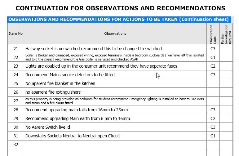

Hallway socket is unswitched recommend this to be changed to switched C3
Would this really warrant a code?
Boiler has been replaced so cannot comment - Location changed also

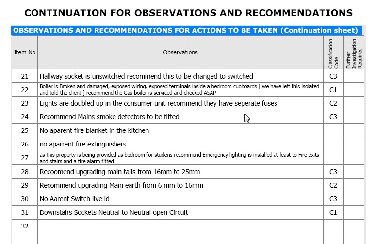

Lights are doubled up in the consumer unit they have separate fuses - C2
unable to comment
Recommend mains smoke detectors to be fitted C3
No code - Battery smokes fitted?
No apparent fire blanket
No apparent fire extinguishers
As this property is being provided for students recommend emergency lighting is installed
Should this type of thing be recorded in an EICR? perhaps a separate advisory sheet?
Recommended upgrading main tails C3
C3
Recommended upgrading main earth from 6mm to 16mm C2
C2
No apparent switch live ident C3
C3
Downstairs sockets neutral to Neutral open circuit C1
C2 if a C1 is awarded then it needs correcting there and then or the client is to be informed in writing. If it was a C1 then why was the circuit left in use? Bizarre.
This may of just been my old company policy but should'nt C1's be rectified there and then by you as it is an immediate danger? ie bare live cables, missing DB cover (obviously not this one because a tool is required to access it)
That is correct indeed, even I know that and I don't do them :)
The exposed busbar was within a boxing in section but did not require a tool although there is no reason to go in there other than if a fuse needed to be replaced but giving what I have just mentioned does it warrant a 1 as it is not directly on show?
