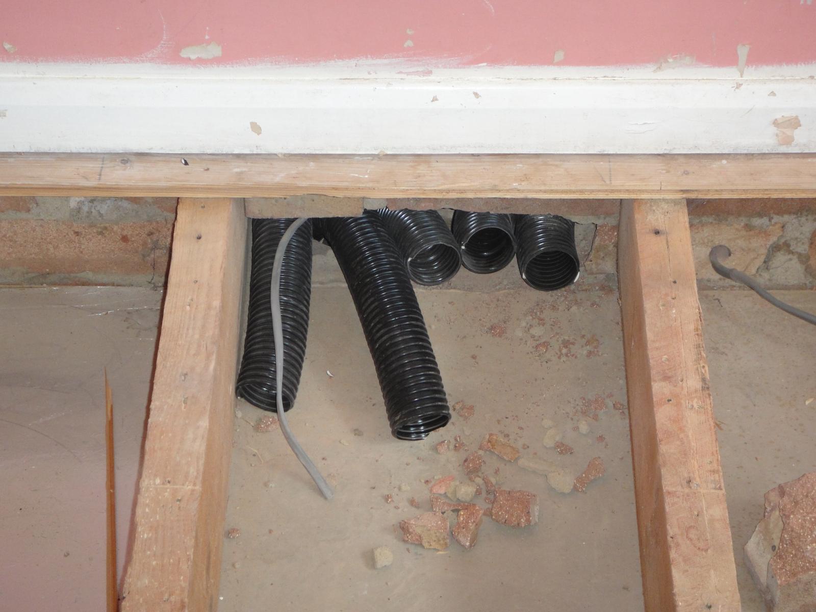

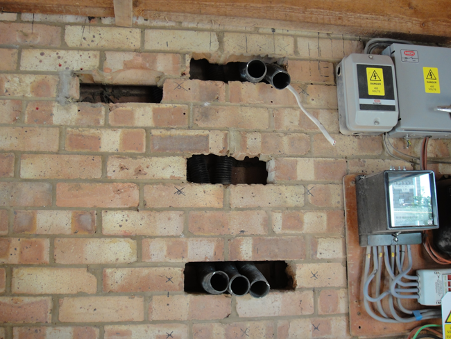

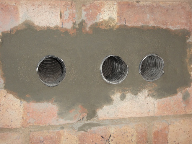

I have run cables in cavities, firstly I put a 50mm pipe, well five of them actually up from the garage to the first floor (about 3 ft) then cemented them into the wall neatly to mount the board on top.

See the pics below to see what I did, like I say, that's 50mm pipe, it was a pig and a half getting it in the cavity though. Oh i got the pipe from the garden center. The holes in the joists were already there by the way, i didn't drill them like that!
