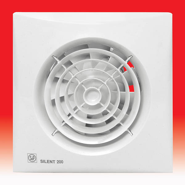

Have a look at this one as an example. The stat is built in.
Silent 200 CHZ Extractor Fan with Shutter & Humidistat - https://www.tlc-direct.co.uk/Products/SLS200CHZ.html
