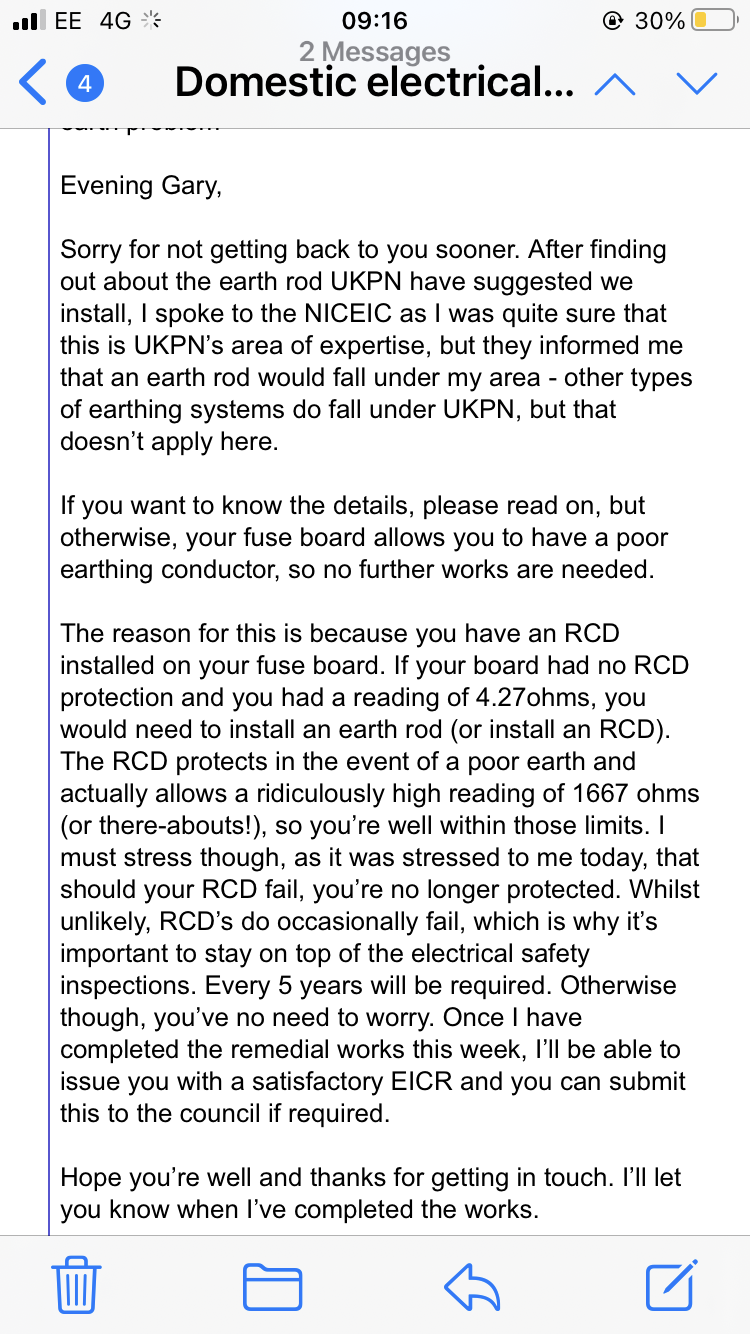

After a lot of discussions, all landlords have got their act together and I have permission to install a TT system tomorrow morning. I'll connect the flat I was working on and then they can decide if they want me to do their connections. Although I will insist on an EICR at the same time since their existing EICRs are clearly worthless.
Will update once I hear from NICEIC!
It might be worth also reporting it to Trading Standards, see this thread:
So was back at the property today (yes, Sunday). Sunk an earth rod and got a reading of 14.2 which I must admit surprised me. Power is back on for the property I was working on. Two flats have turned the power back on themselves but want me to do an EICR and connect their earth. The fourth flat, well I've not heard anything from them yet and the tenant is currently staying in a hotel.

So I've just sent off a complaint to the NICEIC (they are listed as a domestic installer) concerning the EICR that was issued for the property I was working on. I've attached the EICR (Ze included) they issued and the UKPN notification that the property has no earth. I will update you when I get a response.
I am in the process of getting the details for the other property.
Btw NICEIC don't make it easy to complain, do they? Download and fill out a PDF that then has to be emailed to a specific address. Why not you know... just have an online complaints form?
Unless they are approved for PRS - eicrs then the domestic installer scheme doesnt cover EICRS, so they may turn around out say its outside of the scope or the work they are approved for, nothing to do with us... however if they put the NICEIC logo on the certs or have been completely daft then you might find the NICEIC do take action as there has been a change of late where they do take action. if you say which area they are in somebody on here will likely know which assessor covers that area you might then get somewhere.
I would be more inclined to go to trading standards as its fraud and illegal trading etc... a spark recently got prosecuted and find for doing a drive by EICR on a house pre purchase. it was trading standards who took him to court
So I have a response from the NICEIC:
