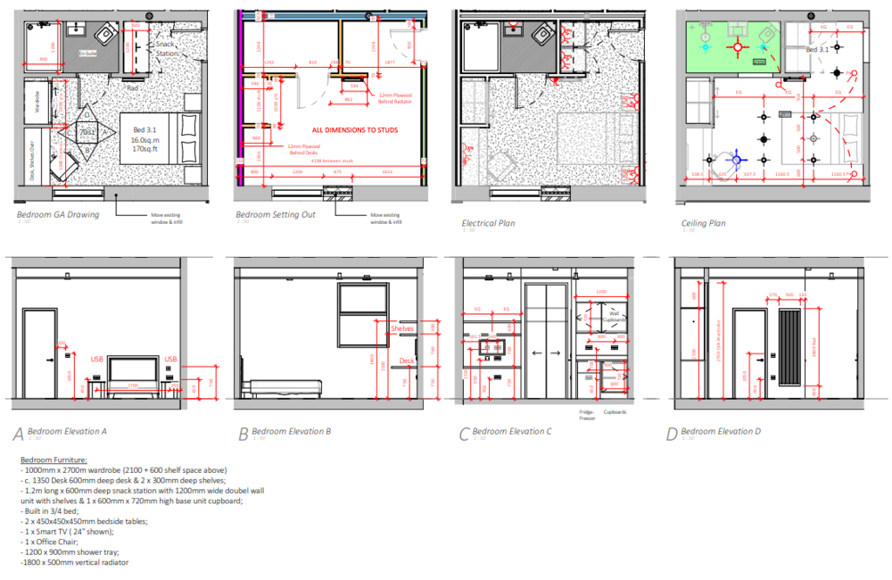

Evening All,
We have received the calculated loads for the 9 bed HMO, which were advised as 68kW, 86kVA.
The utility provider has returned comments stating this is unusually high, giving the table attached as previous examples.
I wonder whether the issue is with the specification of each bedroom as having a 4.4 kW allowance, which may align more to a standard 1 bed flat, than an HMO bedroom?
Thoughts welcome.
Best Regards,
Pete

Agreed - 4.4kW/room is nuts, assuming no electric heating. Looking back at your OP, it sounds like each room only needs a few hundred W.
I'm assuming the ASHP is providing heating ?
Thank you Simon,
I am now a bit stuck, the electrical designer has noted c. 3kW per bedroom, reducing the overall load to 51kW c. 64kVA. for all 9 bedrooms plus common areas.
The supplier has noted this would typically power 45-50 standard homes (there are 3 x 9 bed HMOs)
Every HMO bedroom has the same electrical load/requirements, see the below typical layout.
The electrical requirements are:
There are no other electrical provisions, no electrical radiators (all heating and hot water are via the ASHP, including the shower), no kitchens, etc.
Strikes me as still over provided, but then I am by far away not an expert.
What do you think would be a reasonable provision per bedroom for the above and below, with tolerance?
3kW per room seems OK to my mind, possibly a little on the high side but not drastically.
However you can't just take 3kW and multiply it by 9 for 9 rooms, you need to apply diversity to this figure.
The electricity suppliers use diversity factors to arrive at the admd (after diversity maximum demand) figures in the table you posted earlier.
It's important to note that the admd is not the maximum capacity of the supply, it is more of an average considered over a large number of supplies.
https://business.currys.co.uk/catalogue/item/B128685B
Average probably under 100W
Smart TV;
Allow up to 300W
c. 7 sockets for laptop/PC, hoover, fans, perhaps a toaster, etc;
Excluding the toaster, say 500W max
Shaver socket to the en-suite
Not worth counting
c. 2-3 LEDs to the bathroom
c. 6-8 LED lights, per bedroom;
If all on, maybe 100W - and the occupant will need dark glasses :cool:
So without considering diversity, that's around 1kW per room - say 2kW with the toaster. As Davesparks says, you then need to apply some diversity - will everyone fire up a hoover at the same time, will everyone have a toaster and fire them up at the same time ? Even if everyone has toast for breakfast, each toaster will only be running for a few minutes and unlikely to be at the same time.
TBH I have no idea how you'd work out the diversity for that sort of property, but in my mind I reckon you'd struggle to sustain over 10kW between the 9 rooms. Might peak over that for short periods (minutes), but definitely not sustain it.
Allow up to 300W
Not worth counting
