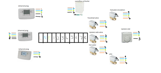

Please have a look at this and tell me what you think, I ain't 100% on the underfloor heating valve as that will be connecting into a manifold so maybe needs tweaked.
Well that won't work,and it's not very easy to understand.
Draw a circuit diagram and it should become a bit easier to get right.
You need to start with understanding what each component is and how it works electrically, and then understand how to achieve the control functions you require.
Just matching up colours and numbers won't get you anywhere.
This is true Dave as if there is a fault or problem you can diagnose it.

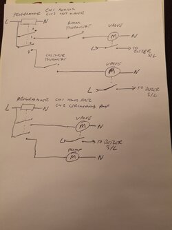

Draw the circuit rather than pictures with colours and numbers that don't show what is happening electrically. If it's easier break it down in to the simplest level of what is actually happening.
The motorised valves behave electrically the same as a simple relay and everything else is either switches or a load.
To start with ignore the additional lives and neutrals required for various electronics, just focus on the actual control circuits.
So the programmer is just a switch, thermostats are again a switch and valves are relays.
Pumps, the boiler etc are just loads (you could even represent these as lamps if you wish)
Take one channel at a time and work out which switches need to operate which load and in what combination.
So for the central heating you would have a permanent live to the first switch (programmer) the output from this switch feeds the second switch (thermostat) this then operates a relay (valve)
The relay output is connected to permanent live so that it switches on a load (boiler) when energised.
The hot water is the same.
The towel rails don't have a thermostat so the programmer operates the really directly.
The hot water circulating pump will be switched directly by the programmer so it is just one switch directly operating that load.
The underfloor heating we don't know for certain yet without details so assume for the moment it is the same as the central heating.
Now you should have a circuit for the actual controls, you can add the other bits like permanent live to the boiler, neutral to the room stat and programmer.

How on earth would you learn how the circuit works, install or fault find from the pictures and numbers approach?
I appreciate my sketch is not the clearest, but it still makes more electrical sense

Thank you all for the feedback.
The way I chose to go about the diagram was in a simple form which I understood. Drawing it out would probably of been worse as I don’t know all the symbols.
Where did I go wrong with my diagram?

As far as I am aware, oil boilers don't modulate, so it is a simply on/off control. Basic idea is thermostat opens a motorised valve then all motorised valves have a micro switch in parallel to power boiler, so any motorised valve opening will fire boiler.
This is the whole idea of the S plan.
Not sure why you need a programmer other than maybe for DHW, I personally would use programmable thermostats, that way no need for a frost stat.
Towel rail and DHW normally combined together that way the return water is cooler so boiler does not cycle as much, and a thermostat on the tank will normally run enough times in the day to dry towels, it may not heat the bathroom enough but that's not what a towel rail is for.

Can you answer my question in post 6.
Also post 9- you need all the info of the plumber before you can finish the schematics.
From your diagram I think you’ve grasped the basics, but above information is needed.
Thank you both for the replies
Your correct, that should of been connected to 6. Rather than 7.
In regards for the UFH it has programmable stats to each zone. I didn’t get much of a look at the kit, but it comes with a controlled wiring centre.
As far as I’m concerned as long as the plumber has okayed everything on his side and that is all the equipment in use you’ve about got it.
But I think there should be a few more thermostats, whether room cylinder or safety included in this schematic.
