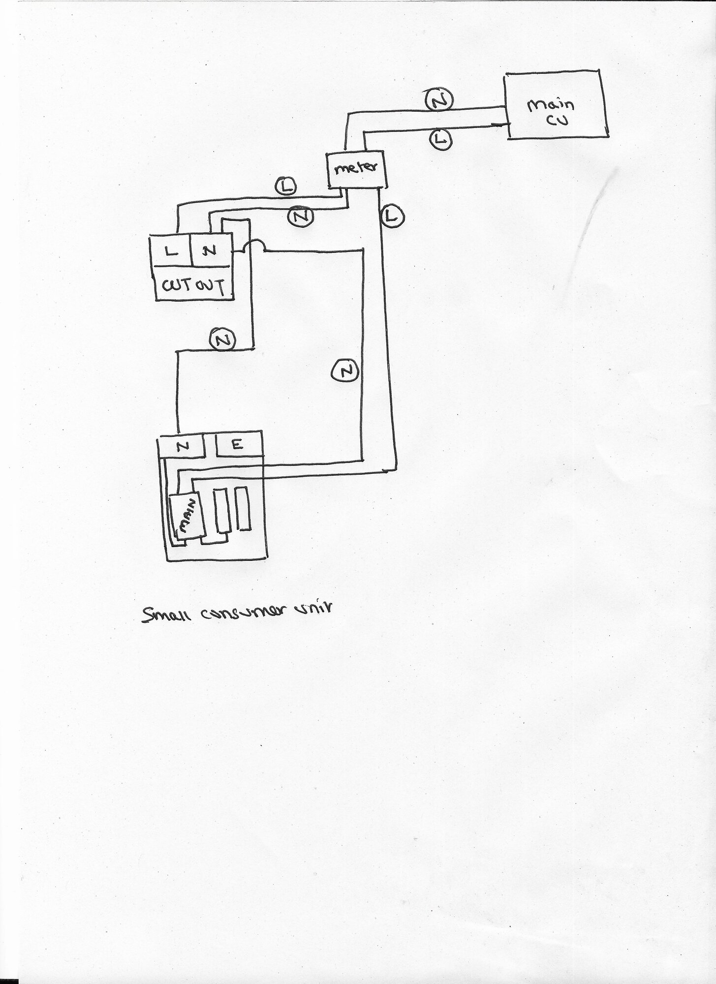

I have just (kind of) completed an EICR. It was the worst house I have ever been in. They are horders plus the house was filthy. I was unable to get to certain areas.
I realise there are a number of fails (c2's) with the picture but my question is regarding the 2 x 10mm tails coming out of the cutout and going to 2 way consumer unit. They are both neutrals.
One of these goes to the neutral bar in the consumer unit and one goes to the main switch in the small CU.
I haven't seen a neutral go straight from the cutout to CU before. From looking on line it seems that this is ok. Is it? The one neutral going straight to the neutral bar means the main switch is not isolating the neutral. I feel this should just be removed? Pictures below..
