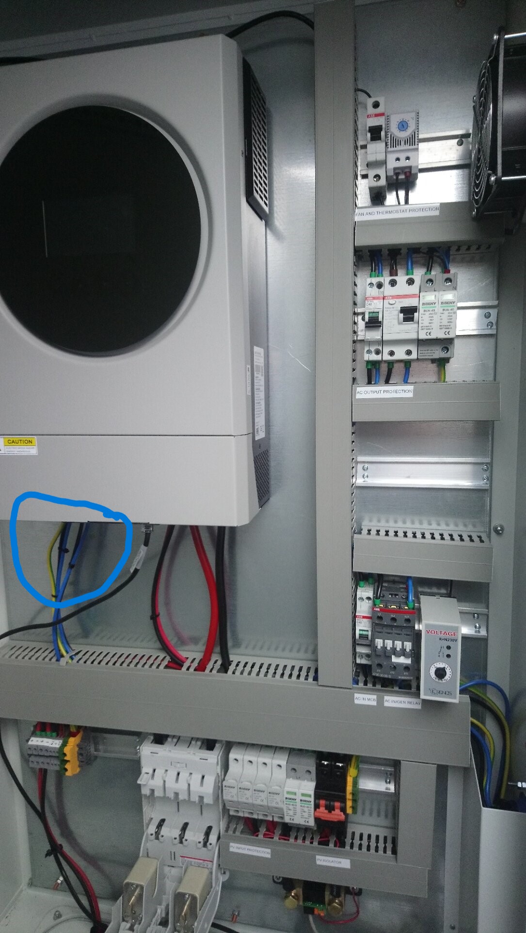

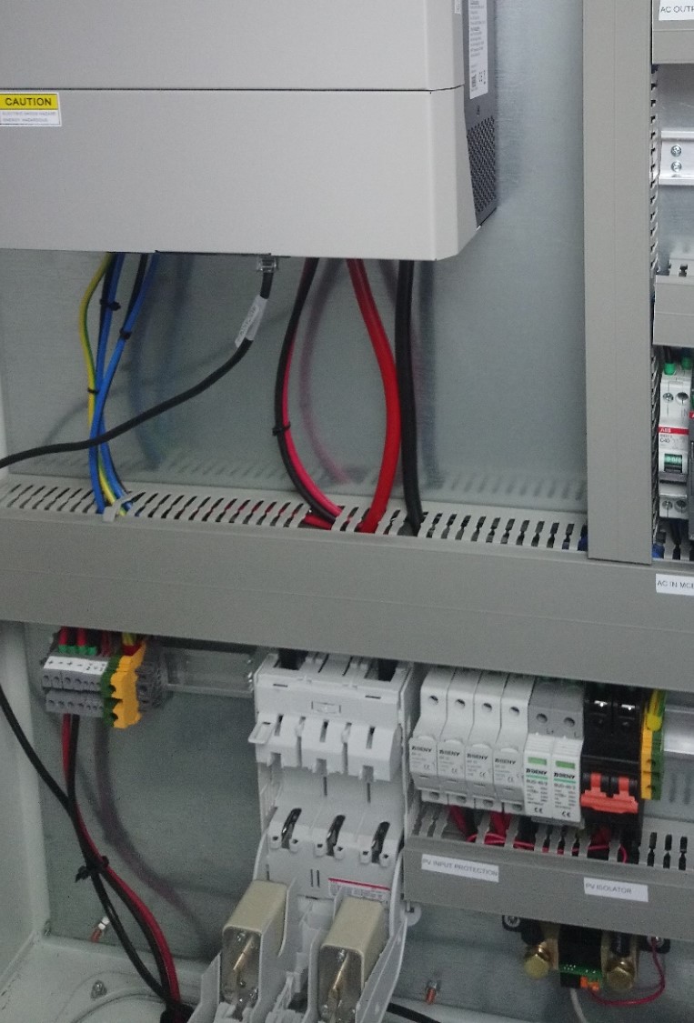

Hello Marconi
The issue with the pv input is this.
When I measure the pv input from the roof at the point it connects into the cabinet input connections (lower left in picture) I get the expected 253 vdc.
When the inverter is switched on but the isolator in the cabinet is off (lower right in picture), the voltage from the pv remains constant, when I then turn on the isolator in the cabinet for the pv, the voltage goes up to between 350 and 450 vdc.
When this happened I then isolated the pv supply using the external isolator I have fitted before the cabinet. Which effectively removes any input to the inverter from the pv, I then measured the voltage at the input connection to the cabinet and found the 100 to 200 vdc appearing at the input of the pv in the cabinet. If I turn off the isolator in the cabinet the voltage drops to zero, this led me to conclude that the dc voltage was coming from the inverter out through the input terminals in the cabinet.
Now I have no idea of how this is possible as this would indicate that the inverter is working totally incorrectly or that the inverter is somehow sending power to the point it is supposed to be taking it in.
When the inverter is on and working it only shows 252 vdc input from the pv (see Right hand pic) on the front panel of the inverter and it was not until I re measured the voltages of all of the terminals in the cabinet whilst trying to find any indication of what may be causing the problems I am having I discovered this issue.
I am somewhat concerned that this may be down to a wiring issue in the cabinet or the inverter but it is difficult to determine which without removing more wiring. Perhaps when I come to remove the inverter this weekend I will measure the voltage at the input connection to the actual inverter with all wiring removed to see if it is as above, when there are no other routes for the voltage from the inverter itself.
Feel free to ask for more information if this is required
Many thanks as ever and Regards
Tonyboy
View attachment 106299 View attachment 106300

Good Morning Marconi
I have carried out the requested tests. Multi- meter set on 200ohms lowest setting.
Measured between N and E on output terminals reading was 00.2 not very high.
The measurement between the two cables with output mcb on and output rcd off, no reading at all just the decimal point.
Set up the inverter to charge from the AC input but I have left the PV isolated as I am still not sure if the readings at the input terminals are an issue.
Timer came to start and ac started charging the batteries at 10 amps (I have set this limit), mains in house not tripped and still charging as I type.
Not sure why there is no reading on the two cables (black and Blue) as the meter is showing 00.1 when I touch the terminals together as a test.
I am going to let the inverter charge the batteries for the period I have set to see if it keeps going.
I hope the results are able to help and I look forward to hearing what you think is needed next.

These readings indicate the output N-E link is inside the Axpert box.

Did axpert box enter bypass mode while charging battery from mains? If not sure send me picture of display.

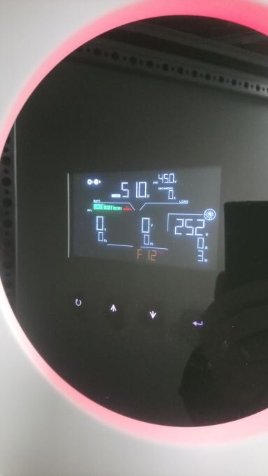

Hello Marconi
have attached this, currently not charging as batteries are nearly full.
Regards
Tonyboy
Axpert Inverter - Who has stock - Page 5 - https://www.4x4community.co.za/forum/showthread.php/223750-Axpert-Inverter-Who-has-stock/page5
My train journey was spent trawling the internet for solar leccy using an axpert box exhibiting up front rcd trips when the box connects output LN to input LN in bypass/line mode. You will read in the link above something very similar to what we have been investigating in regard to an N and E connection on the output side and our discovery that it is done inside the box.
Others have had the same problem when this off grid solar leccy Axpertbox like in your set up is connected to the grid mains supply which already has N and E connected together before the main distribution board RCD.
Further evidence in this link above that there is indeed an internal NE connection to create TNS at the ac output - as we detect with the ohmmeter measurements.
As a final check would you turn off all power from solar, battery and mains and then reconnect the black and blue cables to the Axpert box ac output terminals.
Then with ac output mcb on and ac output rcd off repeat the charging procedure you just did and confirm the batteries are charging for a say a minute.
Now, open the main switch in your off grid consumer unit which supplies the black 13A outlets annd ensure all its mobs are off. Thus no loads are connected the cabinet ac output socket.
Close the cabinet ac output rcd - I reckon the home mem rcd should not trip. Go to off grid consumer unit and close its main switch. With all off grid mobs off there is still no load connected the cabinet ac power output socket so I reckon mem rcd will still say closed.
Have some loads plugged in to off grid sockets and turned on. Turn on the off grid mcbs one by one checking between each mcb whether the house mem rcd has tripped or not. Sooner or later I expect the closure of one of these mobs to apply a load which will create an unbalanced current through mem rcd causing it to trip.
I hope this is clear enough.
In the image below of your Axpert box's lcd display the arrow I have circled in blue appears when bypass/line is selected to indicate that the input ac LN are directly connected to the ac output LN. Another giveaway of bypass/line mode is when the input and output voltages and frequencies are exactly the same values. This, 248V and 49.9Hz in this instance. (ps: Nice healthy mains supply voltage - our home sits around 242V. If you ever find that the Axpert will not display incoming mains it might be because the cabinet's voltage relay detects it as too high or too low and so will not energise the ac input contactor - let me know and I will advise you what to do).

I have been testing all of my pv wiring in a last ditch attempt to see what is causing my dc.dc overcurrent issue but with no obvious problems with the wiring I am resigned to returning it to the supplier next week.
regards and thanks as ever for the help

I am still working through the issue of the pv input at the inverter putting out voltage when it is on and connected to the panels. as well as getting voltage on the earth from the array rails on the roof.
This morning I have bypassed all of the cabinet connections and made direct connections to the inverter from my pv double pole isolator before the cabinet and this made no difference. I did this in case something was incorrectly wired in the cabinet.
Given my limited knowledge of inverters I can only assume that the pv input of the inverter actually putting out voltage is perhaps why I get the f12 dc.dc overcurrent fault. And if they are not supposed to be outputting voltage from an input, I am fairly certain the inverter is at fault. I hope that this is not going to or has already caused damage to any of the panels I have.
The somewhat more concerning fact is that when I put the N wire of my multi meter (only N) on the earth cable from the roof mounting brackets in the cupboard before the earth bus bar and get 130 or more volts on the meter has led me to disconnect it form the ground rod in case it is going to damage the 2 pylontech batteries already connected to the earth rod.
The array earth and the battery earth were connected via a bus bar to the ground rod so at present it has the batteries only connected. It is almost as if the voltage is being induced into the earth cable but I can't figure out how.
The cabinet has what looks like copper earth connection points/bolts on the inside as well as earth bonding across from the door to the body of the cabinet. I do not have an earth connection between the cabinet body and the earth on the ac input on the c plug connections. And with the voltage being present on the earth from roof array I do not have the array connected to the earth either. for fear of setting up a loop somewhere on the cabinet or the batteries or both.
I have not disconnected the inverter yet as time does not permit currently, but I will be contacting Voltacon this week with a view to getting my money back on what seems to be a faulty inverter that was installed in the cabinet and I believe was completely untested before it arrived with me.

The F12 fault could indeed be due to an pv over voltage measurement. But, I think you said the system functions normally even with F12? This over voltage could be a result of the way the earths are connected and to what hence my first paragraph.
I think those voltage measurements are unsurprising but to be sure would you draw me a diagram which shows accurately what each earth terminal is connected to and between?
Also show how you made your voltage measurements and the readings. I normally do this by a V in a circle with two leads from it to the two points across which I measure a voltage.
Good morning Marconi
I will try to get the measurements done today if possible and send you a picture of the results.
The F12 fault is a dc.dc overcurrent fault as opposed to an overvoltage fault and voltage of the 7 panels is 256V well below the max of 500v limit on the inverter. I will double check the two sets of panels and ensure they are producing the correct voltage from each in the meantime.

Hi Marconi
I think I have slipped up in the reply, it should have accompanied the message I sent before about adding a drawing, so I have replied in this message. I have attached a couple of pictures of the points I took my measurements for the earth and PV which I have somewhat rudiment ally marked with my mouse, I have added a short description to go with it to clarify the drawings.
The first measurement on the pv string input of 246vdc is with the inverter off and the main isolator from the roof on.
The second is measured at the same point on the pv input is with the inverter on and the isolator from the roof on.
The earth is measured at the earth bus bar in the cupboard, it is the cable from the pv array and rails on the roof and the bus bar is not connected to the earth rod as I have issues with connecting a cable showing 130vdc + to the earth rod that the two pylontech batteries are connected to.
Hope this makes sense.
Let me know if you require any more information and many thanks as ever

Have you reported the state of the inverter on/off correctly for voltages 1 and 2 above? I would expect voltage 2 when the inverter is off to be round about 7 x 50 = 350V and voltage 1 when the inverter is on and MPPT operating to be lower eg your reading of 246V. The open circuit voltage of a panel is about 50V.
The 130-170V reading of the array metalwork to earth rod is to be expected due to the distributed insulation resistance of the panels and cabling to ground. For evenly distributed insulation resistance to earth the voltages would be half the +ve to -ve voltages so 350/2 = 175V and 246/2 = 123V - near enough what you measured.
Hello Marconi
With regards to the two readings. Reading 1 is the inverter off reading and it is derived from the open circuit voltage of the panels at 37.6 v each. When measured at the roof it was 253vdc which was a combination of the top string of 108 vdc and the lower of 145 vdc. At the isolator and input point on the cabinet it is 246vdc which I assumed was as a result of some loss in the cabling run from the roof to the cupboard.
The second reading is when the inverter is switched on and is between 268 and 391 vdc give or take. It does go up and down and I assume this is as a result of the mppt fault present in the inverter.
If I isolate the pv string and measure at the same point I am getting well over 100 vdc or more at the input to the inverter with no pv connected i.e. the input side to the inverter is showing a dc voltage output of this voltage. This is what is concerning me as I had assumed that there was no way for there to be an output present on the input to the inverter. My thoughts were that the mppt fault is something that is allowing voltage out when it should not be doing so, this output can only be derived from the batteries connected to the cabinet as at the point I measured the voltage the AC was off.
With regard to the earth cabling voltage reading from the array and panels, does this mean that it is safe to connect the earth cable to the ground rod then? I have the 2 batteries connected to this at present.
Am I correct thinking that the distributed insulation value is derived from or related to the grounding of the cables in the cabinet via the neutral to earth link that is present in the inverter.

To observe a voltage between the PV input terminals when the array is disconnected from them and the inverter is producing an ac output using power form the battery is normal. The solar inverter is transformerless which means there is no air gap between the dc inputs (PV and battery) and the ac output. Due to the way the dc input is converted to a higher voltage and then switched in polarity at the mains frequency and also the earthed output neutral there is an alternating voltage waveform ( square wave shaped ) impressed across the PV+ and PV- inputs. It is usual and nothing to worry about but of course don’t touch live connections!
The 130V dc ( circa half the end to end array voltage) between array metal work and an earth rod is normal when the insulation resistance is uniformly distributed from the plus to minus side of the array and neither the pv+ nor the PV- is connected to earth which they should not be. They are left floating.
You should connect the array metal work to a local earth rod so that the touch potential between the metal work and local ground is small.
I will provide further advice on earthing arrangements for the SP5048 cabinet in a later email.
Regarding the F12 fault code - does it occur in battery only mode, PV only or both battery and PV? Does it occur when the inverter is not supplying the ac output Load ? Does it occur when the battery is fully charged and not supplying any ac output load? Does it occur on switch on of the inverter or some while later? Does it occur when PV only is supplying a small low wattage load? Does it occur battery only supplying small wattage load?

Regarding the F12 fault. It originally occurred on Jan 29th when I had connected the batteries and the PV array as described in the V ltd directions. The batteries were at 49.0 vdc each and the array was producing 252 vdc if I remember correctly. It ran for a while producing about 400watts from the pv and then as far as I recall it went into the f12 fault.
I did not have any load connected as I was merely checking to see the inverter would charge the batteries from the PV.
This was at a point were I wanted to ensure the batteries were working and taking a charge etc.
The fault occurs whenever the inverter is in PV and battery mode I.e. I have the inverter set to provide power to the appliances from pv first then if not enough p.v the battery. That said I have not used the setup yet in any meaningful way as I am concerned about the issue of the inverter stopping on the F12 fault.
I can and have charged the batteries from the AC if I leave the solar consumer unit off and disconnect the ac out from the cabinet via the mcb/ rcd. (as we did in your experiment) I then just change the setup to USB and set the time to charge the batteries to full (so far this has only been 25%) as they were at about 75% when they arrived.
The fault seems to happen not long after I turn on the pv isolator and it shows the pv voltage and wattage on the front panel, soon after it starts to apply a charge to the batteries and then goes off on the fault. It seems to make a small bussing noise at the point it starts to charge and then soon after it goes to f12.
To clarify then, the inverter has not been charging the batteries when there has been an output load and the batteries are currently full. It did trip to F12 when charging the batteries and they were 75% and with no load applied.
It may be that I should try the charging again when we have some sunshine and I use some of the battery power beforehand and then turn on the pv with a small load applied to the solar output to the house? If this is a good idea I will probably need to wait a while as the weather here is overcast and forecast to be this week. I get very low wattage when it is like this so I will wait for a sunny day where I can apply a bit more to the inverter/batteries/load.
