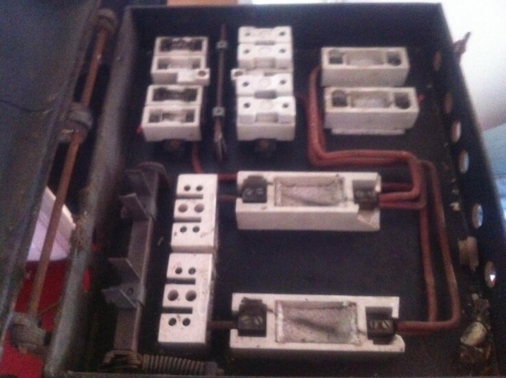

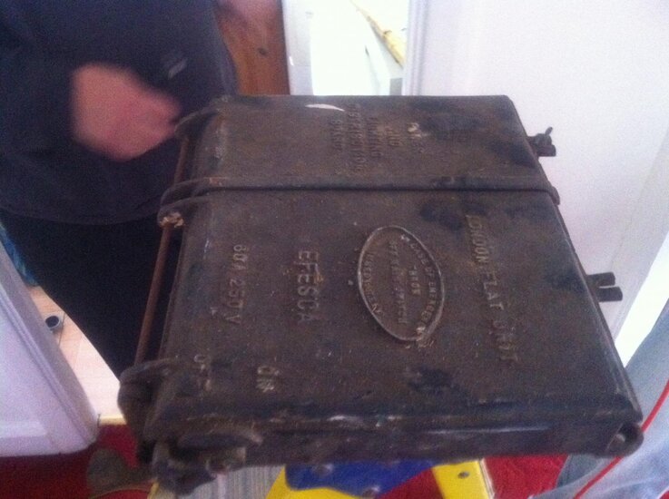

View attachment 16516View attachment 16517probably as old as this 80 year old board i removed from a flat last month. It looks similar.
What that still is use?
Yep was indeed. The imperial V.R.I feeding it was 7/.052 and was solid. As soon as i moved it all the insulation crumbled away. We ended up having to run a new 16mm 3 core back to the ground floor flat intake position which was a pig!! as well as causing a stink with the tenant living there.
