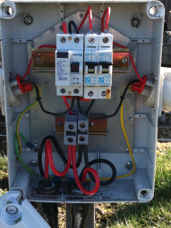

The hook-ups are 16A and appear to be connected to the SWA and no other earth.

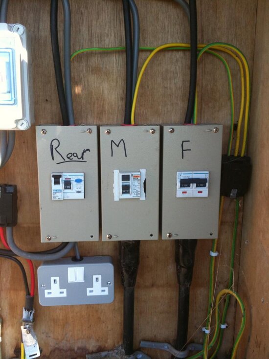

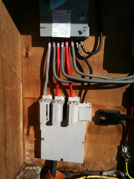

This is the cut out. Hopefully you can just see the 16 mm earth cable disappearing down the pipe (bottom left).
The other end connects into a Henley block arrangement and then feeds out to the 3 phases as per this photo.

oh please tel me you dont have to take the cover off to get at the MCB's if that the case all the enclosure will have to be replaces so you can get at the MCB's as having to remove the cover to reset the RCD or MCB is totally wrong and exposes the user to live parts it should look some thing like this

It's OK Nick.
The MCB's and RCD can be reset by lifting the usual weatherproof cover. You do not need to remove the whole front cover to get at them :)

Phew im assuming its like the one in the pic i posted , i got worried for a minuit lol i have come accross the MCB's RCD in an enclosed box
well thats one good thing
In the process of doing PIR's on a load of caravans on a big park. Half of the boxes do not have the flap to gain access to the RCD/MCB's and causes no end of teouble for the on-site spark.
WIth regards to the tripping on 5x, the earth will most likely be the problem. Is the site located close to the sea??? as salt in the atmosphere will speed up the corrosion of the metalwork. Pull back a couple of the SWA gland sleeves and check the SWA strands. COrrosion is apparant on the earth stud on the first picture posted. A simple Loop test will confirm the integrity and condition of the system, and yes the higher the reading, the less likely the RCD will trip at 5X....
Looking at that main DNO cut-out arrangement, are you sure the earthing system is PME?? I can see no N-E connection at the neutral cut-out position. I think this is a TT system, and a badly designed and installed one too!!
As Chris stated, many MFTs and RCD testers will not test when the 50 volt touch threshold has been exceeded, which means your TT system needs improving. At the very least each hook-up panel will need to be roded. And as this is, (as i suspect) a TT system, the SWA of the hook-up in-out supply cables can link those rods together...

Not having seen the pictures when I OP, but agree Engineer54 they does not look like a PME head, which leads onto the very worrying part of the Richy3333 post, as above, if the DNO don't know, on what looks like a newish installation, what they have supplied, it does not bode well.

Thanks Malcolm & Engineer54 for your comments. The DNO was adamant that it is a PME system, however I should be going past the site today so will pop back in as the pics I took do not cover the whole set up of the equipment. More pictures to follow :)
'Keeping very accurate details' around here just involves the DNO engineer confirming from memory. When I rang their engineering department, they had no idea they were supposed to be able to tell me the current earthing system and ringing the DNO helpline just left me banging my head against the wall - 'computa says nooo' ;)
The Supply may very well be from a DNO PME supply, but maybe the original installation electrician didn't want the available PME connection, just the neutral, probably because he knew that PME is not permissible for caravan supplies. So it is now, from that supply origin, a totally a TT based system...
A question, are those 100mA RCDs at the origin of each sub-main S-Type?? They don't look like it to me. In fact everyone of them is of a different manufacturer, which means at least 2 of these original RCDs have failed at sometime and have been replaced.
