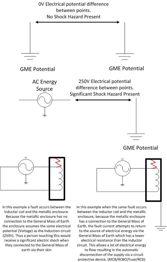

Please look at the following graphical examples of explaining the dangers and operation of electrical potential as a shock hazard to people.
Fig 6:
A person touching two different electrical services that are at the same electrical potential and, if AC, the same frequency and phase angle, will not receive an electrical shock
Fig 7:
However a person who is in contact with two sources of electrical energy that are at different frequencies or more importantly, two separate phase angles, will receive an electrical shock proportional to the electrical potential (Voltage) between the two sources of energy.
Fig 8:
Hopefully the above will allow you to be better acquainted with shock hazards caused by differences in Electrical potential and why the General Mass of Earth (Earth) is used for this purpose. In an AC supply system the Neutral conductor is, or should, be at the same electrical potential as the General Mass of Earth, it is also the point, by definition, at the source of the AC energy where the three phases of the supply are all at the same electrical potential (0V by definition but not reality).
