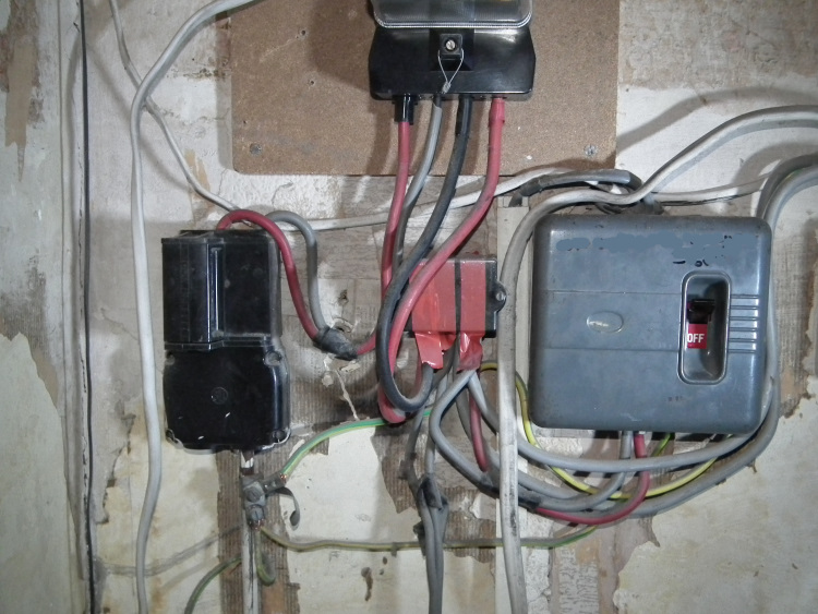

This communal hallway switch was 'repaired' by the landlord. It stayed stuck on for four years
This junction box ? caught fire

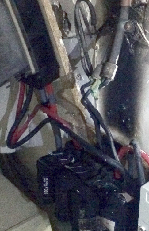

It looks like the output terminal in the 2nd cutout (company fuse) has overheated and scorched the meterboard, and perhaps through conducted heat melted the disc out of the seal on the end of the left hand mineral insulated cable, from which the compound has run out. If it is still connected, it should be rectified without delay, as it could continue overheating and live parts are probably accessible that cannot easily be isolated, and which pose a risk of arc flash injury. It appears to have been incorrectly installed in the first place. What has been done about it so far? If nothing, the building network operator or DNO needs to be called and as it is an emergency situation they will at least turn up to isolate it for safety.
In any case the air delay push switch for the hall light is not related to this incident. If the timing screw on those Columbus switches is wound right in, the button will never pop out and the light will stay on. This is not dangerous, and I have to say they could be a bit fiddly to get right if you wanted a long delay.
Thanks for your replies. That box served the communal hallway and the upstairs flat, it did catch fire but was quickly put out, The fire brigade suggested it was caused by a surge from upstairs however nothing was damaged upstairs and no one was in.
This the installation which is as you can see was quite old and has been replaced.
If the upstairs flats electrics were not damaged how could a surge cause this ?
The main fuse was 60amps on that upstairs installation.

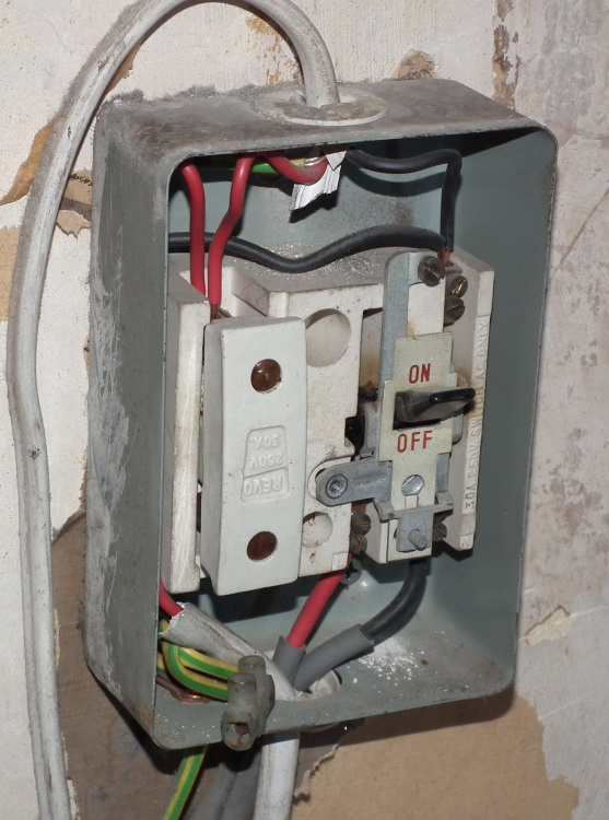

This second one did have a cover, that's the only picture I have of it, just how old was that ?
It's not so much a case of age, there are 100-year-old electrical components that are still safe; more a case of faulty installation. The MI cable gland should not have been left floating in mid-air (although it wouldn't be the first one that was) with no support and exposed basic insulation. I suspect the solid conductor was too small to be securely clamped in the cutout terminal. It's a known issue with MI cables, which have a very high current carrying capacity for a given size, and therefore sometimes require specific termination methods to make a sound connection in larger terminals of similar rating. I doubt any kind of 'surge' was involved, more likely a steady heating load that slowly overheated the bad connection.
The Mem splitter and Revo switchfuse in the grey pressed steel casings are typical 1960s. In themselves they are reliable and would survive another century. They normally get replaced when RCD protection is needed or requested either following an EICR or for additions.
